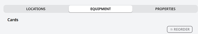

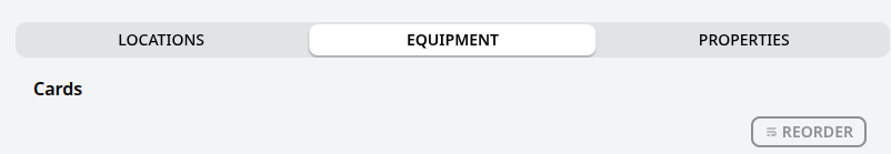

On the other hand, if you have an equipment group and there is one particular item that you think does represent the actual status of that physical entity better than the others, then there is a way for you to configure you semantic model pages to reflect this: When you are on your Overview page, click the pencil icon in the upper-right corner. Then select the equipment set of options:
Down near the bottom of the page, there is a series of options for the display of equipment in the model page. One of those:
allows you to arrange it so that one particular point of the equipment is displayed at the equipment itself.
Alternatively, you can build a custom widget that collects whatever information from the child items or beyond and combines those in any way you see fit and then use Default List Item Widget metadata for the equipment Group to make that what is displayed in the model instead of the standard accordion list item.

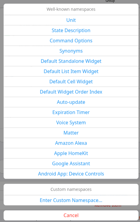

I just want to point out the opposite is also possible. You can exclude the individual Items and just put the Group Item with the aggregation function into the semantic model as a Point. I would use this approach, for example, to represent a single lamp with more than one smart bulb which I always want to work in unison.
That’s cool! I never knew one could do that. I knew you could identify an Item for the badge on the Locations tab but didn’t know about this. I’ll have to experiment some when I have some time.
