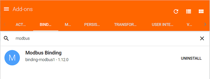

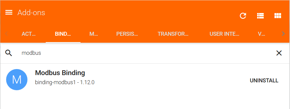

    I previous test Openhab at the older version, with Modbus binding and it works. but When I test it on the new version Openhab 2.3.0,and follows the instrcution of it. but it did not work.
    After I install the Modbus bingding with Pater UI, it seems the installed modbus version is 1.12.0. from other topics in the community, I get that the modbus version has update to a new verison. but why I could not install the new version directly on the PaperUI? and how Can it install the new version binding? could some one help me detailed, thanks very much.

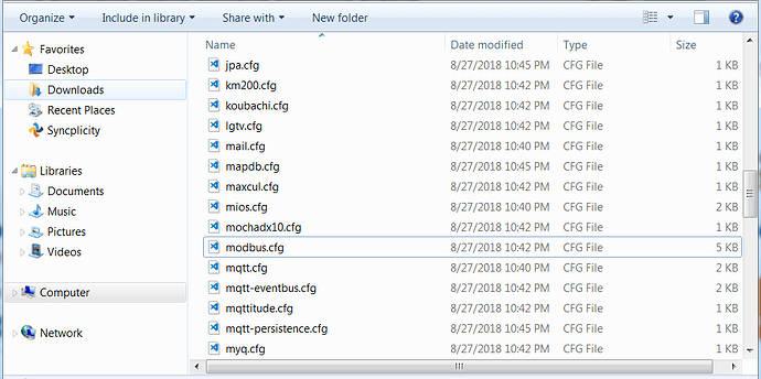

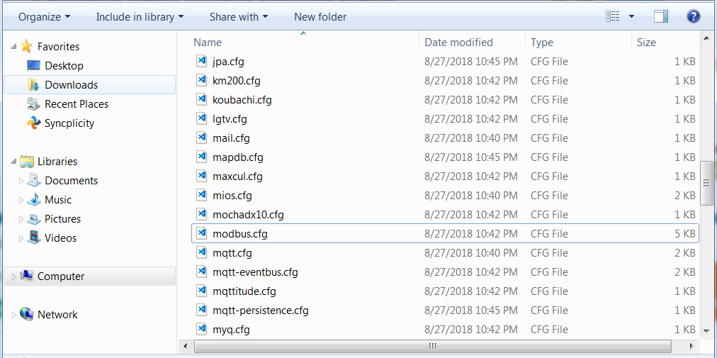

    And when I install the Modbus binding on the PaperUI , the “Service” folder appear most binding configuration files blow shows.
    I think if I install Modbus bindings, only appear “Modbus.cfg” is more reasonable.
    And the “modbus.cfg” is not need in the new version Modbus binding, right?
