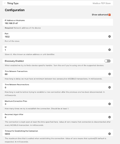

Another thing I see that I cant change Time Between Transactions. Even if I give in file this to 6000 milisec, than after puting it on raspberry in UI I see still 60 milisec.
here is my thing file:
Bridge modbus:tcp:SolarEdgeConverter [ host=“192.168.31.47”, port=1502, id=1, timeBetweenTransactionsMilli=6000, timeBetweenReconnectMillis=0, connectMaxTries=3, reconnectAfterMillis=0, connectTimeoutMillis=5000 ] {

And what I see in UI:
