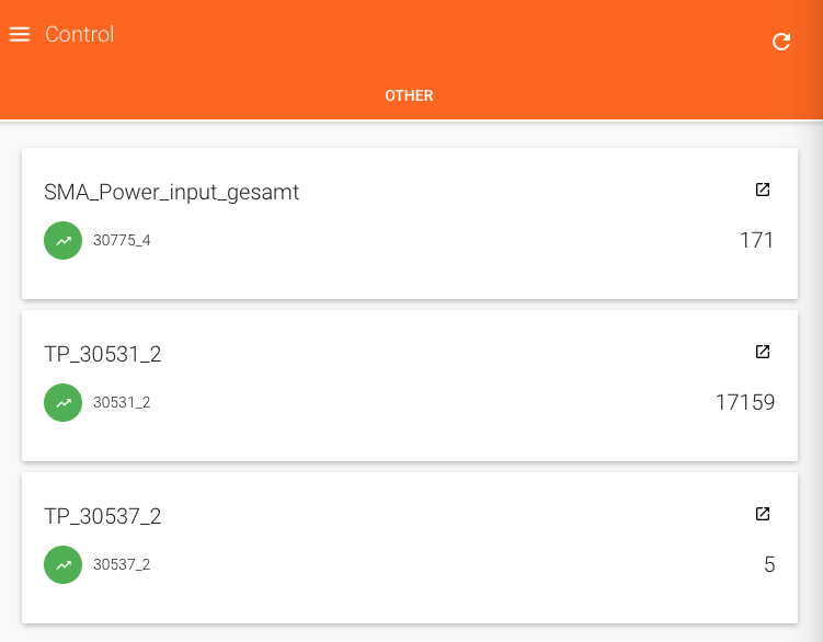

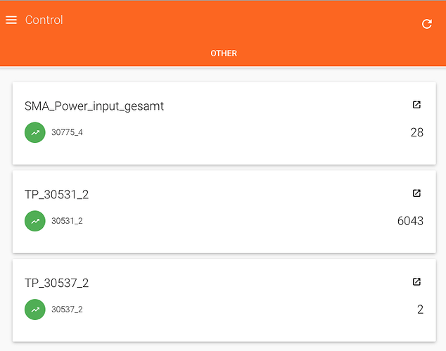

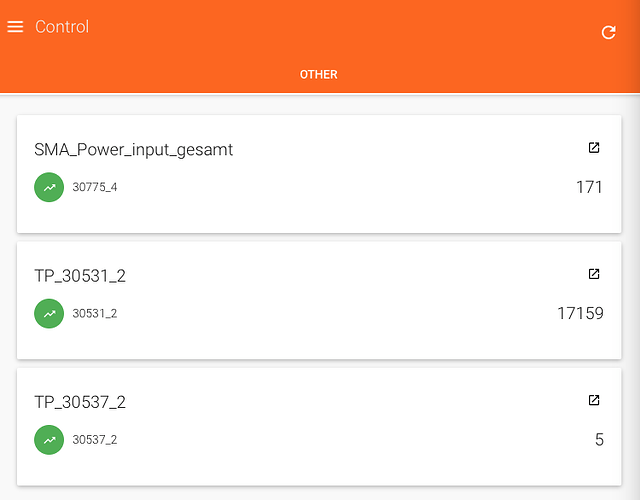

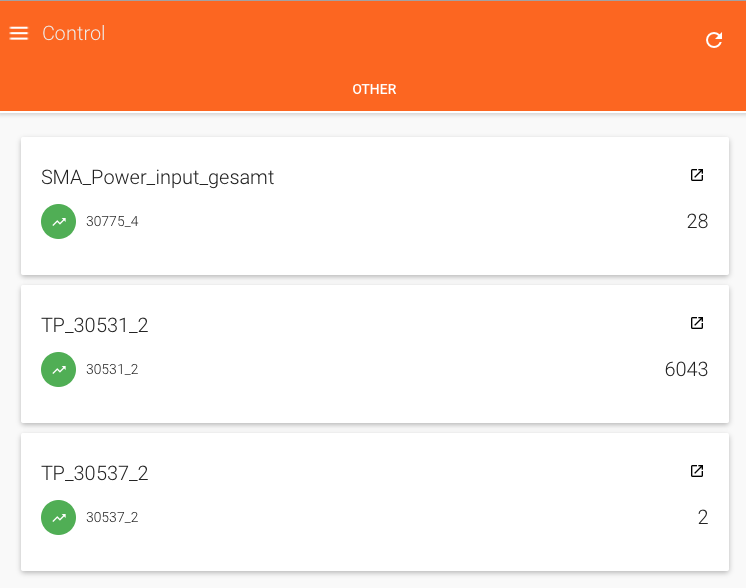

This is my current things file:
Bridge modbus:tcp:tripower [ host="192.168.100.48", port=502, id=3, timeBetweenTransactionsMillis=250, connectMaxTries=2] {
        Bridge poller input_30775_4 "SMA_Power_input_gesamt" [ start=30775, length=4, refresh=5000, type="input" ] {
                Thing data 30775_4 [ readStart="30775", readValueType="int32", readTransform="JS(minus2zero.js)" ]
        Bridge poller input_30529_72 "TP_Input_30529_72" [ start=30531, length=12, refresh=5000, type="input" ] {
                Thing data 30531_2 "TP_30531_2" [ readStart="30531", readValueType="uint32"]
                Thing data 30537_2 "TP_30537_2" [ readStart="30537", readValueType="uint32"]
The config from first post was already reworked
