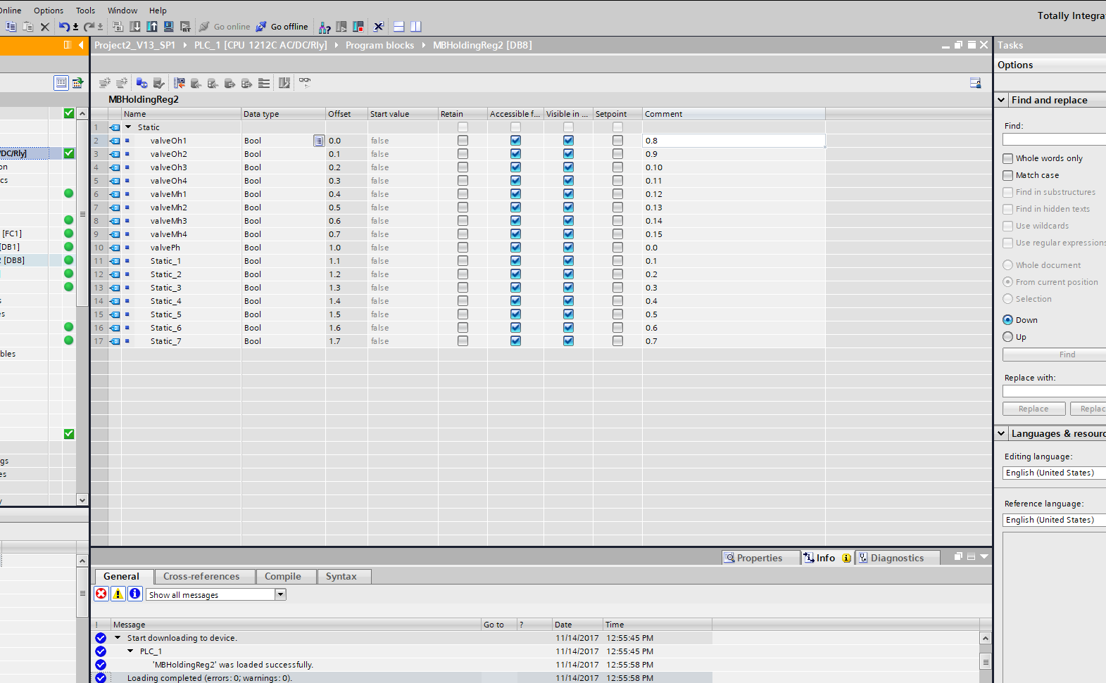

Yeah I have been reading docs and that’s where I got the idea to use holding register for status bits. Not on my computer now so cant’ show you the full example but something weird. I’f I create an array of booleans in s1200 and read them like your example says I can access only first two bits and they are with readStart=“0.8” and “0.9”. Could the encoding be somehow messed up?
Can you please share the holding register table from s1200 (screenshot from tia portal for example)?
You need to calculate yourself registers contain the boolean data..
Best,
Sami
I’ll take a screenshot for you. I don’t know if this is what you are meaning but I used modbus client to poll one register and started flipping bits on and off to see how they are arranged but i got so confused that I had to stop :smiley:
Hahaa! I got it!
In the picture below you can see the holding register table you requested and corresponding bit addresses in the comment section used by .things file to access the right bits.
Here’s also my current .things file section what is used to read these bits:
Bridge modbus:tcp:endpointTCP2 [ host="192.168.1.100", port=503, id=3, connectMaxTries=3 ] {
    Bridge poller valves [ start=0, length=1, refresh=2000, type="holding" ] {
        Thing data valveOh1 [ readStart="0.8", readValueType="bit" ]
        Thing data valveOh2 [ readStart="0.9", readValueType="bit" ]
        Thing data valveOh3 [ readStart="0.10", readValueType="bit" ]
        Thing data valveOh4 [ readStart="0.11", readValueType="bit" ]
        Thing data valveMh1 [ readStart="0.12", readValueType="bit" ]
        Thing data valveMh2 [ readStart="0.13", readValueType="bit" ]
        Thing data valveMh3 [ readStart="0.14", readValueType="bit" ]
        Thing data valveMh4 [ readStart="0.15", readValueType="bit" ]
        Thing data valvePh  [ readStart="0.0", readValueType="bit" ]

Bridge modbus:tcp:endpointTCP [ host="192.168.1.100", port=502, id=2, connectMaxTries=3, timeBetweenTransactionsMillis=100 ] {
    Bridge poller greenlineCoil [ start=3, length=4, refresh=5000, type="coil" ] {
        Thing data d04 [ readStart="3", writeStart="3",  readValueType="bit", writeType="coil" ]
        Thing data d05 [ readStart="4", writeStart="4",  readValueType="bit", writeType="coil" ]
        Thing data d06 [ readStart="5", writeStart="5",  readValueType="bit", writeType="coil" ]
        Thing data d07 [ readStart="6", writeStart="6",  readValueType="bit", writeType="coil" ]
 	Bridge poller holding [ start=0, length=14, refresh=5000, type="holding" ] {
        Thing data mh4 [ readStart="0", readValueType="uint16", readTransform="JS(divide.js)" ]
        Thing data ph [ readStart="2", readValueType="uint16", readTransform="JS(divide.js)" ]
        Thing data phrh [ readStart="3", readValueType="uint16", readTransform="JS(divide.js)" ]
        Thing data mh1 [ readStart="4", readValueType="uint16", readTransform="JS(divide.js)" ]
        Thing data mh2 [ readStart="6", readValueType="uint16", readTransform="JS(divide.js)" ]
        Thing data mh3 [ readStart="8", readValueType="uint16", readTransform="JS(divide.js)" ]
        Thing data oh [ readStart="10", readValueType="uint16", readTransform="JS(divide.js)" ]
        Thing data tekn [ readStart="12", readValueType="uint16", readTransform="JS(divide.js)" ]
        Thing data teknrh [ readStart="13", readValueType="uint16", readTransform="JS(divide.js)" ]
Thanks for the logs and configs. Will look into those
Adding these data things as switch items and adding them to sitemap doesn’t seem to work. Whole sitemap stops working.
What kind of items and sitemap you have configured? It should work :slight_smile:

Actually, I cannot reproduce the issue with my S71200 PLC. Could you please ensure you have latest version and try again?
I’ll do those checks in the evening. Can you provide the latest version number so I can verify?
