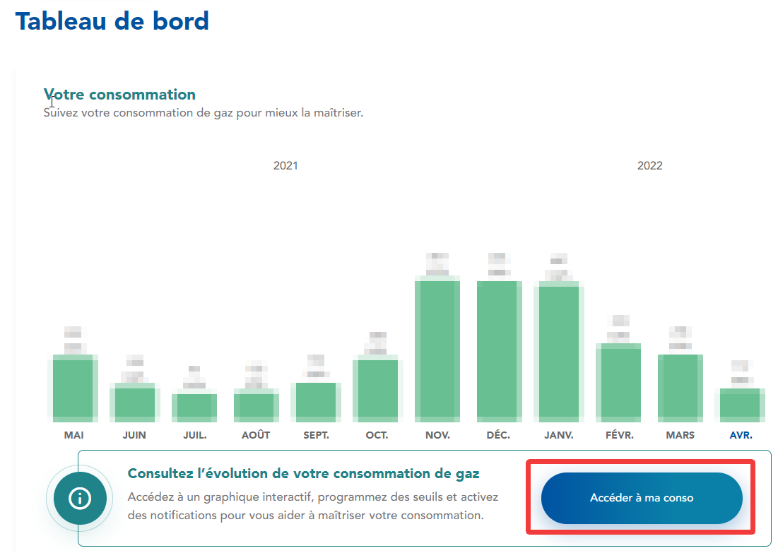

This is a quick tutorial for my French compatriots on how you can monitor your natural gas consumption in openHAB - probably appropriate that you would want to do that given the, em, current situation in the world, as some would say, and the resulting price hike - if you have their new “smart” Gazpar meter installed (not that you have a choice anyway, it will happen). I’ve actually used this setup for almost a year.
The main assumption is that you already have your account at GRDF and can see the info on their website i.e. https://monespace.grdf.fr/. If not, follow their registration process and make sure you do.

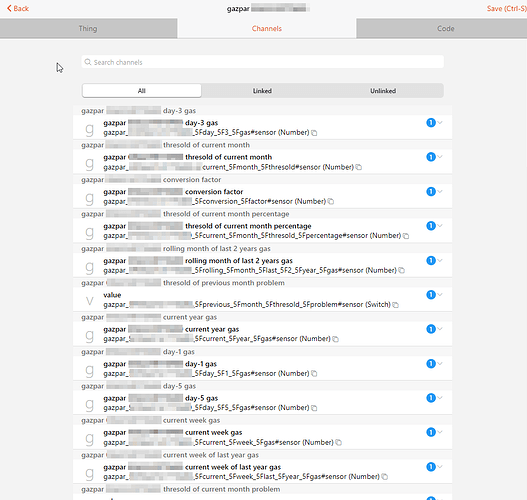

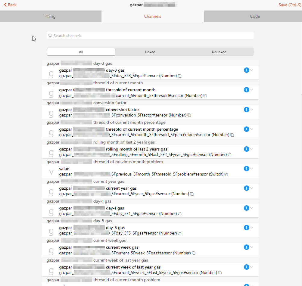

Note that I’ve used the Home Assistant discovery option (--hass_discovery=True) because then it will be normally detected by the MQTT binding and added without requiring to define the channels and such (there are a bunch of them) :
You can then add it to your model with the “Add Equipment to Model” button on that screen, be sure to keep the item names’ suffixes untouched (important for what comes next).

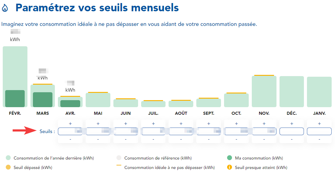

Note the “thresholds” (seuils) are defined on their website:
