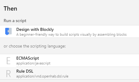

I am still have some old rules in dsl format in .rules files and slowly trying to alter them to the new blockly. but this one is an old one that i have found before years in the forum and i am wonder can someone make it for me as my Knowledges are limited for so difficult rule.
