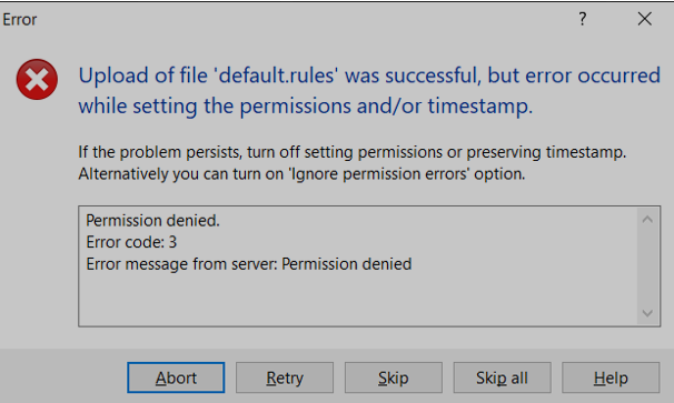

When transferring files to OH3->2 now, WinSCP gives me the error:
The file transfers OK, but on the OH side the Timestamp is altered to time of arrival in OH, which generates confusion.
I have no clue why and how to fix it (~zero unix knowledge).

WinSCP has worked for years with OH2. Moving to OH3->2 led to issue!
WinSCP has not changed, so has OH3>2 permission strategy changed ?

What are the settings that you use to copy the files ?
There should be a log of the winscp session. Would you mind to share the details of that logging file ?

Here is the log of WinSCP startup, copy 1 file to OH and Shutdown. 29220501-WinSCP-Copy-1-File.log (12.0 KB)
Can you make any sense of it?

Timestamp of the file cannot be preserved because files are copied as user openhabian while the file in the target directory is being owned by user openhab.
Timestamp can be preserved either by copying the file as user openhab or by changing the owner in the target directory to user openhabian ( the later could cause other issues with regard to permissions ).
Hi Wolfgang and thanks a million.
This is a bit strange because putty shows the following user at startup: Using username “openhabian”., which works.
So where does user openhab come from that WinSCP sees? Is it a OH3 replacement for openhabian, or are there more than 1 users for an OH3>OH2 instance with my old OH2 Backup restored on top, also with openhabian - for now?
