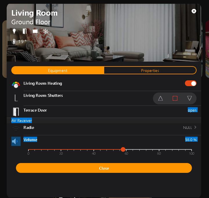

Is there a way to move these properties, like energy stats etc and only have the switches/dimmers in the main page as per this screenshot? This is under ‘Locations’, you select a location and it brings up all switches, dimmers, properties etc.

In this screenshot though, it has a properties tab which is what im looking for - how can I create those tabs to then display info like energy into this tab only?
