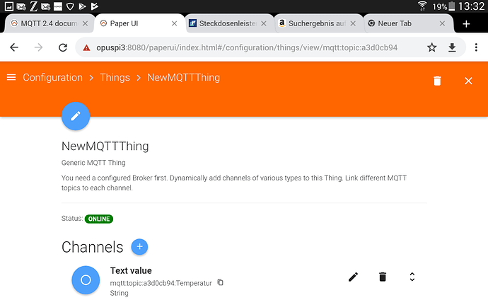

PS: Looking at the official things documentation there is no mention of the bridge{ thing{ channels }} syntax. Only the “typical” way to do it and then a link to go look at each of the individual bindings.
When creating a thing via file (Option 1)
And when creating it via PaperUI (also connecting to the broker “opusMQTT”):
Note that in the second example the brokername is not part of the channel-syntax.

Thanks for the screenshots! I’m headed out to work but I’ll probably fiddle with the paper UI tonight. Nothing else interesting to do in a hotel room…
Ok I can understand the fear of using Paper UI when reading this: https://www.openhab.org/docs/configuration/things.html#defining-things-using-files
