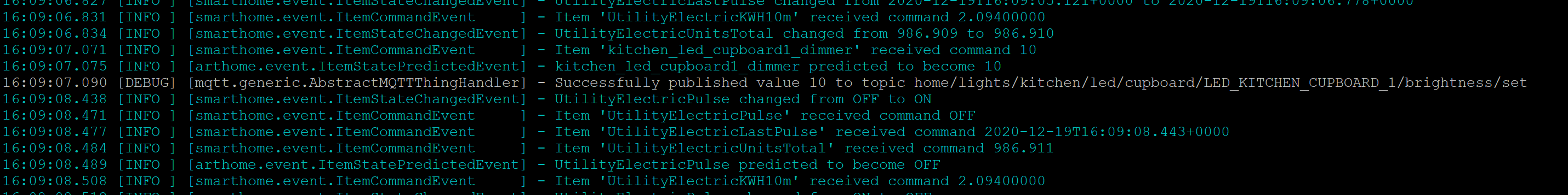

First I force the message in mqtt to 0:
I set the item to 10

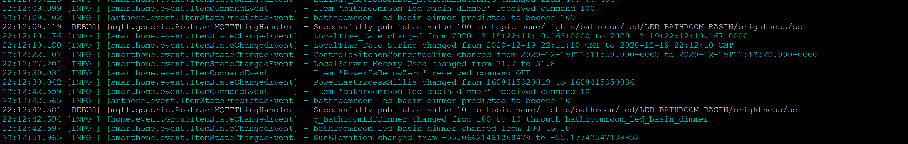

log:tail:
events.log
2020-12-19 16:09:06.831 [ome.event.ItemCommandEvent] - Item 'UtilityElectricKWH10m' received command 2.09400000
2020-12-19 16:09:06.834 [vent.ItemStateChangedEvent] - UtilityElectricUnitsTotal changed from 986.909 to 986.910
2020-12-19 16:09:07.071 [ome.event.ItemCommandEvent] - Item 'kitchen_led_cupboard1_dimmer' received command 10
2020-12-19 16:09:07.075 [nt.ItemStatePredictedEvent] - kitchen_led_cupboard1_dimmer predicted to become 10
2020-12-19 16:09:08.438 [vent.ItemStateChangedEvent] - UtilityElectricPulse changed from OFF to ON
2020-12-19 16:09:08.471 [ome.event.ItemCommandEvent] - Item 'UtilityElectricPulse' received command OFF

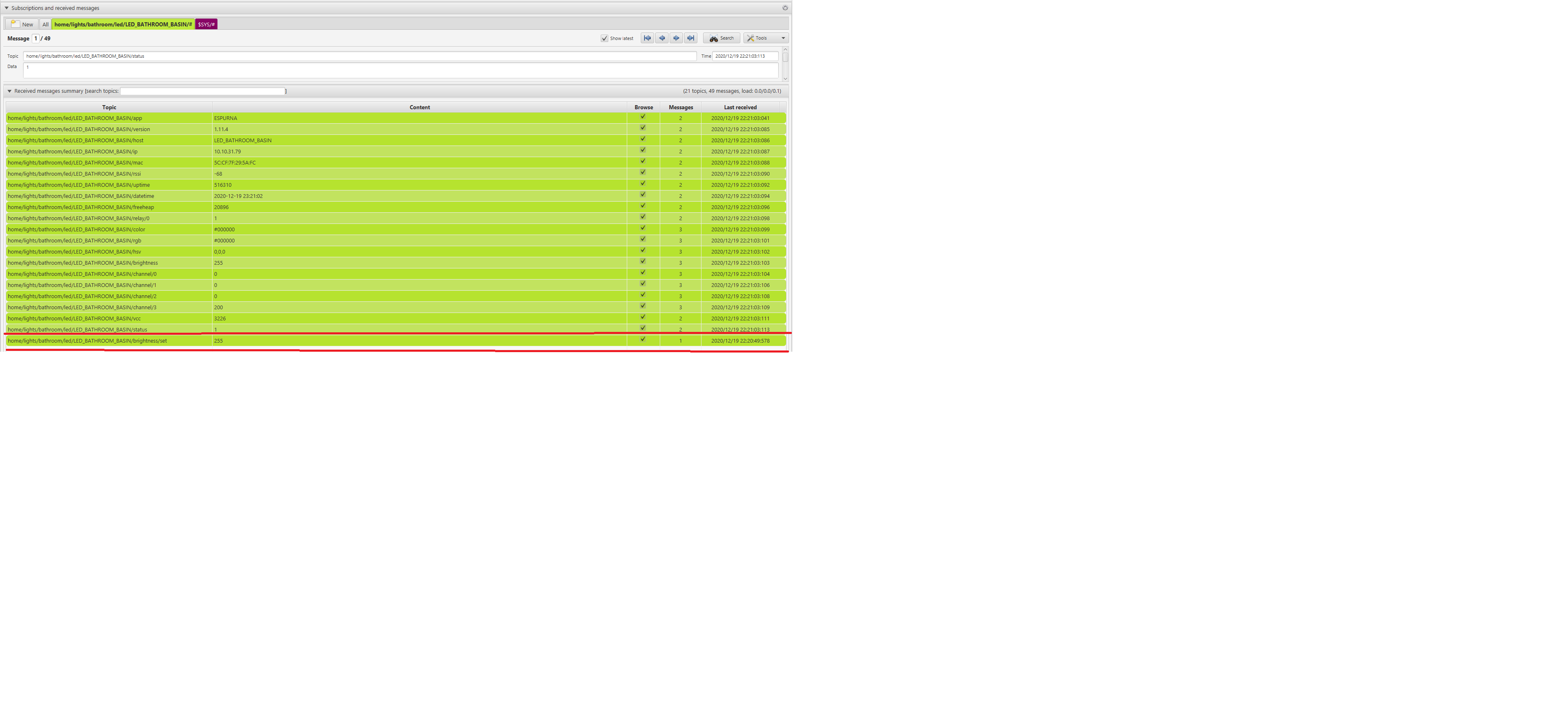

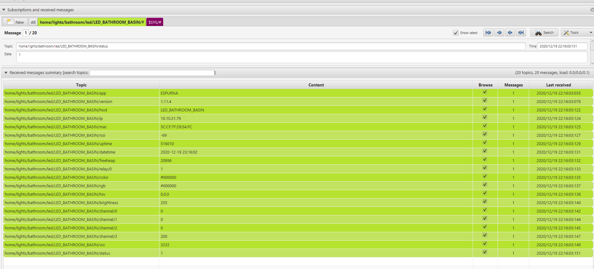

Now having a look at mqttspy, the message is still

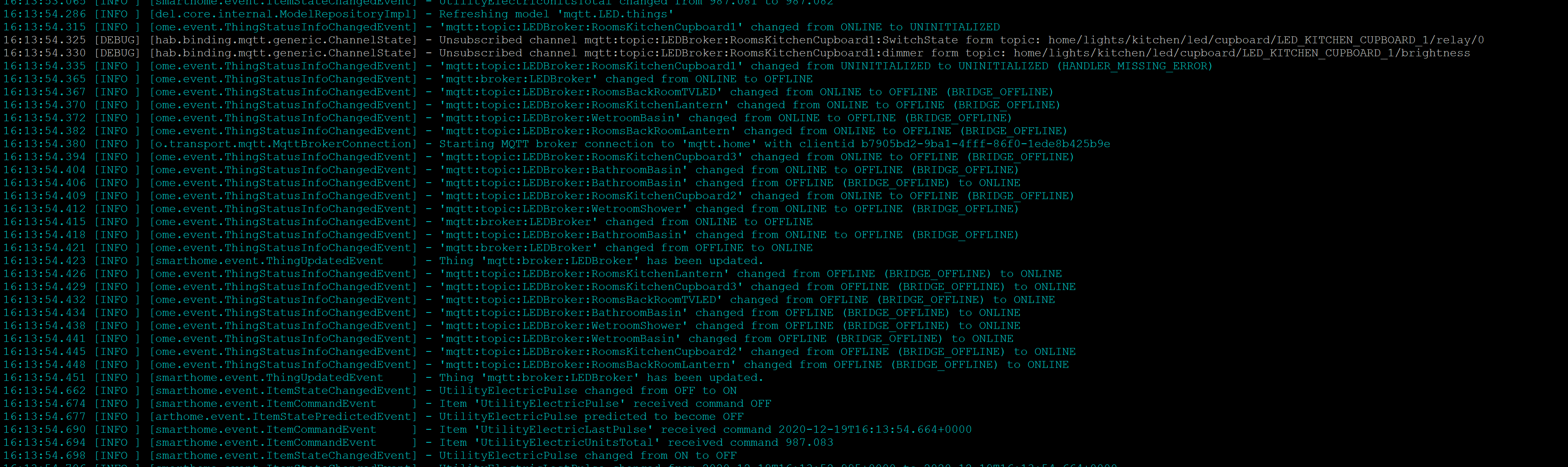

To solve all this, I can comment out the thing watch it unsubscribe, put it back in, and watch it subscribe, and it works. At some random point over the day/week, this will break.

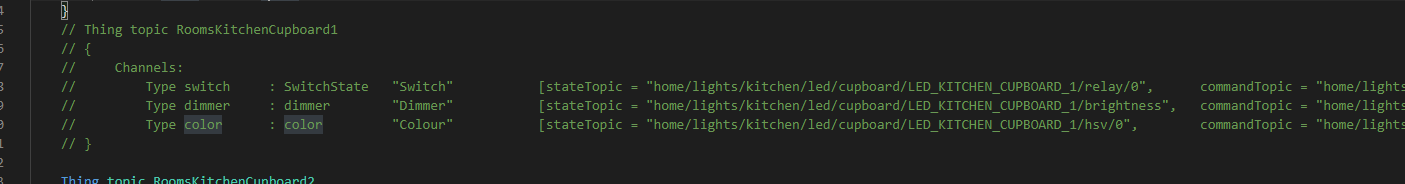

Commented out:
Now removed.
Put it back and save:

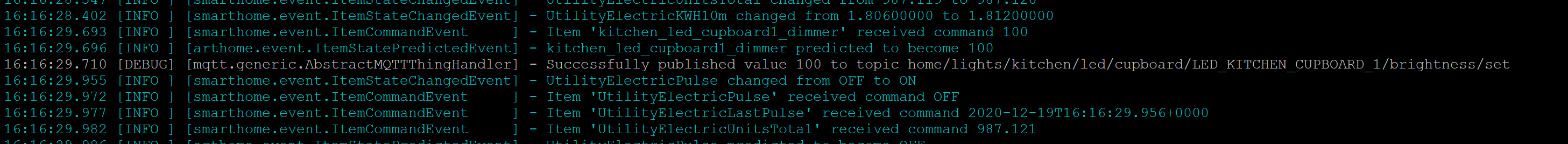

Update the item:
Message:
Now mqttspy shows the value (note that 0-100 is scaled 0-255)
This happens across all the different items. Sometimes it’s ok for a while, sometimes it breaks quickly. It does not affect all items in the same broker (I have 10 brokers with over a hundred items)

no messages received by mqttspy
Nothing there on that topic.

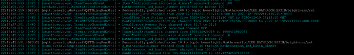

And after I comment it out and put it back again - it works:
So a patter is/could be:
Add things, they work. Add a new thing, it works but others that were added may/may-not work.
Refresh the not-working, and that now works.
