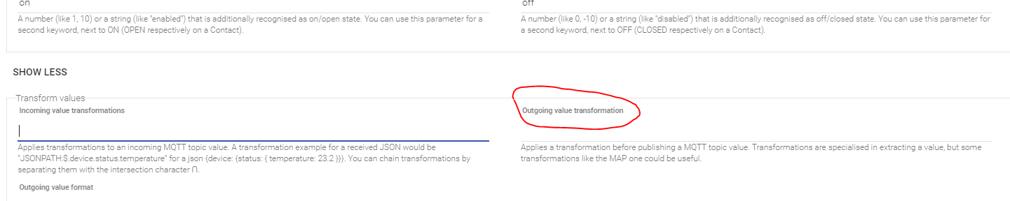

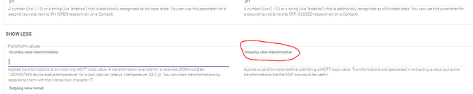

So if my build came out after 2.5 M1, should my build have the MQTT outgoing transformation functionality included (I wouldn’t have to downgrade then)? I tried and it didn’t seem to work. Might have done something wrong though…
Thank you very much for your answer, outgoing transformation is clear but still i’m getting mad with this rollershutter items!

Now i am running openHAB 2.5.0 Build #1549 and i want to replicate the same command.
I have no problem to run it as a dimmer using another mqtt payload, but still i would like to use a rollershutter item.
I inclued transformationPatternOut and here is my thing file:
MAP file is same as previous
