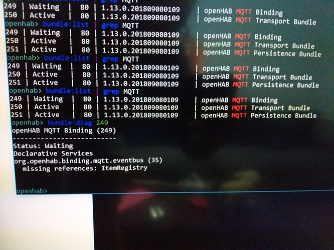

  • Issue of the topic: After setting up Mqtt bundle. It shows as “Waiting” and doesnt work although i have all my settings copied from previous installation!
    I check bundle:diag command in console and it shows:
