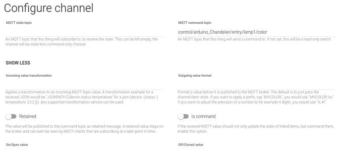

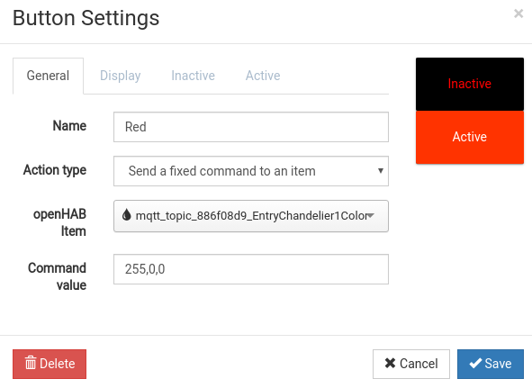

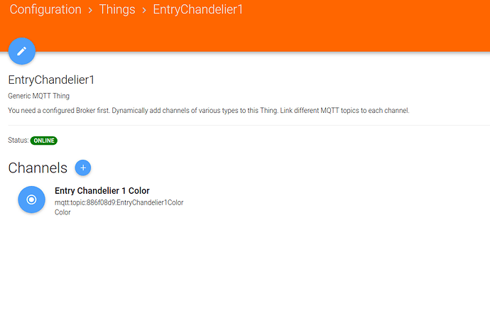

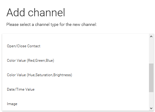

I’m not sure I understand your point, but the color type I added was Color Value (Red,Green,Blue). That is the kind of message my chandelier expects to see: RGB decimal values comma separated.
There are conversions going on here. openHAB knows HSB and only HSB. 255,0,0 HSB is black. So your HABPanel is setting the color to 255,0,0 HSB. The MQTT binding receives that HSB value and converts it to R,B,G because of the Channel type you chose. Black for R,B,G is 0,0,0 and that is what get’s published.
If you want red you need to use 0,100,100 for the command value which is the HSB equivalent to RBG 255,0,0.

That should be in the documentation somewhere. Maybe it is and I just missed it, but with my Thing being RGB type in Paper UI, I assumed that it was speaking RGB, not translating from HSB.
I do use Color Picker already, but I find it’s impossible to get pure red (or any color) by clicking around in there so I like to have the buttons for when I just want the red LEDs on.
