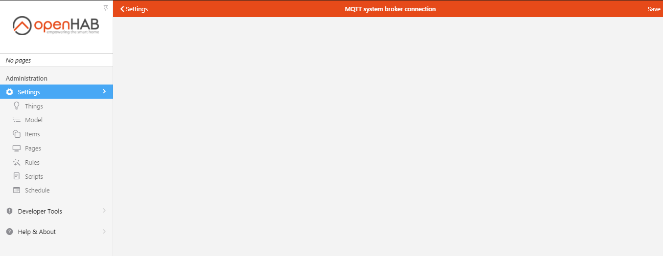

I’m coming from OH2.5 where I used the 1.x MQTT binding with an external Mosquitto broker.
After a lot of research I found that you need to create a bridge Broker and a Generic MQTT thing and then add channels for each topic. A bit complex to setup, but it works.
Now somehow I also have a “ **MQTT system broker connection** ” at the Settings page.
What does this MQTT system broker do, and do I need to configure it?
It keeps complaining about the host/IP not being setup, but looks like I don’t need this? How can I can rid of this entry?
`2020-12-22 12:04:14.458 [WARN] [.MqttBrokerConnectionServiceInstance] - MqttBroker connection configuration faulty: host : You need to provide a hostname/IP!`

> [@jwveldhuis](#):
I _think_ that’s a way to set up a “default” MQTT broker connection. You don’t need to do anything there if you create Broker Things. But I’m not really sure. I haven’t messed with it.
Have you edited or even just clicked “save” from that menu? You do need the host/IP to have a valid MQTT connection to a broker. If you’ve clicked save, perhaps it generated an empty config and that’s what it is complaining about. You can see if you have a $OH\_USERDATA/config/org/openhab/mqtt.config file. If so try stopping OH and deleting it.

See post nov 29.
> [@openHAB 3.0 Milestone 2 discussion](https://community.openhab.org/t/openhab-3-0-milestone-2-discussion/107564/240):
> In OpenHab 3 settings do you see “MQTT Broker connection”? If so, click the link. The info on this page was blocking port 1883 so Mosquitto didn’t connect. I removed all the info on this page and saved the page. Restart Openhab and Mosquitto, as port 1883 was not blocked anymore, Mosquitto could connect. Perhaps a reboot is needed.
Edit: after that, the error message in you log should be gone. Zet hem op 🙂

Thanks, it lead me to the solution.
In my case it was the file `mqttbroker.config` in that `$OH_USERDATA/config/org/openhab/ ` dir (created over a year ago) that was causing the error to show. Deleted it and all is fine now.
@Qwerty_Zet I tried your solution too, in my case it didn’t solve it. Toch bedankt!
