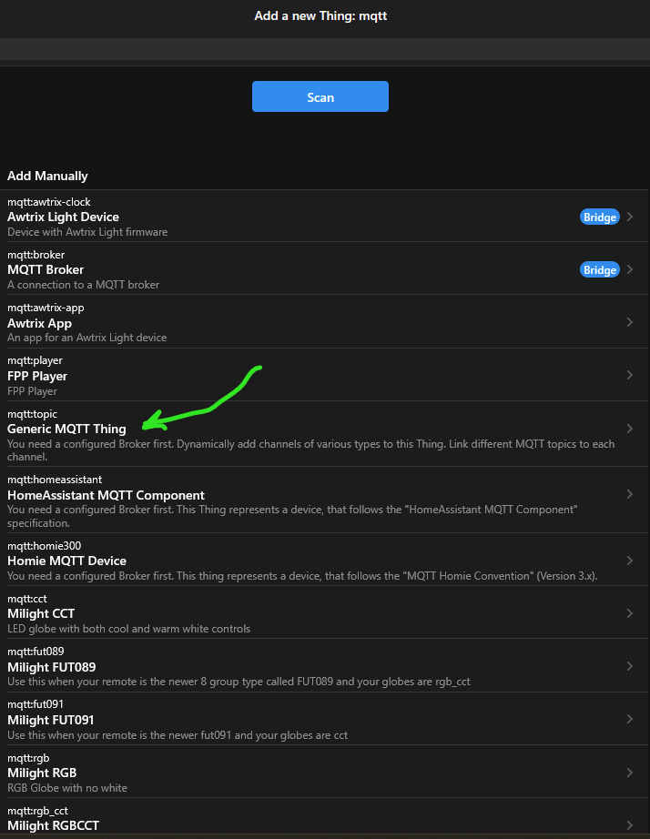

Hey Andrew,
Navigate to Administration > Settings > Things, then click the + button at the bottom right. Select MQTT binding in the list. You should now see a list of possible MQTT things, and in there you should see the generic MQTT thing, like this:
Do you see that?

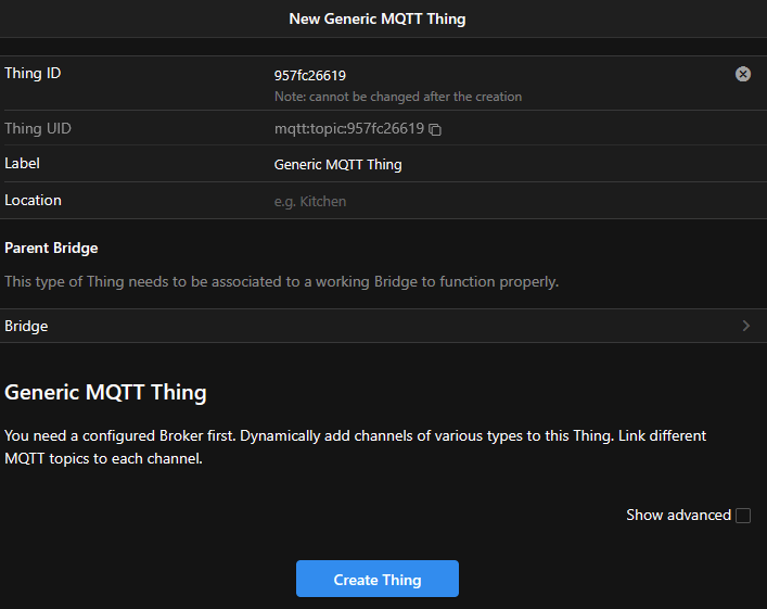

In the next step you need to name it, select the MQTT bridge you have already defined, and then you have the Create Thing at the bottom.
