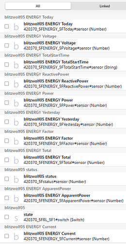

On my Blitzwolf powersocket (flashed with Tasmota) I enabled the homeassistant option (Setoption19). The device is immediately recognized and appears in my inbox. I add it as a Thing. I select an equipement (room) in the Model window and choose Create Equipment from a Thing. In the next window I see all my available channels:

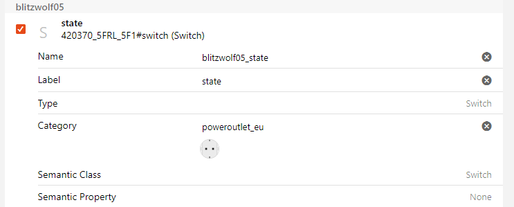

I can now change the state of the power socket via openHAB, but when I change it on the device itselves (hardware button of webgui), the state doesn’t change in openHAB. I can’t find any option to add a ‘MQTT State Topic’ when using the HomeAssistant MQTT Component
