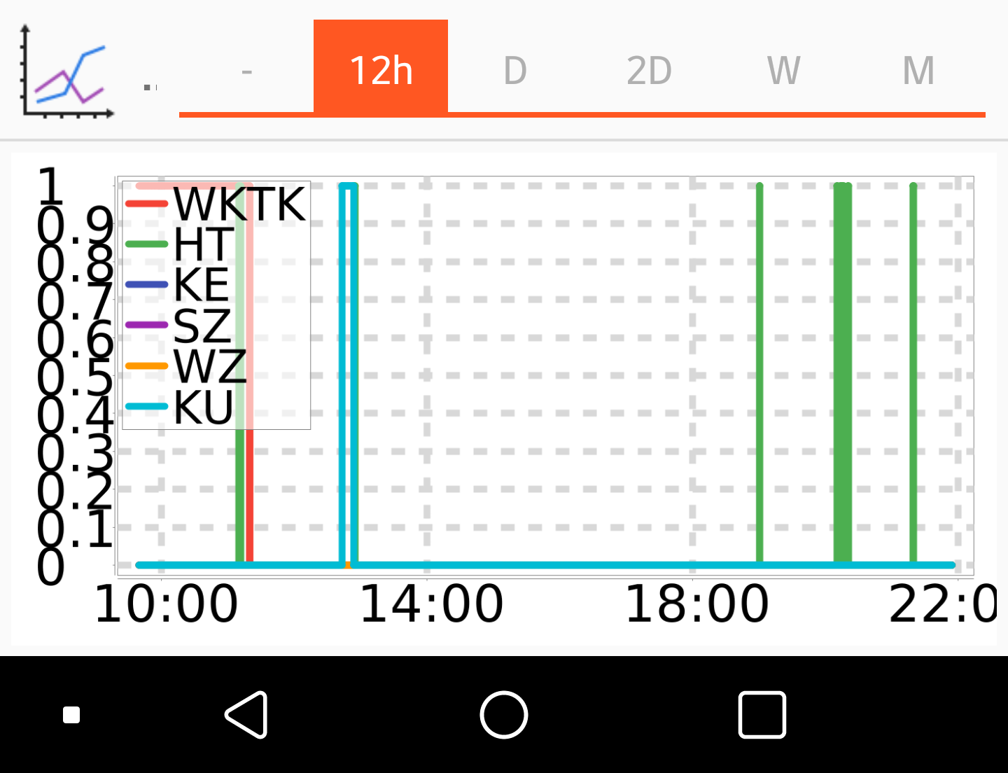

Off course this is not habpanel but the Android app/basicui, but you get the idea. This is just standard persistence and graph, no rules or other magic involved.
