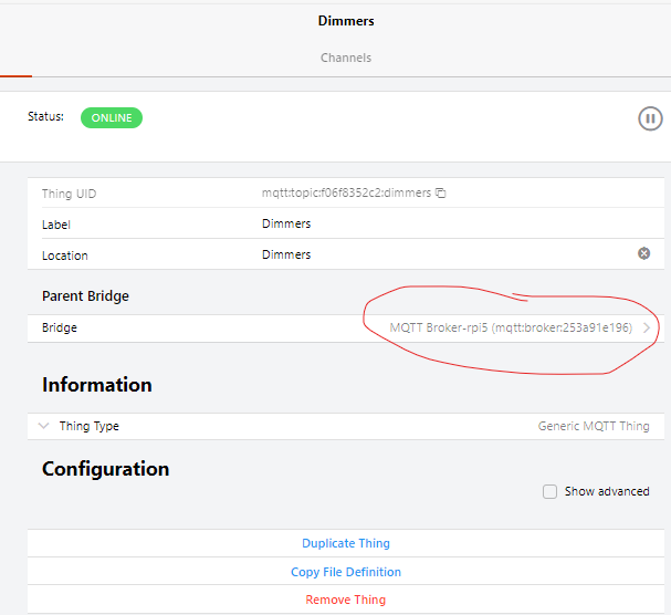

  1. (Outside of OH) Do you have a MQTT broker on a server (not part of OH)? Can you reach it with Mqtt Explorer (very helpful, but not required)? Are you getting data from device? Do you know if it conforms to some standard like HA?
  2. (Inside of OH) Did you install the MQTT binding in Openhab? Did you create a generic MQTT thing that references the MQTT broker in OH? Or did you Scan (UI Thing page, plus sign in lower corner, choose MQTT binding and Scan?

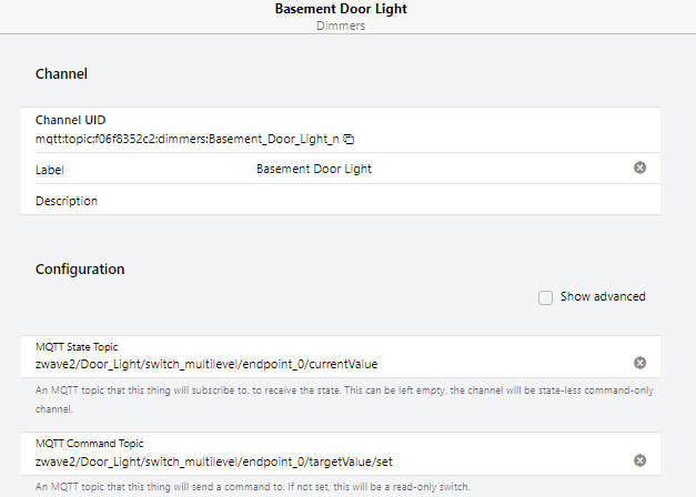

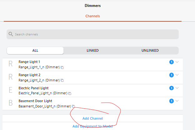

  3. If generic Thing copy the state channel from MQTT explorer and link to an OH item. Can’t help more without more information.
  4. Pictures; Thing
Channel
Configure Channel
The link to item. Is log message still there?

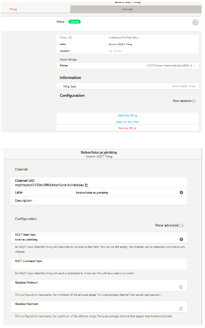

this is part of the log: Every minute I get an update from MQTT broker:
I expect the connections is stetup correctly, the two values are registered and send to OH.
Broker: Running within a container on QNAP NAS. Image: IOBROKER
I’ll check your printscreens above.
Regards
Christian
Just additionally: My printscreen looks the same (as I can see):
My thing and channel:
I think OH doesn’t know what to do with the data.
Regards and thanks for help
Christian
So far looks okay to me except state topic has dot instead of slash. I usually just copy the state from MQTT explorer to make sure
Also the message usually contains a value that is unpacked with JSON path (You need to have that installed -It is under Transforms)
      Basement_Door_Light_n:
        type: dimmer
        label: Basement Door Light
          stateTopic: zwave2/Door_Light/switch_multilevel/endpoint_0/currentValue
          commandTopic: zwave2/Door_Light/switch_multilevel/endpoint_0/targetValue/set
          transformationPattern:
            - JSONPATH:$.value
