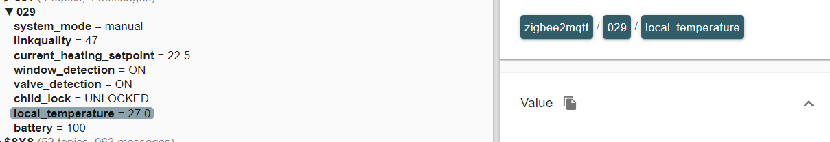

What I would suggest is to install MQTT Explorer and watch what happens when you physically press buttons or change temperature - you’ll see relevant topics flash when they’re changed, and you can read the messages that come with those topics.
OK - thanks
I am using MQTT Explorer and there i works fine (at least reading data):
  • it is the writng of the code in the thingsfile that is my problem.
    /Torben
For this particular example, something like the following might work:

I can not find the difference between the first code i made myself and what you have send me here, but makeking a thingsfile out of your lines, just made it work - thanks again for giving it a chance.
Afterwards i also got the command-topic running, so now i have control over the termostat.
