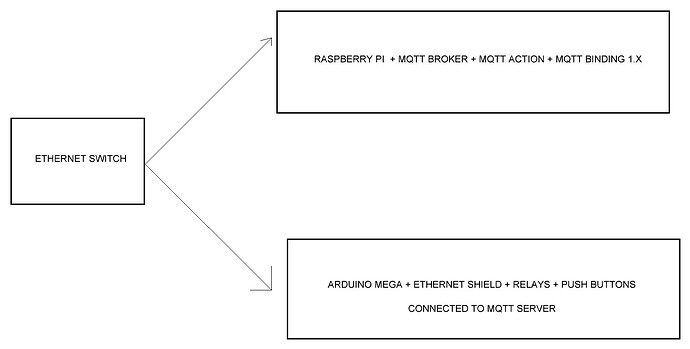

My test bench
It’s the least reliable. The most reliable would be to use the retained feature built into MQTT. This is how oil rigs and industrial control systems use MQTT. Do you really think they would use it for this if it were not reliable?
