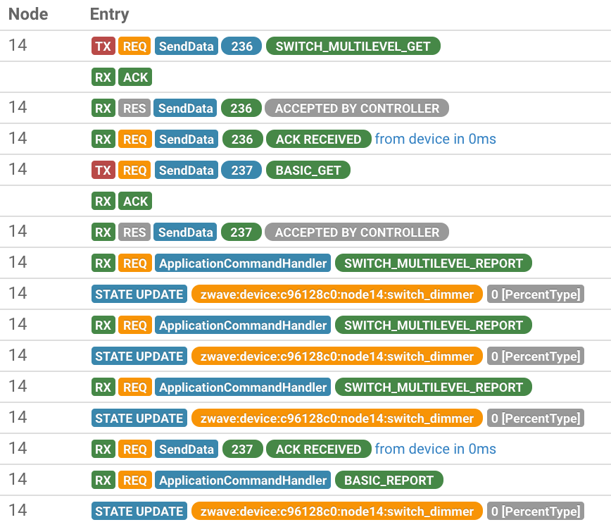

And here is the corresponding OH activity showing the attempts,
Looks ok to me from the binding perspective - it’s only sent one message (well, two, but for different reasons) and it’s received multiple responses from the device.
Oh, so it’s an issue with the device sending back the four responses to a single status request?
Since these are Cooper devices that have the hail class would it be fine if I went to 1 poll per day on them? Or even better, is there any way of adding in a do not poll option? Or am I wasting our time worrying about this?
Yes - this might just be the network, or maybe the device. It’s not completely uncommon, and can happen more often if the device is not having the best comms with the controller since it can miss the acks… Or, it might be something else, but it’s coming from the device in any case…
Probably it’s ok.
I’ve not provided this option as I believe that it’s important to periodically poll - otherwise you can’t tell if a device has just not been used, or it’s died if it stops sending data.
IMHO - yes . I would ignore it unless it’s causing you a bit problem. If we thought it was the binding, then I would want to know why. Since it looks from this log at least that it’s the device, I would ignore this.
Thanks. That may make sense since the devices with the most duplicates are furthest from the controller and one of my in between nodes close to them seems to have failed.
