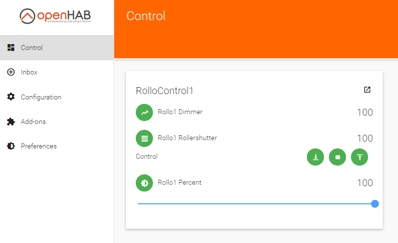

Hi. I have a problem with the new mqtt version. Unfortunately, I just don’t know exactly the version because I’m not at home but it’s a fresh installation. I’m trying to set up a Rollershutter thing. The problem is, for up/stop/down the payload is 0/0/100… How can I change the payload? I need shutter1up/shutter1stop/shutter1down. The thing can not distinguish between 0 and 0 for up and stop. :wink:
Greetz Hendrik

First I tried OH V2.4.0. Now I’m on 2.5.0m6. What do you mean with thing and definition? I don’t have any rules or sitemaps yet. I created the things with the paper ui. That worked but unfortunately it sends only 0/0/100 instead of up/stop/down.

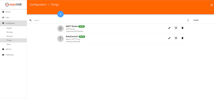

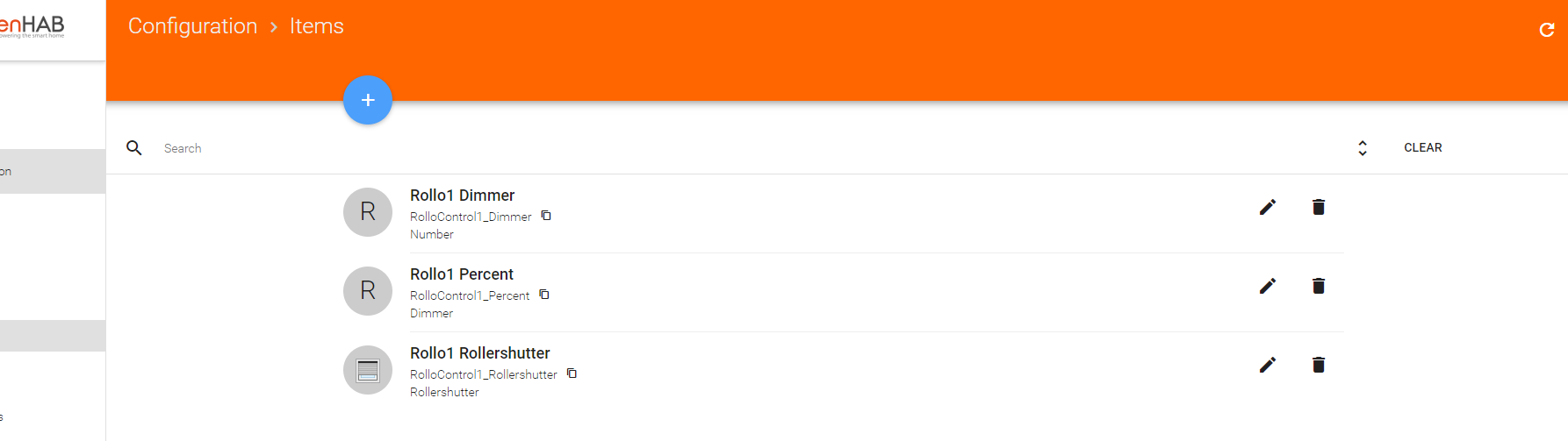

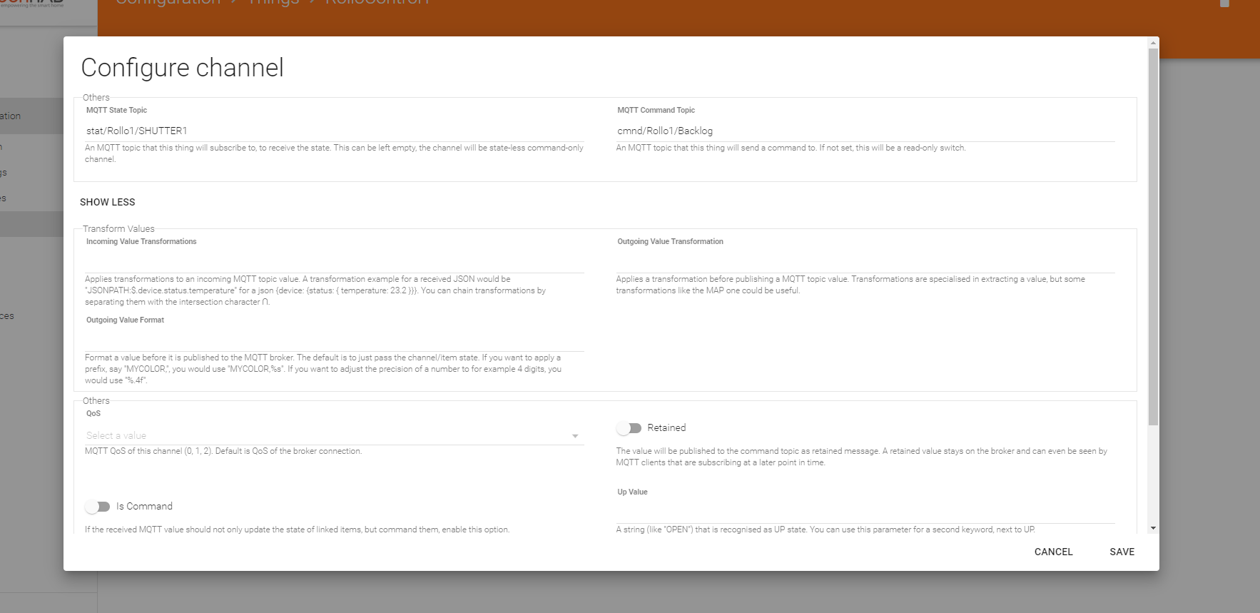

These are my settings
Sorry I’m not allowed to send more than 1 picture
Create a .map file that maps the numbers to the String you want to send and apply it to the outgoing transformation.
