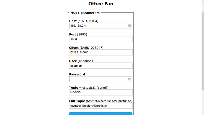

As I said earlier my configuration is not ‘Normal’ so you will need to translate some of the names and syntax structure order to get the same results. In order to assist wit that translation I have included my settings. It is best IMO you translate and do not try and emulate them.

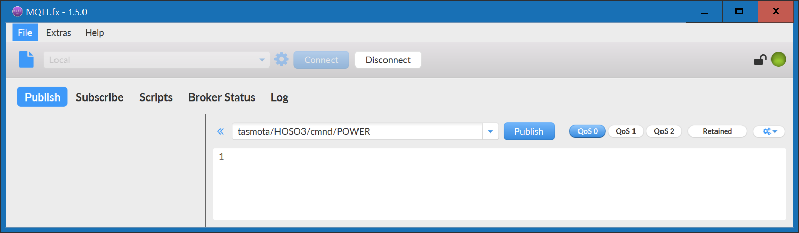

While playing just now with MQTT.fx publish I noticed that sending the wrong message to the sonoff resulted in it being ineffective although it looks correct.
Take a look at the publish command with the message sent as a 1 (one). This command works to switch on my sonoff.
Changing the message to be a 0 (zero) will switch off the sonoff, if I send a message of ON or OFF although the message looks correct it is not actioned by the sonoff. I have no explanation, just thought I would pass it along in case it sends you down a wrong track.

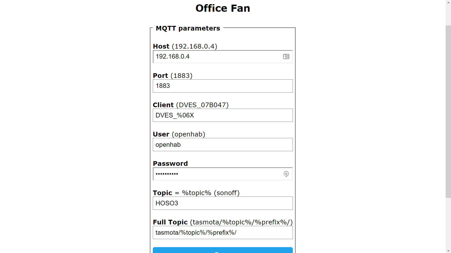

The image below shows my topic format which is most likely different than yours, no particular reason except I felt it was better for me when viewing the structure.
On the sonoff web page under ‘information’ the topics are seend as this:
MQTT Topic HOSO3
MQTT Group Topic sonoffs
MQTT Full Topic tasmota/HOSO3/cmnd/
