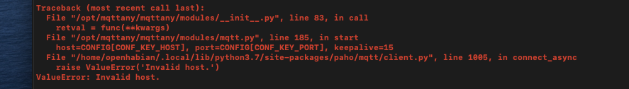

Ivan,
Got it all installed on my raspberry pi and when i try to run it i get this.
Something simple I am sure I did on the install?
Looks like the hostname for you MQTT server is invalid. What is it set to in the config?
