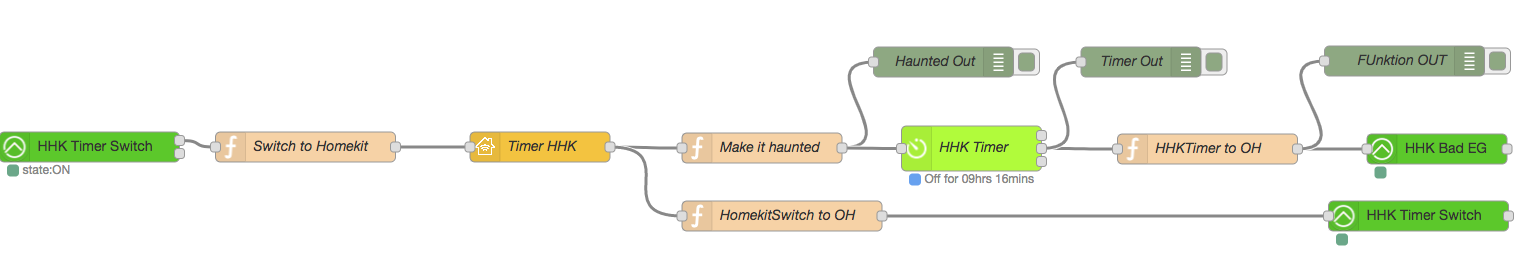

ok, i tried it like this
[{"id":"75ce3e3e.3aaaf","type":"homekit-service","z":"f3d5f228.79716","bridge":"a7511ed2.bcd4f","name":"Timer HHK","serviceName":"Switch","manufacturer":"Default Manufacturer","model":"Default Model","serialNo":"Default Serial Number","characteristicProperties":"{\n \"On\":true,\n \"On\":false\n} \n","x":579.5,"y":694,"wires":[["425e973b.189c78"]]},{"id":"425e973b.189c78","type":"debug","z":"f3d5f228.79716","name":"","active":true,"tosidebar":true,"console":false,"tostatus":false,"complete":"true","x":1015.5,"y":700,"wires":[]},{"id":"a7511ed2.bcd4f","type":"homekit-bridge","z":"","bridgeName":"Homekit-Bridge","pinCode":"031-45-154","port":"","manufacturer":"Default Manufacturer","model":"Default Model","serialNo":"Default Serial Number"}]
But i get NO message in the debug-node.
For this one you’ll need to clear out the “characteristic properties” - that should just be {} for a normal switch.
Then deploy and restart node red with sudo systemctl restart nodered.service (assuming you’re on raspbian?)
Once you’ve done this you should be able to switch “Timer HHK” on and off from your phone homekit and see this in the debug:
{"On": true}
{"On": false}

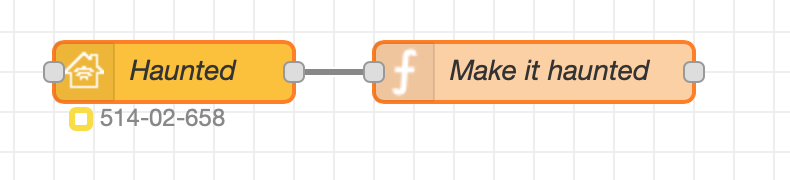

From there you can read about how the bigtimer works and should be able to put it together. I have a similar item in my setup that lets me turn on/off my “haunted” mode - for making the lights turn on and off at random when we are on vacation or want to creep out visitors. Looks like this:
Code:
[{"id":"5221bc4a.7406e4","type":"homekit-service","z":"5d639f8.868e4e","bridge":"4b4fbb6e.6cfaec","name":"Haunted","serviceName":"Switch","manufacturer":"Default Manufacturer","model":"Default Model","serialNo":"Default Serial Number","characteristicProperties":"{}","x":100,"y":1240,"wires":[["2ca07061.e7c7b8"]]},{"id":"2ca07061.e7c7b8","type":"function","z":"5d639f8.868e4e","name":"Make it haunted","func":"var haunt = global.get('haunt')||0;\nif(msg.payload.On === false){\n    haunt = 0;\n    global.set('haunt',haunt);\n}\nif(msg.payload.On === true){\n    haunt = 1;\n    global.set('haunt',haunt);\n}\nmsg.payload = haunt;\nreturn msg;","outputs":1,"noerr":0,"x":280,"y":1240,"wires":[[]]},{"id":"4b4fbb6e.6cfaec","type":"homekit-bridge","z":"","bridgeName":"Node Red","pinCode":"514-02-658","port":"","manufacturer":"Garrett Porter","model":"Pi3","serialNo":"Rev.1"}]
ok, thanks very much, Garrett!!
This worked. Now i have to figure out, how to keep the state form this homekit-switch over all iOS-Devices.
…solved it like this:

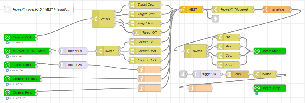

Thanks @crxporter and @ae_0017 for all the help with my NEST setup.
Here is what I’ve come up with. I started with @ae_0017’s flow but modified it to handle Fahrenheit temperatures coming from and to openHAB (I just did mathematical conversions in the function nodes). I also included humidity measurements just for fun and split up the target and current state messages. Now, HomeKit can show me when the furnace is actually calling for heat rather than just when it’s turned on and ready to go.
[{"id":"27de070e.894f88","type":"openhab2-in","z":"4cdce619.771d08","name":"Current Mode","controller":"b71fea36.e2bda","itemname":"A_HVAC_NEST_Mode","x":90,"y":160,"wires":[["c6914aa1.7d6478"],[]]},{"id":"46e37c08.e44a84","type":"openhab2-in","z":"4cdce619.771d08","name":"Current Temp","controller":"b71fea36.e2bda","itemname":"A_HVAC_NEST_Temp","x":90,"y":400,"wires":[["7c1a89cc.fd8c68"],[]]},{"id":"d0d38764.0cc648","type":"openhab2-in","z":"4cdce619.771d08","name":"Target Temp","controller":"b71fea36.e2bda","itemname":"A_HVAC_NEST_SP","x":90,"y":280,"wires":[["99912d20.0e466"],[]]},{"id":"c6914aa1.7d6478","type":"switch","z":"4cdce619.771d08","name":"","property":"payload","propertyType":"msg","rules":[{"t":"eq","v":"COOL","vt":"str"},{"t":"eq","v":"HEAT","vt":"str"},{"t":"eq","v":"AUTO","vt":"str"},{"t":"eq","v":"OFF","vt":"str"},{"t":"eq","v":"ECO","vt":"str"}],"checkall":"true","repair":false,"outputs":5,"x":450,"y":80,"wires":[["5e3d8c65.474bb4"],["61fcaf63.86e9b"],["75ec1436.fde05c"],["bb063419.b46468"],["bb063419.b46468"]]},{"id":"99912d20.0e466","type":"trigger","z":"4cdce619.771d08","op1":"","op2":"","op1type":"nul","op2type":"payl","duration":"3","extend":true,"units":"s","reset":"","bytopic":"all","name":"","x":320,"y":280,"wires":[["3b73aba.6b2e054"]]},{"id":"3b73aba.6b2e054","type":"function","z":"4cdce619.771d08","name":"","func":"{\nval = parseFloat(msg.payload).toFixed(1);\nf = (val - 32) * 0.5556;\n}\n\n{\nmsg.payload = {\n    TargetTemperature: + f\n    }\n;\n}\nreturn msg;","outputs":1,"noerr":0,"x":650,"y":300,"wires":[["495bb036.a22c5"]]},{"id":"7c1a89cc.fd8c68","type":"function","z":"4cdce619.771d08","name":"","func":"\n{\nval = parseFloat(msg.payload).toFixed(1)\nf = (val - 32) * 0.5556;\n\n}\n{\nmsg.payload = {\n CurrentTemperature: + f\n\n}\n}\nreturn msg;\n\n\n\n","outputs":1,"noerr":0,"x":650,"y":380,"wires":[["495bb036.a22c5"]]},{"id":"cbab5368.42145","type":"change","z":"4cdce619.771d08","name":"Current Off","rules":[{"t":"set","p":"payload","pt":"msg","to":"{\"CurrentHeatingCoolingState\":0}","tot":"json"}],"action":"","property":"","from":"","to":"","reg":false,"x":630,"y":180,"wires":[["495bb036.a22c5"]]},{"id":"bb063419.b46468","type":"change","z":"4cdce619.771d08","name":"Target Off","rules":[{"t":"set","p":"payload","pt":"msg","to":"{\"TargetHeatingCoolingState\":0}","tot":"json"}],"action":"","property":"","from":"","to":"","reg":false,"x":640,"y":140,"wires":[["495bb036.a22c5"]]},{"id":"75ec1436.fde05c","type":"change","z":"4cdce619.771d08","name":"Target Auto","rules":[{"t":"set","p":"payload","pt":"msg","to":"{\"TargetHeatingCoolingState\":3}","tot":"json"}],"action":"","property":"","from":"","to":"","reg":false,"x":630,"y":100,"wires":[["495bb036.a22c5"]]},{"id":"a564a00b.10c64","type":"change","z":"4cdce619.771d08","name":"Current Heat","rules":[{"t":"set","p":"payload","pt":"msg","to":"{\"CurrentHeatingCoolingState\":1}","tot":"json"}],"action":"","property":"","from":"","to":"","reg":false,"x":630,"y":220,"wires":[["495bb036.a22c5"]]},{"id":"61fcaf63.86e9b","type":"change","z":"4cdce619.771d08","name":"Target Heat","rules":[{"t":"set","p":"payload","pt":"msg","to":"{\"TargetHeatingCoolingState\":1}","tot":"json"}],"action":"","property":"","from":"","to":"","reg":false,"x":630,"y":60,"wires":[["495bb036.a22c5"]]},{"id":"d93d193.09e57e8","type":"change","z":"4cdce619.771d08","name":"Current Cool","rules":[{"t":"set","p":"payload","pt":"msg","to":"{\"CurrentHeatingCoolingState\":2}","tot":"json"}],"action":"","property":"","from":"","to":"","reg":false,"x":630,"y":260,"wires":[["495bb036.a22c5"]]},{"id":"5e3d8c65.474bb4","type":"change","z":"4cdce619.771d08","name":"Target Cool","rules":[{"t":"set","p":"payload","pt":"msg","to":"{\"TargetHeatingCoolingState\":2}","tot":"json"}],"action":"","property":"","from":"","to":"","reg":false,"x":630,"y":20,"wires":[["495bb036.a22c5"]]},{"id":"495bb036.a22c5","type":"homekit-service","z":"4cdce619.771d08","bridge":"467c262f.9839","name":"NEST","serviceName":"Thermostat","manufacturer":"NestLabs","model":"3rd Generation","serialNo":"Default Serial Number","characteristicProperties":"{}","x":830,"y":40,"wires":[["f5d928d6.3ffaf8","bde0fd55.4fb44"]]},{"id":"bde0fd55.4fb44","type":"switch","z":"4cdce619.771d08","name":"HomeKit Triggered","property":"hap.context","propertyType":"msg","rules":[{"t":"nnull"}],"checkall":"true","repair":false,"outputs":1,"x":1010,"y":40,"wires":[["b366eb66.3435d8"]]},{"id":"bb2d229f.70fdf","type":"trigger","z":"4cdce619.771d08","op1":"","op2":"","op1type":"nul","op2type":"payl","duration":"3","extend":true,"units":"s","reset":"","bytopic":"all","name":"","x":900,"y":320,"wires":[["bab80779.30ffe8"]]},{"id":"bab80779.30ffe8","type":"json","z":"4cdce619.771d08","name":"","property":"payload","action":"","pretty":false,"x":1030,"y":320,"wires":[["b82a7183.fdb8e"]]},{"id":"b366eb66.3435d8","type":"template","z":"4cdce619.771d08","name":"","field":"payload","fieldType":"msg","format":"handlebars","syntax":"mustache","template":"{{payload.TargetHeatingCoolingState}}","output":"str","x":1200,"y":40,"wires":[["ca965786.c6e858"]]},{"id":"ca965786.c6e858","type":"switch","z":"4cdce619.771d08","name":"","property":"payload","propertyType":"msg","rules":[{"t":"eq","v":"0","vt":"str"},{"t":"eq","v":"1","vt":"str"},{"t":"eq","v":"2","vt":"str"},{"t":"eq","v":"3","vt":"str"}],"checkall":"true","repair":false,"outputs":4,"x":850,"y":220,"wires":[["e6c0c805.049d28"],["ee3a4f61.aeef3"],["cf0b76a7.efe538"],["91ff824a.6ad7e"]]},{"id":"b82a7183.fdb8e","type":"switch","z":"4cdce619.771d08","name":"","property":"payload","propertyType":"msg","rules":[{"t":"cont","v":"TargetTemperature","vt":"str"}],"checkall":"true","repair":false,"outputs":1,"x":1150,"y":320,"wires":[["fce5dd93.006588"]]},{"id":"91ff824a.6ad7e","type":"change","z":"4cdce619.771d08","name":"Auto","rules":[{"t":"set","p":"payload","pt":"msg","to":"HEAT/COOL","tot":"str"}],"action":"","property":"","from":"","to":"","reg":false,"x":990,"y":280,"wires":[["2f313a68.bb2456"]]},{"id":"cf0b76a7.efe538","type":"change","z":"4cdce619.771d08","name":"Cool","rules":[{"t":"set","p":"payload","pt":"msg","to":"COOL","tot":"str"}],"action":"","property":"","from":"","to":"","reg":false,"x":990,"y":240,"wires":[["2f313a68.bb2456"]]},{"id":"ee3a4f61.aeef3","type":"change","z":"4cdce619.771d08","name":"Heat","rules":[{"t":"set","p":"payload","pt":"msg","to":"HEAT","tot":"str"}],"action":"","property":"","from":"","to":"","reg":false,"x":990,"y":200,"wires":[["2f313a68.bb2456"]]},{"id":"e6c0c805.049d28","type":"change","z":"4cdce619.771d08","name":"Off","rules":[{"t":"set","p":"payload","pt":"msg","to":"ECO","tot":"str"}],"action":"","property":"","from":"","to":"","reg":false,"x":990,"y":160,"wires":[["2f313a68.bb2456"]]},{"id":"2f313a68.bb2456","type":"openhab2-out","z":"4cdce619.771d08","name":"Target Mode","controller":"b71fea36.e2bda","itemname":"A_HVAC_NEST_Mode","topic":"ItemCommand","payload":"","x":1170,"y":220,"wires":[]},{"id":"3c5991ec.13b55e","type":"openhab2-out","z":"4cdce619.771d08","name":"Target Temp","controller":"b71fea36.e2bda","itemname":"A_HVAC_NEST_SP","topic":"ItemCommand","payload":"","x":1170,"y":380,"wires":[]},{"id":"fce5dd93.006588","type":"function","z":"4cdce619.771d08","name":"","func":"{\nval = msg.payload.substring(21,msg.payload.length - 1)\nf = (val * 1.8) + 32;\npl = f + \" °F\";\n}\n\n{\nmsg.payload = pl;\n    \n}\n\nreturn msg;","outputs":1,"noerr":0,"x":870,"y":380,"wires":[["3c5991ec.13b55e"]]},{"id":"5ec48513.35bcac","type":"openhab2-in","z":"4cdce619.771d08","name":"Current Humidity","controller":"b71fea36.e2bda","itemname":"A_HVAC_NEST_Hum","x":100,"y":340,"wires":[["1cb2cdbd.595752"],[]]},{"id":"1cb2cdbd.595752","type":"function","z":"4cdce619.771d08","name":"","func":"\n{\n\nval = parseFloat(msg.payload).toFixed(1);\n\n}\n{\nmsg.payload = {\n CurrentRelativeHumidity: + val\n\n}\n}\nreturn msg;\n\n\n\n","outputs":1,"noerr":0,"x":650,"y":340,"wires":[["495bb036.a22c5"]]},{"id":"b454298d.584de8","type":"openhab2-in","z":"4cdce619.771d08","name":"","controller":"b71fea36.e2bda","itemname":"A_HVAC_NEST_State","x":120,"y":220,"wires":[["40a52f45.8c73f"],[]]},{"id":"1248a4fb.f123fb","type":"switch","z":"4cdce619.771d08","name":"","property":"payload","propertyType":"msg","rules":[{"t":"eq","v":"OFF","vt":"str"},{"t":"eq","v":"HEATING","vt":"str"},{"t":"eq","v":"COOLING","vt":"str"}],"checkall":"true","repair":false,"outputs":3,"x":470,"y":220,"wires":[["cbab5368.42145"],["a564a00b.10c64"],["d93d193.09e57e8"]]},{"id":"7ac4610e.0af2b","type":"comment","z":"4cdce619.771d08","name":"HomeKit / openHAB / NEST Integration","info":"Modified by DOME for Fahrenheit values and to utilize NEST current state and humidity readings.","x":170,"y":40,"wires":[]},{"id":"f5d928d6.3ffaf8","type":"link out","z":"4cdce619.771d08","name":"","links":["d84e8b.ca26e178"],"x":935,"y":80,"wires":[]},{"id":"d84e8b.ca26e178","type":"link in","z":"4cdce619.771d08","name":"","links":["f5d928d6.3ffaf8"],"x":795,"y":320,"wires":[["bb2d229f.70fdf"]]},{"id":"40a52f45.8c73f","type":"trigger","z":"4cdce619.771d08","op1":"","op2":"","op1type":"pay","op2type":"payl","duration":"5","extend":true,"units":"s","reset":"","bytopic":"all","name":"","x":320,"y":220,"wires":[["1248a4fb.f123fb"]]},{"id":"b71fea36.e2bda","type":"openhab2-controller","z":"","name":"openHAB Archon","protocol":"http","host":"192.168.1.80","port":"8080","path":"","username":"","password":""},{"id":"467c262f.9839","type":"homekit-bridge","z":"","bridgeName":"node-RED","pinCode":"111-11-111","port":"","manufacturer":"Default Manufacturer","model":"Default Model","serialNo":"Default Serial Number"}]

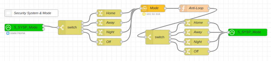

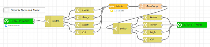

Here is a simple Security System/Mode interface.
[{"id":"e169f5fb.2d6e58","type":"homekit-service","z":"d27b17dd.6f9178","bridge":"467c262f.9839","name":"Mode","serviceName":"SecuritySystem","manufacturer":"openHAB","model":"Security","serialNo":"SEC1","characteristicProperties":"{}","x":650,"y":320,"wires":[["1dd129ed.3600c6"]]},{"id":"4de2a843.357ec8","type":"comment","z":"d27b17dd.6f9178","name":"Security System & Mode","info":"","x":150,"y":340,"wires":[]},{"id":"b842c690.e32798","type":"openhab2-in","z":"d27b17dd.6f9178","name":"","controller":"b71fea36.e2bda","itemname":"S_SYSP_Mode","x":120,"y":400,"wires":[["5800eb72.6bcba4"],[]]},{"id":"5800eb72.6bcba4","type":"switch","z":"d27b17dd.6f9178","name":"","property":"payload","propertyType":"msg","rules":[{"t":"eq","v":"Home","vt":"str"},{"t":"eq","v":"Away","vt":"str"},{"t":"eq","v":"Night","vt":"str"},{"t":"eq","v":"Off","vt":"str"}],"checkall":"true","repair":false,"outputs":4,"x":310,"y":400,"wires":[["70ea5789.c46808"],["ccda47c0.c3e438"],["efec486b.b17f88"],["f7594072.3ef1c"]]},{"id":"70ea5789.c46808","type":"change","z":"d27b17dd.6f9178","name":"Home","rules":[{"t":"set","p":"payload","pt":"msg","to":"{\"SecuritySystemCurrentState\":0}","tot":"json"}],"action":"","property":"","from":"","to":"","reg":false,"x":470,"y":340,"wires":[["e169f5fb.2d6e58"]]},{"id":"ccda47c0.c3e438","type":"change","z":"d27b17dd.6f9178","name":"Away","rules":[{"t":"set","p":"payload","pt":"msg","to":"{\"SecuritySystemCurrentState\":1}","tot":"json"}],"action":"","property":"","from":"","to":"","reg":false,"x":470,"y":380,"wires":[["e169f5fb.2d6e58"]]},{"id":"efec486b.b17f88","type":"change","z":"d27b17dd.6f9178","name":"Night","rules":[{"t":"set","p":"payload","pt":"msg","to":"{\"SecuritySystemCurrentState\":2}","tot":"json"}],"action":"","property":"","from":"","to":"","reg":false,"x":470,"y":420,"wires":[["e169f5fb.2d6e58"]]},{"id":"f7594072.3ef1c","type":"change","z":"d27b17dd.6f9178","name":"Off","rules":[{"t":"set","p":"payload","pt":"msg","to":"{\"SecuritySystemCurrentState\":3}","tot":"json"}],"action":"","property":"","from":"","to":"","reg":false,"x":470,"y":460,"wires":[["e169f5fb.2d6e58"]]},{"id":"1dd129ed.3600c6","type":"function","z":"d27b17dd.6f9178","name":"Anti-Loop","func":"if (msg.hap.context !== undefined) {\n    msg.payload = msg.payload.SecuritySystemTargetState\n    return msg\n}\n","outputs":1,"noerr":0,"x":820,"y":320,"wires":[["94c901f5.2e114"]]},{"id":"94c901f5.2e114","type":"switch","z":"d27b17dd.6f9178","name":"","property":"payload","propertyType":"msg","rules":[{"t":"eq","v":"0","vt":"str"},{"t":"eq","v":"1","vt":"str"},{"t":"eq","v":"2","vt":"str"},{"t":"eq","v":"3","vt":"str"}],"checkall":"true","repair":false,"outputs":4,"x":670,"y":440,"wires":[["380c3abe.a99706"],["3b47e835.7dd538"],["c5e1398d.8ff418"],["6cf45b25.38f794"]]},{"id":"380c3abe.a99706","type":"change","z":"d27b17dd.6f9178","name":"Home","rules":[{"t":"set","p":"payload","pt":"msg","to":"Home","tot":"str"}],"action":"","property":"","from":"","to":"","reg":false,"x":830,"y":380,"wires":[["1045dc74.7d3194"]]},{"id":"3b47e835.7dd538","type":"change","z":"d27b17dd.6f9178","name":"Away","rules":[{"t":"set","p":"payload","pt":"msg","to":"Away","tot":"str"}],"action":"","property":"","from":"","to":"","reg":false,"x":830,"y":420,"wires":[["1045dc74.7d3194"]]},{"id":"c5e1398d.8ff418","type":"change","z":"d27b17dd.6f9178","name":"Night","rules":[{"t":"set","p":"payload","pt":"msg","to":"Night","tot":"str"}],"action":"","property":"","from":"","to":"","reg":false,"x":830,"y":460,"wires":[["1045dc74.7d3194"]]},{"id":"6cf45b25.38f794","type":"change","z":"d27b17dd.6f9178","name":"Off","rules":[{"t":"set","p":"payload","pt":"msg","to":"Off","tot":"str"}],"action":"","property":"","from":"","to":"","reg":false,"x":830,"y":500,"wires":[["1045dc74.7d3194"]]},{"id":"1045dc74.7d3194","type":"openhab2-out","z":"d27b17dd.6f9178","name":"","controller":"b71fea36.e2bda","itemname":"S_SYSP_Mode","topic":"ItemCommand","payload":"","x":1040,"y":420,"wires":[]},{"id":"467c262f.9839","type":"homekit-bridge","z":"","bridgeName":"node-RED","pinCode":"111-11-111","port":"","manufacturer":"Default Manufacturer","model":"Default Model","serialNo":"Default Serial Number"},{"id":"b71fea36.e2bda","type":"openhab2-controller","z":"","name":"openHAB Archon","protocol":"http","host":"192.168.1.80","port":"8080","path":"","username":"","password":""}]

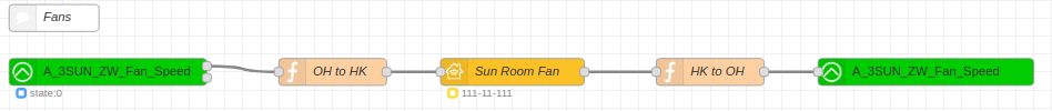

Here’s a simple Fan:
[{"id":"51eae811.05e998","type":"comment","z":"4cdce619.771d08","name":"Fans","info":"","x":70,"y":620,"wires":[]},{"id":"a77548c3.da8458","type":"function","z":"4cdce619.771d08","name":"HK to OH","func":"var b = context.get('b')||0;\nif(msg.payload.RotationSpeed){\n    b = msg.payload.RotationSpeed;\n    context.set('b',b);\n    msg.payload=b\n}\nif (msg.hap.context !== undefined) {\n    if(msg.payload.RotationSpeed === 0){\n        msg.payload = 0\n    }\n    if(msg.payload.On === false){\n        msg.payload = 0\n    }\n    if(msg.payload.On === true){\n        msg.payload = b\n    }\n    return msg\n}","outputs":1,"noerr":0,"x":800,"y":680,"wires":[["6e9e333f.42f65c"]]},{"id":"56b3c941.017218","type":"homekit-service","z":"4cdce619.771d08","bridge":"467c262f.9839","name":"Sun Room Fan","serviceName":"Fan","manufacturer":"Jasco","model":"Jasco","serialNo":"J1","characteristicProperties":"{\"RotationSpeed\":true}","x":580,"y":680,"wires":[["a77548c3.da8458"]],"inputLabels":["{\"RotationSpeed\":true}"]},{"id":"6e9e333f.42f65c","type":"openhab2-out","z":"4cdce619.771d08","name":"","controller":"b71fea36.e2bda","itemname":"A_3SUN_ZW_Fan_Speed","topic":"ItemCommand","payload":"","x":1040,"y":680,"wires":[]},{"id":"1abba446.11c8bc","type":"function","z":"4cdce619.771d08","name":"OH to HK","func":"var input = msg.payload;\nif (input < 101){\n    if (input < 1) {\n        msg.payload = {\n        \"On\": false\n    }\n    }\n    else {\n        msg.payload = {\n        \"RotationSpeed\": input,\n        \"On\": true\n    }\n    }\n    return msg;\n}","outputs":1,"noerr":0,"x":380,"y":680,"wires":[["56b3c941.017218"]]},{"id":"45b8ca63.f51544","type":"openhab2-in","z":"4cdce619.771d08","name":"","controller":"b71fea36.e2bda","itemname":"A_3SUN_ZW_Fan_Speed","x":130,"y":680,"wires":[["1abba446.11c8bc"],[]]},{"id":"467c262f.9839","type":"homekit-bridge","z":"","bridgeName":"node-RED","pinCode":"111-11-111","port":"","manufacturer":"Default Manufacturer","model":"Default Model","serialNo":"Default Serial Number"},{"id":"b71fea36.e2bda","type":"openhab2-controller","z":"","name":"openHAB Archon","protocol":"http","host":"192.168.1.80","port":"8080","path":"","username":"","password":""}]

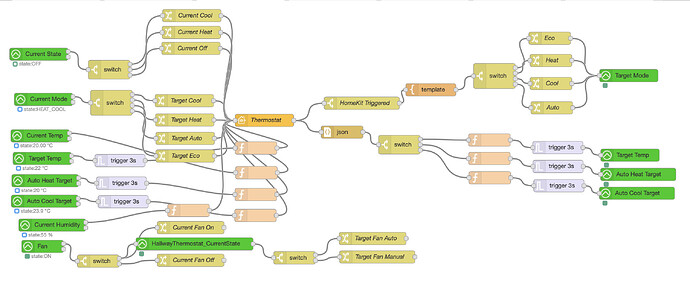

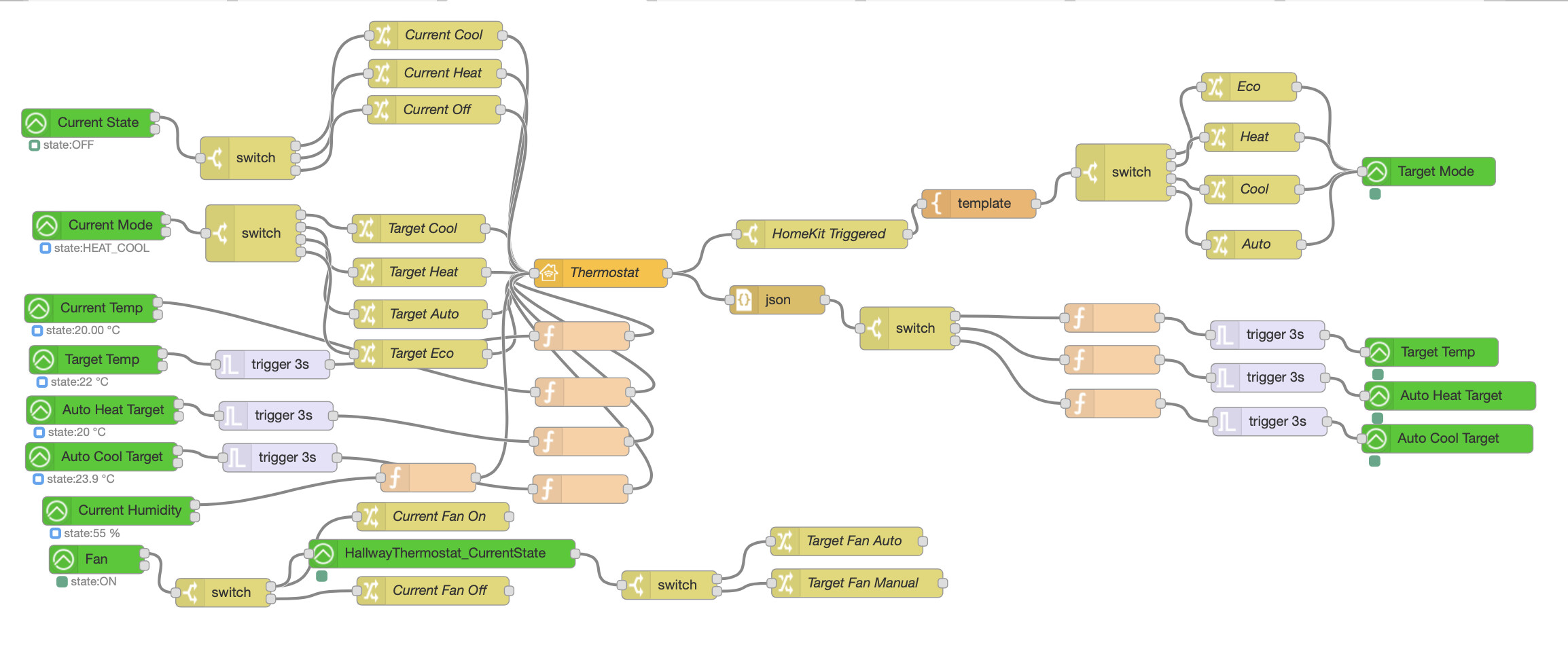

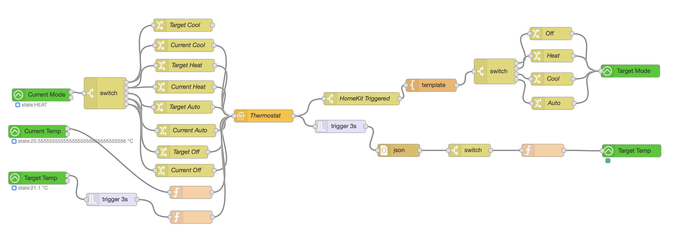

I played with this some more and got Heating and Cooling Thresholds to work properly as well. So now the auto mode actually adjusts the temperature range like it should. It’s amazing how powerful these nodes are.
[{"id":"93dcea3d.c82c98","type":"openhab2-in","z":"187a1471.2d90bc","name":"Current State","controller":"b762b8c6.ca55a8","itemname":"HallwayThermostat_CurrentState","x":98.5,"y":128,"wires":[["21838fa.3150bf"],[]]},{"id":"203774c6.1da0e4","type":"openhab2-in","z":"187a1471.2d90bc","name":"Current Mode","controller":"b762b8c6.ca55a8","itemname":"HallwayThermostat_CurrentMode","x":110,"y":236,"wires":[["d75cad4b.f19bf"],[]]},{"id":"4811709a.5baa7","type":"openhab2-in","z":"187a1471.2d90bc","name":"Current Temp","controller":"b762b8c6.ca55a8","itemname":"HallwayThermostat_CurrentTemperature","x":101.5,"y":323,"wires":[["c08ebe89.d3ee1"],[]]},{"id":"45959d01.a9b2d4","type":"openhab2-in","z":"187a1471.2d90bc","name":"Target Temp","controller":"b762b8c6.ca55a8","itemname":"HallwayThermostat_TargetSetPoint","x":106.5,"y":377,"wires":[["b56489e4.c69458"],[]]},{"id":"ab218723.9e0778","type":"openhab2-in","z":"187a1471.2d90bc","name":"Auto Heat Target","controller":"b762b8c6.ca55a8","itemname":"NestHallwayThermostat_MinSetPoint","x":113.5,"y":430,"wires":[["d1eb3a40.4e04c8"],[]]},{"id":"cfe6bf7f.bd27","type":"openhab2-in","z":"187a1471.2d90bc","name":"Auto Cool Target","controller":"b762b8c6.ca55a8","itemname":"NestHallwayThermostat_MaxSetPoint","x":112.5,"y":479,"wires":[["e9c116e6.16815"],[]]},{"id":"b0b142a0.f7d1f8","type":"openhab2-in","z":"187a1471.2d90bc","name":"Current Humidity","controller":"b762b8c6.ca55a8","itemname":"HallwayThermostat_Humidity","x":130.5,"y":536,"wires":[["f446d29c.0a0fc8"],[]]},{"id":"21d65d98.379052","type":"openhab2-in","z":"187a1471.2d90bc","name":"Fan","controller":"b762b8c6.ca55a8","itemname":"HallwayThermostat_FanTimerActive","x":107.5,"y":587,"wires":[["f4685822.504fb"],[]]},{"id":"f4685822.504fb","type":"switch","z":"187a1471.2d90bc","name":"","property":"payload","propertyType":"msg","rules":[{"t":"eq","v":"ON","vt":"str"},{"t":"eq","v":"OFF","vt":"str"}],"checkall":"true","repair":false,"outputs":2,"x":240.5,"y":622,"wires":[["69f600d8.f282e8","347d14ed.827de4"],["e06bcc9d.d91e9"]]},{"id":"e9c116e6.16815","type":"trigger","z":"187a1471.2d90bc","op1":"","op2":"","op1type":"nul","op2type":"payl","duration":"3","extend":true,"units":"s","reset":"","bytopic":"all","name":"","x":300,"y":480,"wires":[["dbfc0848.be5808"]]},{"id":"d1eb3a40.4e04c8","type":"trigger","z":"187a1471.2d90bc","op1":"","op2":"","op1type":"nul","op2type":"payl","duration":"3","extend":true,"units":"s","reset":"","bytopic":"all","name":"","x":296,"y":436,"wires":[["2990f648.23bb2a"]]},{"id":"b56489e4.c69458","type":"trigger","z":"187a1471.2d90bc","op1":"","op2":"","op1type":"nul","op2type":"payl","duration":"3","extend":true,"units":"s","reset":"","bytopic":"all","name":"","x":292.5,"y":382,"wires":[["2803a82f.2dc2b8"]]},{"id":"d75cad4b.f19bf","type":"switch","z":"187a1471.2d90bc","name":"","property":"payload","propertyType":"msg","rules":[{"t":"eq","v":"COOL","vt":"str"},{"t":"eq","v":"HEAT","vt":"str"},{"t":"eq","v":"HEAT_COOL","vt":"str"},{"t":"eq","v":"ECO","vt":"str"}],"checkall":"true","repair":false,"outputs":4,"x":272,"y":244,"wires":[["11dcbaf7.1cdb8d"],["ec48caa3.7bd978"],["a52c39b2.77654"],["72c67fa8.b96f98"]]},{"id":"21838fa.3150bf","type":"switch","z":"187a1471.2d90bc","name":"","property":"payload","propertyType":"msg","rules":[{"t":"eq","v":"COOLING","vt":"str"},{"t":"eq","v":"HEATING","vt":"str"},{"t":"eq","v":"OFF","vt":"str"}],"checkall":"true","repair":false,"outputs":3,"x":266.5,"y":165,"wires":[["2bb21ab.8412866"],["4b023924.a43628"],["14ce4810.576148"]]},{"id":"2bb21ab.8412866","type":"change","z":"187a1471.2d90bc","name":"Current Cool","rules":[{"t":"set","p":"payload","pt":"msg","to":"{\"CurrentHeatingCoolingState\":2}","tot":"json"}],"action":"","property":"","from":"","to":"","reg":false,"x":464,"y":36,"wires":[["b9e4991b.c0ce2"]]},{"id":"4b023924.a43628","type":"change","z":"187a1471.2d90bc","name":"Current Heat","rules":[{"t":"set","p":"payload","pt":"msg","to":"{\"CurrentHeatingCoolingState\":1}","tot":"json"}],"action":"","property":"","from":"","to":"","reg":false,"x":463,"y":76,"wires":[["b9e4991b.c0ce2"]]},{"id":"14ce4810.576148","type":"change","z":"187a1471.2d90bc","name":"Current Off","rules":[{"t":"set","p":"payload","pt":"msg","to":"{\"CurrentHeatingCoolingState\":0}","tot":"json"}],"action":"","property":"","from":"","to":"","reg":false,"x":462,"y":114,"wires":[["b9e4991b.c0ce2"]]},{"id":"11dcbaf7.1cdb8d","type":"change","z":"187a1471.2d90bc","name":"Target Cool","rules":[{"t":"set","p":"payload","pt":"msg","to":"{\"TargetHeatingCoolingState\":2}","tot":"json"}],"action":"","property":"","from":"","to":"","reg":false,"x":446,"y":239,"wires":[["b9e4991b.c0ce2"]]},{"id":"ec48caa3.7bd978","type":"change","z":"187a1471.2d90bc","name":"Target Heat","rules":[{"t":"set","p":"payload","pt":"msg","to":"{\"TargetHeatingCoolingState\":1}","tot":"json"}],"action":"","property":"","from":"","to":"","reg":false,"x":447,"y":285,"wires":[["b9e4991b.c0ce2"]]},{"id":"a52c39b2.77654","type":"change","z":"187a1471.2d90bc","name":"Target Auto","rules":[{"t":"set","p":"payload","pt":"msg","to":"{\"TargetHeatingCoolingState\":3}","tot":"json"}],"action":"","property":"","from":"","to":"","reg":false,"x":448,"y":329,"wires":[["b9e4991b.c0ce2"]]},{"id":"72c67fa8.b96f98","type":"change","z":"187a1471.2d90bc","name":"Target Eco","rules":[{"t":"set","p":"payload","pt":"msg","to":"{\"TargetHeatingCoolingState\":0}","tot":"json"}],"action":"","property":"","from":"","to":"","reg":false,"x":448,"y":371,"wires":[["b9e4991b.c0ce2"]]},{"id":"f446d29c.0a0fc8","type":"function","z":"187a1471.2d90bc","name":"","func":"msg.payload = {\n CurrentRelativeHumidity: + parseFloat(msg.payload).toFixed(1)\n};\nreturn msg;","outputs":1,"noerr":0,"x":456,"y":501,"wires":[["b9e4991b.c0ce2"]]},{"id":"69f600d8.f282e8","type":"change","z":"187a1471.2d90bc","name":"Current Fan On","rules":[{"t":"set","p":"payload","pt":"msg","to":"{\"CurrentFanState\":2}","tot":"json"}],"action":"","property":"","from":"","to":"","reg":false,"x":461,"y":542,"wires":[[]]},{"id":"347d14ed.827de4","type":"openhab2-get","z":"187a1471.2d90bc","name":"","controller":"b762b8c6.ca55a8","itemname":"HallwayThermostat_CurrentState","x":470.5,"y":581,"wires":[["ed7665.b6823998"]]},{"id":"e06bcc9d.d91e9","type":"change","z":"187a1471.2d90bc","name":"Current Fan Off","rules":[{"t":"set","p":"payload","pt":"msg","to":"{\"CurrentFanState\":1}","tot":"json"}],"action":"","property":"","from":"","to":"","reg":false,"x":461,"y":620,"wires":[[]]},{"id":"ed7665.b6823998","type":"switch","z":"187a1471.2d90bc","name":"","property":"payload.state","propertyType":"msg","rules":[{"t":"eq","v":"OFF","vt":"str"},{"t":"else"}],"checkall":"true","repair":false,"outputs":2,"x":709.5,"y":614,"wires":[["66fa22fe.35eb7c"],["6ef73424.a5b274"]]},{"id":"dbfc0848.be5808","type":"function","z":"187a1471.2d90bc","name":"","func":"msg.payload = {\n CoolingThresholdTemperature: + parseFloat(msg.payload).toFixed(1)\n};\nreturn msg;","outputs":1,"noerr":0,"x":616,"y":513,"wires":[["b9e4991b.c0ce2"]]},{"id":"2990f648.23bb2a","type":"function","z":"187a1471.2d90bc","name":"","func":"msg.payload = {\n HeatingThresholdTemperature: + parseFloat(msg.payload).toFixed(1)\n};\nreturn msg;","outputs":1,"noerr":0,"x":617,"y":463,"wires":[["b9e4991b.c0ce2"]]},{"id":"c08ebe89.d3ee1","type":"function","z":"187a1471.2d90bc","name":"","func":"msg.payload = {\n CurrentTemperature: + parseFloat(msg.payload).toFixed(1)\n};\nreturn msg;","outputs":1,"noerr":0,"x":618.5,"y":411,"wires":[["b9e4991b.c0ce2"]]},{"id":"2803a82f.2dc2b8","type":"function","z":"187a1471.2d90bc","name":"","func":"msg.payload = {\n TargetTemperature: + parseFloat(msg.payload).toFixed(1)\n};\nreturn msg;","outputs":1,"noerr":0,"x":617.5,"y":352,"wires":[["b9e4991b.c0ce2"]]},{"id":"b9e4991b.c0ce2","type":"homekit-service","z":"187a1471.2d90bc","bridge":"1532ba0d.edf9e6","name":"Thermostat","serviceName":"Thermostat","manufacturer":"NestLabs","model":"3rd Generation","serialNo":"Default Serial Number","characteristicProperties":"{}","x":637.5,"y":286,"wires":[["c9b9a891.73d338","2fd8e382.8b6c3c"]]},{"id":"c9b9a891.73d338","type":"switch","z":"187a1471.2d90bc","name":"HomeKit Triggered","property":"hap.context","propertyType":"msg","rules":[{"t":"nnull"}],"checkall":"true","repair":false,"outputs":1,"x":870,"y":245,"wires":[["d7ef2956.8f7a78"]]},{"id":"2fd8e382.8b6c3c","type":"json","z":"187a1471.2d90bc","name":"","property":"payload","action":"","pretty":false,"x":823,"y":314,"wires":[["c9123698.04db58"]]},{"id":"66fa22fe.35eb7c","type":"change","z":"187a1471.2d90bc","name":"Target Fan Auto","rules":[{"t":"set","p":"payload","pt":"msg","to":"{\"TargetFanState\":1}","tot":"json"}],"action":"","property":"","from":"","to":"","reg":false,"x":896,"y":568,"wires":[[]]},{"id":"6ef73424.a5b274","type":"change","z":"187a1471.2d90bc","name":"Target Fan Manual","rules":[{"t":"set","p":"payload","pt":"msg","to":"{\"TargetFanState\":0}","tot":"json"}],"action":"","property":"","from":"","to":"","reg":false,"x":907,"y":612,"wires":[[]]},{"id":"c9123698.04db58","type":"switch","z":"187a1471.2d90bc","name":"","property":"payload","propertyType":"msg","rules":[{"t":"cont","v":"TargetTemperature","vt":"str"},{"t":"cont","v":"HeatingThreshold","vt":"str"},{"t":"cont","v":"CoolingThreshold","vt":"str"}],"checkall":"true","repair":false,"outputs":3,"x":960,"y":344,"wires":[["831367a9.57a3c"],["4dbc416a.98f478"],["d9241767.0595f8"]]},{"id":"d7ef2956.8f7a78","type":"template","z":"187a1471.2d90bc","name":"","field":"payload","fieldType":"msg","format":"handlebars","syntax":"mustache","template":"{{payload.TargetHeatingCoolingState}}","output":"str","x":1035,"y":213,"wires":[["bed43c8a.9b9b2"]]},{"id":"bed43c8a.9b9b2","type":"switch","z":"187a1471.2d90bc","name":"","property":"payload","propertyType":"msg","rules":[{"t":"eq","v":"0","vt":"str"},{"t":"eq","v":"1","vt":"str"},{"t":"eq","v":"2","vt":"str"},{"t":"eq","v":"3","vt":"str"}],"checkall":"true","repair":false,"outputs":4,"x":1187,"y":180,"wires":[["1ab3e473.cebc34"],["203b514b.555fee"],["eb554923.ee1828"],["7666e7e6.86c8e"]]},{"id":"831367a9.57a3c","type":"function","z":"187a1471.2d90bc","name":"","func":"msg.payload = msg.payload.substring(21,msg.payload.length - 1) + \" °C\";\nreturn msg;","outputs":1,"noerr":0,"x":1175,"y":333,"wires":[["bbbb8110.640c58"]]},{"id":"4dbc416a.98f478","type":"function","z":"187a1471.2d90bc","name":"","func":"msg.payload = msg.payload.substring(31,msg.payload.length - 1) + \" °C\";\nreturn msg;","outputs":1,"noerr":0,"x":1175,"y":377,"wires":[["33ac206e.65a908"]]},{"id":"d9241767.0595f8","type":"function","z":"187a1471.2d90bc","name":"","func":"msg.payload = msg.payload.substring(31,msg.payload.length - 1) + \" °C\";\nreturn msg;","outputs":1,"noerr":0,"x":1176,"y":423,"wires":[["8fe9e967.ffa808"]]},{"id":"1ab3e473.cebc34","type":"change","z":"187a1471.2d90bc","name":"Eco","rules":[{"t":"set","p":"payload","pt":"msg","to":"ECO","tot":"str"}],"action":"","property":"","from":"","to":"","reg":false,"x":1319,"y":90,"wires":[["fce431e4.be80a"]]},{"id":"203b514b.555fee","type":"change","z":"187a1471.2d90bc","name":"Heat","rules":[{"t":"set","p":"payload","pt":"msg","to":"HEAT","tot":"str"}],"action":"","property":"","from":"","to":"","reg":false,"x":1322,"y":143,"wires":[["fce431e4.be80a"]]},{"id":"eb554923.ee1828","type":"change","z":"187a1471.2d90bc","name":"Cool","rules":[{"t":"set","p":"payload","pt":"msg","to":"COOL","tot":"str"}],"action":"","property":"","from":"","to":"","reg":false,"x":1322,"y":198,"wires":[["fce431e4.be80a"]]},{"id":"7666e7e6.86c8e","type":"change","z":"187a1471.2d90bc","name":"Auto","rules":[{"t":"set","p":"payload","pt":"msg","to":"HEAT_COOL","tot":"str"}],"action":"","property":"","from":"","to":"","reg":false,"x":1324,"y":256,"wires":[["fce431e4.be80a"]]},{"id":"bbbb8110.640c58","type":"trigger","z":"187a1471.2d90bc","op1":"","op2":"","op1type":"nul","op2type":"payl","duration":"3","extend":false,"units":"s","reset":"","bytopic":"all","name":"","x":1338.5,"y":351,"wires":[["c79cf5db.d7e8f"]]},{"id":"33ac206e.65a908","type":"trigger","z":"187a1471.2d90bc","op1":"","op2":"","op1type":"nul","op2type":"payl","duration":"3","extend":false,"units":"s","reset":"","bytopic":"all","name":"","x":1339,"y":396,"wires":[["716d018b.1425e"]]},{"id":"8fe9e967.ffa808","type":"trigger","z":"187a1471.2d90bc","op1":"","op2":"","op1type":"nul","op2type":"payl","duration":"3","extend":false,"units":"s","reset":"","bytopic":"all","name":"","x":1341,"y":442,"wires":[["90dc541d.f677a"]]},{"id":"fce431e4.be80a","type":"openhab2-out","z":"187a1471.2d90bc","name":"Target Mode","controller":"b762b8c6.ca55a8","itemname":"HallwayThermostat_CurrentMode","topic":"ItemCommand","payload":"","x":1508,"y":179,"wires":[]},{"id":"c79cf5db.d7e8f","type":"openhab2-out","z":"187a1471.2d90bc","name":"Target Temp","controller":"b762b8c6.ca55a8","itemname":"HallwayThermostat_TargetSetPoint","topic":"ItemCommand","payload":"","x":1511,"y":369,"wires":[]},{"id":"716d018b.1425e","type":"openhab2-out","z":"187a1471.2d90bc","name":"Auto Heat Target","controller":"b762b8c6.ca55a8","itemname":"NestHallwayThermostat_MinSetPoint","topic":"ItemCommand","payload":"","x":1530.5,"y":415,"wires":[]},{"id":"90dc541d.f677a","type":"openhab2-out","z":"187a1471.2d90bc","name":"Auto Cool Target","controller":"b762b8c6.ca55a8","itemname":"NestHallwayThermostat_MaxSetPoint","topic":"ItemCommand","payload":"","x":1527.5,"y":460,"wires":[]},{"id":"b762b8c6.ca55a8","type":"openhab2-controller","z":"","name":"OpenHAB","protocol":"http","host":"localhost","port":"8080","path":"","username":"openhabianpi","password":"Nexus_0017"},{"id":"1532ba0d.edf9e6","type":"homekit-bridge","z":"","bridgeName":"Hallway Bridge","pinCode":"225-00-212","port":"","manufacturer":"Default Manufacturer","model":"Default Model","serialNo":"Default Serial Number"}]
