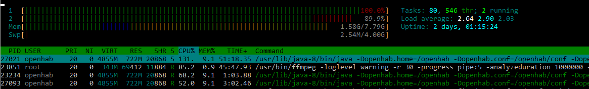

OK, I misunderstood, I thought the delay you were reporting was the runtime of the rule. I can confirm with this specific Rule I’m seeing about a 3 minute load time with near 100% CPU on a 2 virtual cpu VM.
And it does totally stack up. If you don’t wait for the rule to be loaded and make additional edits you will be sitting at 100% CPU utilization for a good long time.
