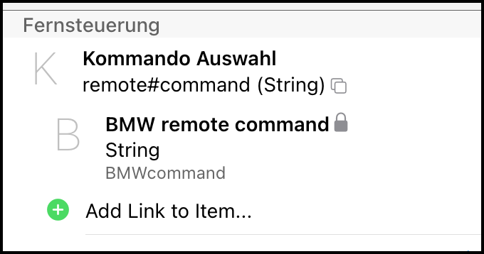

Hello, I managed to get the binding running. So first of all Thank you very much for the efforts to develop the binding! Can you give me a short hint on how to create a switch for activation/deactivation of the air condition (Klimatisierung) of my BMW? I cannot find a dedicated channel for Klimatisierung. Thanks a lot.
look for channel “remote#command” in your car thing:
Click “add link to item”.
Afterwards you can create a rule, that turns on the AC:
BMWcommand.sendCommand("climate-now-start")
