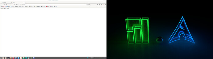

Hi all,
I don’t know if it’s the same problem but when i try to login on the site.
A white page appears with the message “Internal server error”.
Somebody else encounter the same issues?
Can you post a screen shot?
I tested with my mobile. I succeed to establish the connection.
I tried in firefox and chromium on my computer.
