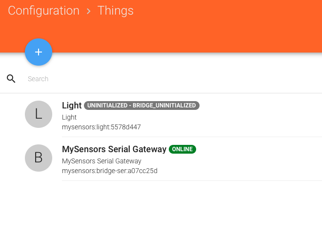

I can add the mysensors serial gateway binding and add a switch that is attached to my gateway and both are recognized however, if I reboot the pi or restart the OpenHab service the gateway will connect but the outlet attached remains uninitialized.

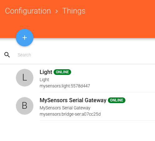

I’ve spent about a day trying to figure this out and am ready to throw in the towel. Any help would be greatly appreciated. See post below for screenshots of my “things” before and after reboot.
