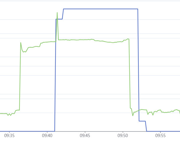

Took a shower so the heatpump had to work :wink: . This confirms my suspicion, myuplink is (at least for the F1245) a huge step back in service compared to the old uplink. The old uplink had a refresh of about a minute. Myuplink increases this to 5 minutes at least. So the refresh interval/lag for reading is increased so much making it kind of useless. Below a graph of powerusage (10 second refresh) and the NIBE brine pump speed showing the lag. Startup, 6 minutes late. Shutdown a minute. Of course more testing is needed but on this I assume it works with fixed 5 minute intervalls (unless you update a setting but that’s not my usecase).
