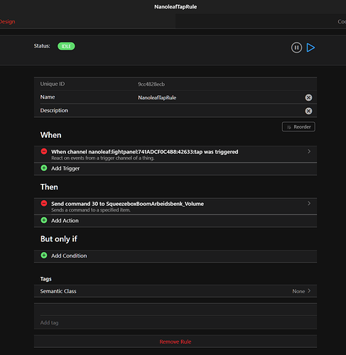

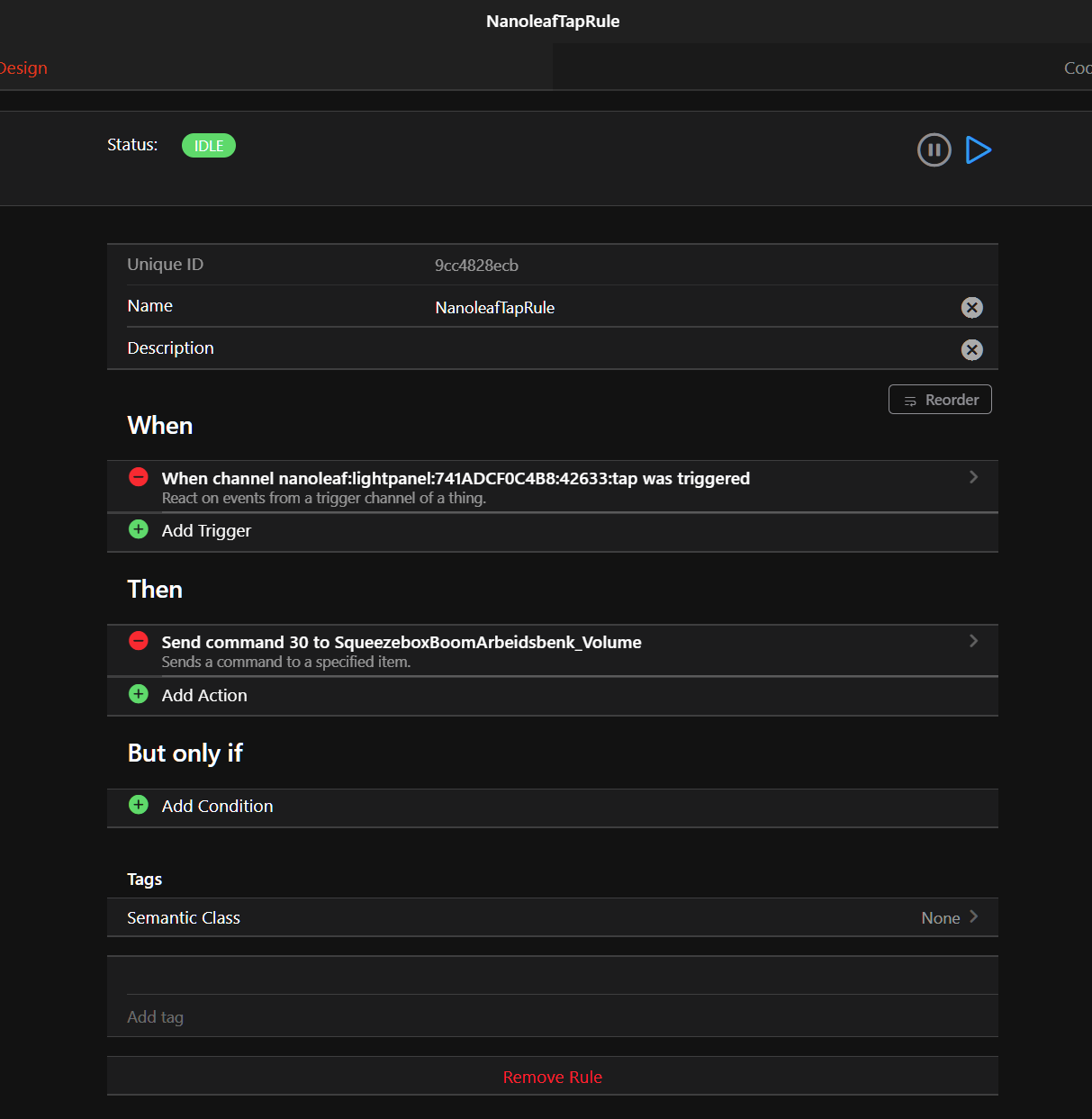

Nothing heard from rule: (used to work)
rule Tile42633
    Channel "nanoleaf:lightpanel:741ADCF0C4B8:42633:tap" triggered SHORT_PRESS
    logInfo("canvasPanelTap", "42633")
    SqueezeboxBoomArbeidsbenk_Volume.sendCommand(30)
Any ideas? A TRACE log perhaps?
Have tried rebooting Canvas and restarting OH …
ON/OFF control from OH works fine.

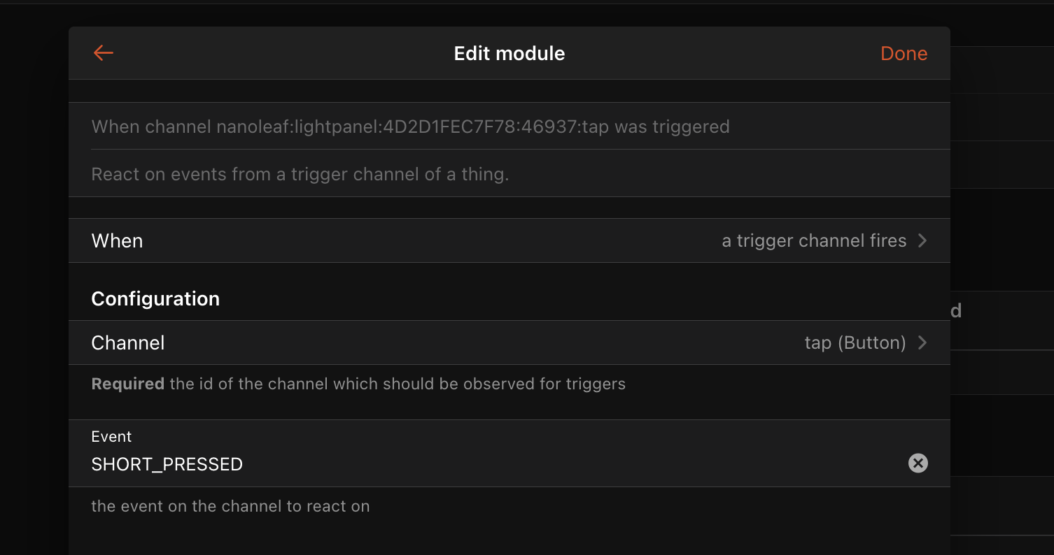

I quickly tried it out with one of my old CANVAS Squares with Block. This is what my trigger looks like
and the rule triggers.

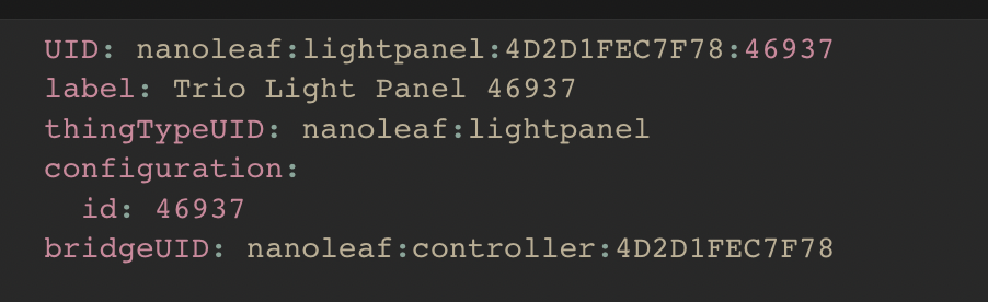

Make sure you create the trigger on the individual panel thing.
The thing is created as such:
Hope that helps
Stefan

Could be an OH thing then perhaps?
Last known log entry of it working was in June, but I don’t press it that often :slight_smile:
/var/log/openhab/openhab.log.16.gz:2022-06-09 07:30:59.597 [INFO ]
[hab.core.model.script.canvasPanelTap] - 42633
Can you try with a blockly rule like I did?
Which was the last version of OH when it worked?
This JSScript works:
But the DSL rule that used to work a few releases back no longer work:
rule Tile42633
It seems to me then that something may have changed on the Rules DSL side that I am not aware of as I am not so much into rules dsl anymore. Maybe you open a new thread were title states that you have a rules dsl channel trigger issue and someone who is very skilled on that will most likely pick that up. I have to admit that your way is the way how it is documented in the binding documentation and therefore I am sure and confirm it has worked like that before.

Do you notice the 16398.0 here? For some reason (I explain in a minute) some of the controllers have a .0 behind the id. The reason is quite surely a bug in openHAB (not nanoleaf) that stored the ids with a fractional number during the configuration validation. It was fixed later via Fix config validation for integer values by J-N-K · Pull Request #3010 · openhab/openhab-core · GitHub
So basically fixing the problem is by going to the thing (the individual panel) and just resaving it and it will save it without the id. Of course you only have to do it for the ones you want to receive a touch from.
Sorry for not finding this issue earlier.
cheers
Stefan
Nice. It started working again :slight_smile:
It also fixed my problem with writing to panels individually, so thanks :slight_smile:
After a reboot, it stopped working again until I saved once more…

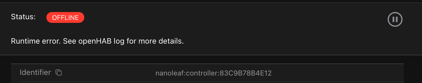

I managed to pair my nanoleaf controller and it worked for a couple of minutes (I was able to control colours and scenes through OH3 but next time I looked it, it was offline due to some Runtime error:
I repeated the pairing procedure and the API was successfully filled in but then it went directly into offline state.
I checked the openhab.log but there is nothing related to nanoleaf.
So I checked events.log and found this:
2022-11-05 17:39:05.646 [INFO ] [ab.event.ThingStatusInfoChangedEvent] - Thing 'nanoleaf:controller:83C9B78B4E12' changed from OFFLINE (COMMUNICATION_ERROR): Communication failed. Please check your network and configuration. to OFFLINE: Runtime error. See openHAB log for more details.
2022-11-05 17:43:29.582 [INFO ] [ab.event.ThingStatusInfoChangedEvent] - Thing 'nanoleaf:controller:83C9B78B4E12' changed from OFFLINE: Runtime error. See openHAB log for more details. to UNKNOWN
2022-11-05 17:43:29.616 [INFO ] [ab.event.ThingStatusInfoChangedEvent] - Thing 'nanoleaf:controller:83C9B78B4E12' changed from UNKNOWN to OFFLINE (CONFIGURATION_PENDING): No authorization token found. To start pairing, press the on-off button of the controller for 5-7 seconds until the LED starts flashing in a pattern.
2022-11-05 17:43:59.726 [INFO ] [ab.event.ThingStatusInfoChangedEvent] - Thing 'nanoleaf:controller:83C9B78B4E12' changed from OFFLINE (CONFIGURATION_PENDING): No authorization token found. To start pairing, press the on-off button of the controller for 5-7 seconds until the LED starts flashing in a pattern. to ONLINE
2022-11-05 17:43:59.732 [INFO ] [ab.event.ThingStatusInfoChangedEvent] - Thing 'nanoleaf:controller:83C9B78B4E12' changed from ONLINE to OFFLINE: Runtime error. See openHAB log for more details.
2022-11-05 17:44:20.213 [INFO ] [ab.event.ThingStatusInfoChangedEvent] - Thing 'nanoleaf:controller:83C9B78B4E12' changed from OFFLINE: Runtime error. See openHAB log for more details. to UNKNOWN
2022-11-05 17:44:20.232 [INFO ] [ab.event.ThingStatusInfoChangedEvent] - Thing 'nanoleaf:controller:83C9B78B4E12' changed from UNKNOWN to OFFLINE: Runtime error. See openHAB log for more details.
I went back to òpenhab.log` to check for anything around these timestamps but there is nothing.
How can I troubleshoot this?

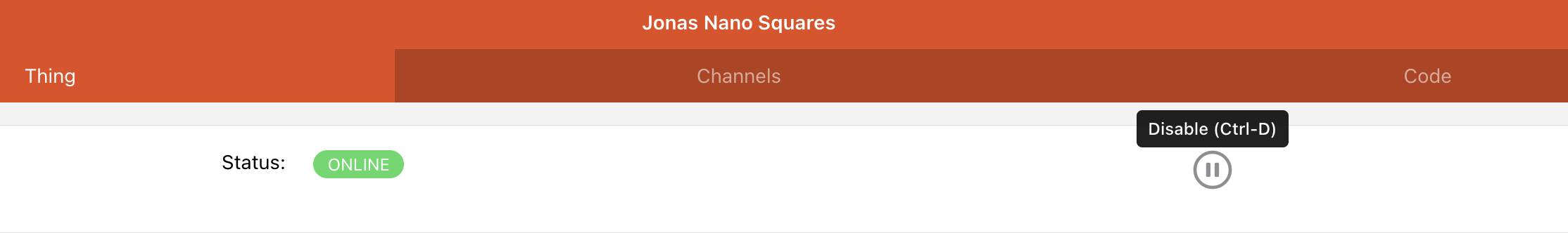

We have to look at both logs.
To analyze it more deeply we need to set it to debug.
Then go to the controller thing, disable it and enable it in again in the UI:
Do you have the log viewer running on :9001? Open it and filter for “nano” and see what’s happening.
(I presume you are the latest version)
By the way, sometimes they do go offline but the controller tries to reconnect within a minute.
