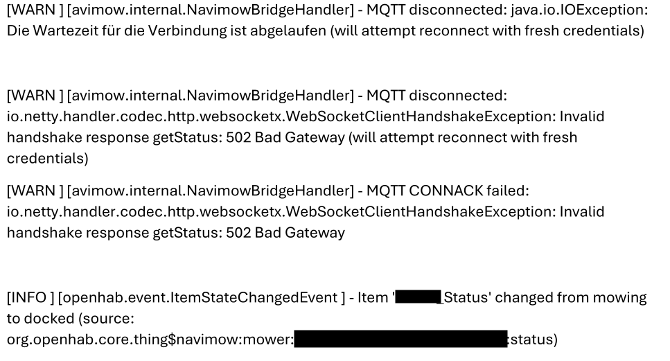

logging is a bit tricky; there is no notification if the connection is lost. You only notice it when the mower is supposed to change status—for instance, from mowing to docking or vice versa—but the change isn’t reported in openHAB. After about two hours, it attempts to re-establish the connection, but again, there is no indication of whether that attempt succeeded or failed! I do receive a script-generated notification when the status changes to “docking” or “mowing.” Even today, it worked exactly once: the mower returned to the docking station without triggering a notification. One more thing: I don’t want to control the mower via openHAB; for me, it is important that control happens through the native navimow app while the current status is sent to openHAB. The goal is to implement a reliable gate control system.
Here are some logs:
Try logging at TRACE level. Best to have those logs saved in a separate file. Here’s how to do that:
A reliable gate control system would involve no external dependencies, and simply activated by a proximity sensor. I presume you’ve already got the actuator / motor to open the gate. If you want to be super fancy, have some sort of RFID on the mower that is verified by the gate so only the mower can trigger it.
This doesn’t negate the fact that this binding is currently dropping connections on you and indeed that should be fixed. I haven’t had time to work on it since publishing it here. I’m hoping to have more time in a week.
So you’re saying that after about two hours the connection dropped, and there seems to be a period where it’s in a disconnected state before it tries to reconnect. After it reconnected then it works again, until the next time it gets disconnected? You didn’t have to intervene to reconnect?
So far, the only information I have from the log is that a reconnection is being initiated. Unfortunately, there is no indication—neither in the log nor in the “Thing” status—as to whether this was actually successful; the status remains green/online even when there is no connection. Up to now, manual reconnection has always been required.
