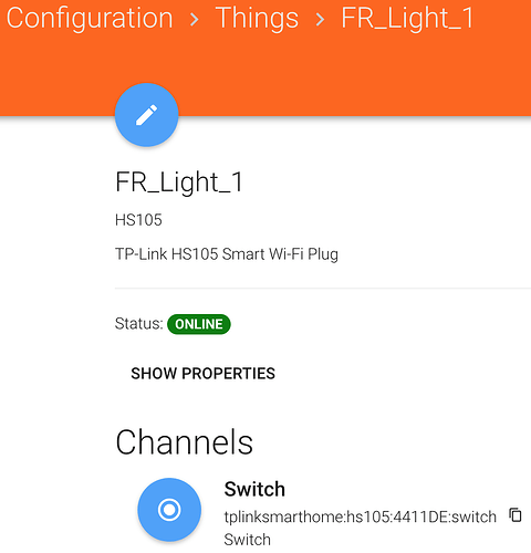

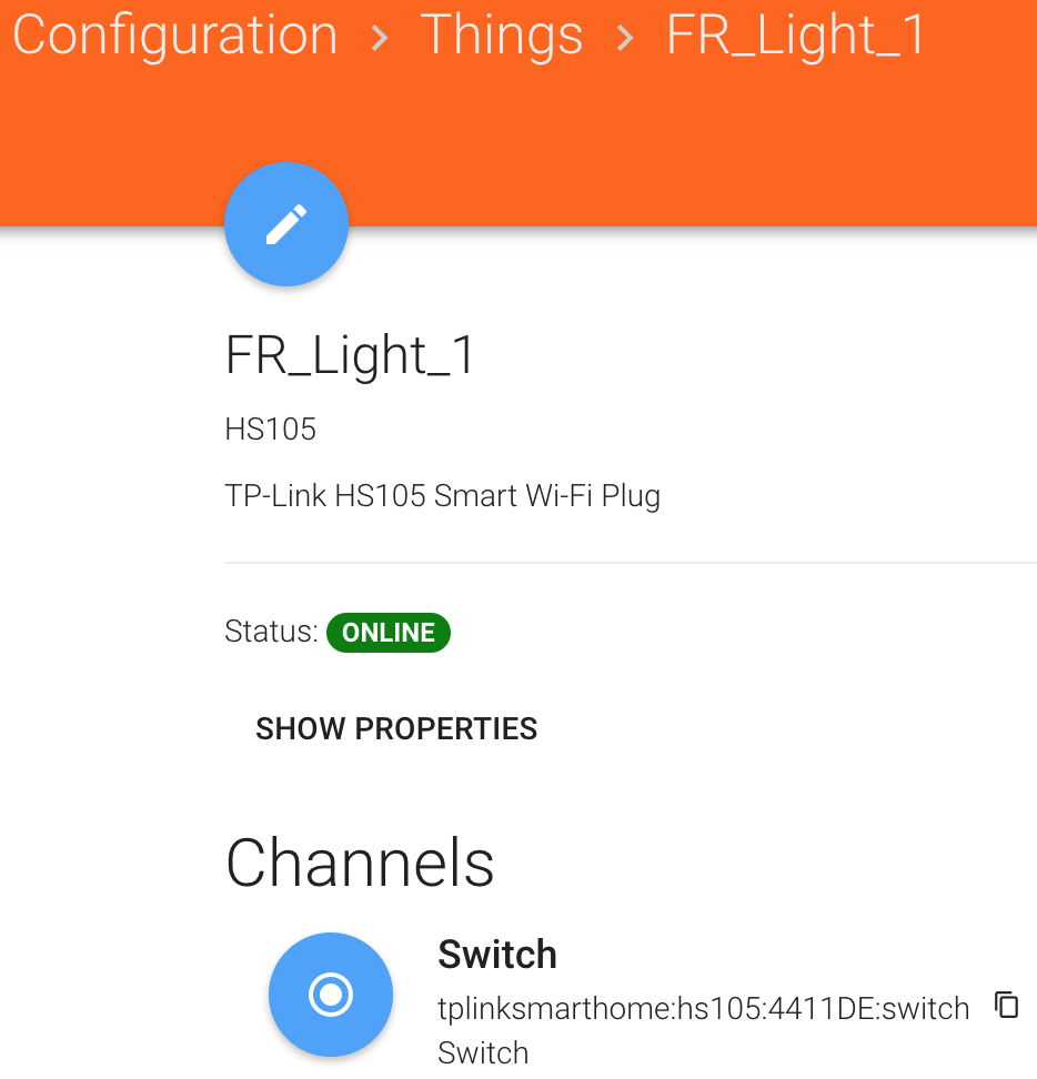

Send a screen shot of the Tplink light Item. You may of unintentionally unlinked it. In the blue circle is the center solid white? If you go to the Control page of PaperUI do you see the Light with a switch control that works to toggle the light?

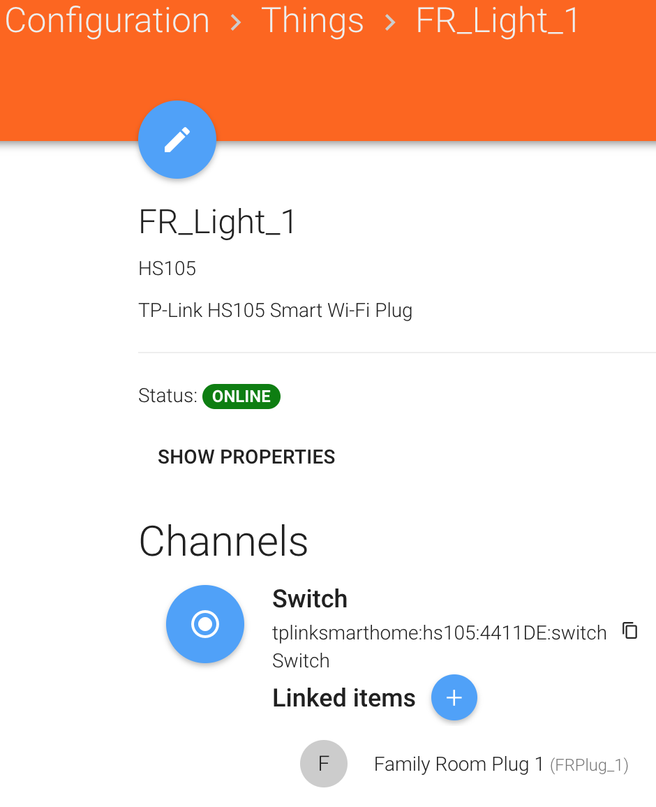

Click on the outside blue area of the circle. That will show you what it is Linked to (Linked Item). You want that item in Grey like my examples above.
FRPlug_1
Change both the ON and the OFF lines.
