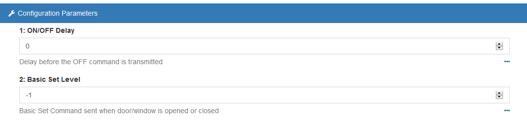

update:
I just got these errors after making the changes to the configuration parameters (from 255 to -1), and leaving association groups 2-4 blank
2018-11-21 19:10:59.228 [ERROR] [e.internal.WriterInterceptorExecutor] - MessageBodyWriter not found for media type=text/plain, type=class java.util.Collections$UnmodifiableCollection, genericType=class java.util.Collections$UnmodifiableCollection.
2018-11-21 19:11:00.054 [ERROR] [e.internal.WriterInterceptorExecutor] - MessageBodyWriter not found for media type=text/plain, type=class java.util.Collections$UnmodifiableCollection, genericType=class java.util.Collections$UnmodifiableCollection.
2018-11-21 19:11:00.885 [ERROR] [e.internal.WriterInterceptorExecutor] - MessageBodyWriter not found for media type=text/plain, type=class java.util.Collections$UnmodifiableCollection, genericType=class java.util.Collections$UnmodifiableCollection.
2018-11-21 19:11:01.716 [ERROR] [e.internal.WriterInterceptorExecutor] - MessageBodyWriter not found for media type=text/plain, type=class java.util.Collections$UnmodifiableCollection, genericType=class java.util.Collections$UnmodifiableCollection.
from 255 to -1
It’s the same, just set it to 255:
Isn’t a positive number a “non-zero” number? If you want -1, then 255 will be the same if it’s a 1 byte value.
