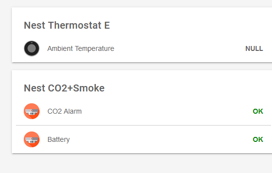

I followed the example but I could not figure out why I am still getting ‘null’ result.
Here’s my item config
Number  Ambient_Temp "Ambient Temperature [%.1f °C]" <thermostat> 	{ http="<[nest:60000:JS(GetNestValue.js)]" }
This is my http.cfg (redacted my device_id and access token
nest.url=https://developer-api.nest.com/devices/thermostats/IVR7xImXXXXXXXXXX0?auth=c.FCXXXXXXXXXXXXXXXXXWF8mpTGloVc8v9hb3lt4QlZ5n6VQTTnMlMWWxoZieJddgR2tmxxxxxxxxxx
nest.updateInterval=60000
nest.url=https://developer-api.nest.com/devices/smoke_co_alarms/iRFgN4xxxxxxxxxxxxxx?auth=c.FXXXXXXXXXXXXXXXXXXXXXXXpTGloVc8v9hb3lt4QlZ5n6VQTTnMlMWWxoZieJddgR2tmbzifDOfSsx9XtJOcfzFxxxxxxxxxx

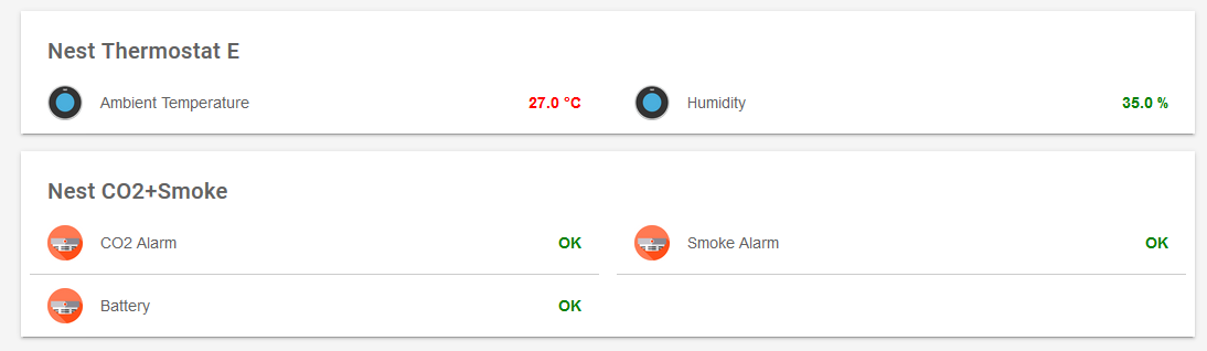

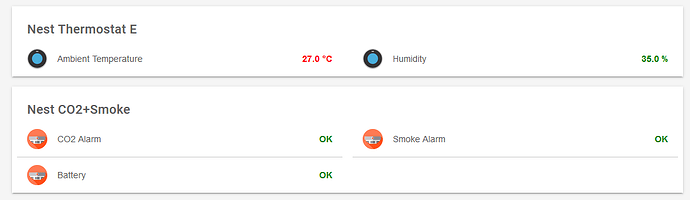

For Nest Protect it is working fine but for thermostat I am getting the ‘null’ result.
nest_OH
If polling does work for you, you might as well give the original openHAB 1.x Nest Binding a try. :wink:
Yes polling is working for me now, I am starting to see data in my Nest items and this thread gave me hope, :smile: I finally got the Nest integration to my OH setup. How I wish NEST binding worked for me because I think it is a neat way integrating Nest products in anyone’s home automation system.
