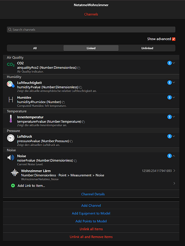

When I have a noise level of 39db in the netatmo app, I have on ~12589 on the Channel.
Seems to be an Issue with the unit. Has anyone an idea how to fix that?

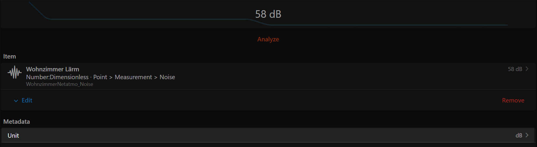

The unit needs to be set to dB
that was easy :slight_smile: with the Unit “dB” it works fine
