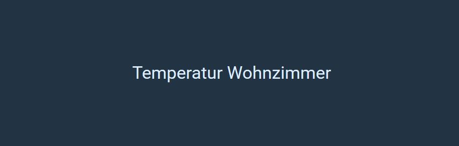

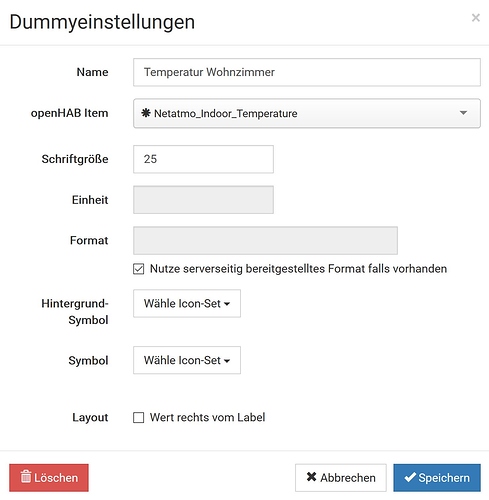

When it comes to HABpanel using the dummy widget i always get a number with more than 10 decimals.
I found different solutions here in the forum but no one worked for me.
Adding the format to the dummy widget leads to an empty widget field after i saved the changes.
Before i had added all Modules of the netatmo with simple mode on the paper ui and had the same result so i tried to use the *.things and *.items files hoping to have better result.

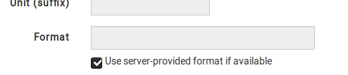

when you link the temp to the dummy widget there is a selection to use the system format . or something like that. sorry can’t remember at this moment and I am near my system as I have every thing off busy building and removed server from the flat for prevention of dust Ingres
There was a problem with displaying the Units of Measurement items in HABpanel.
This has been fixed but I don’t know in which release.
