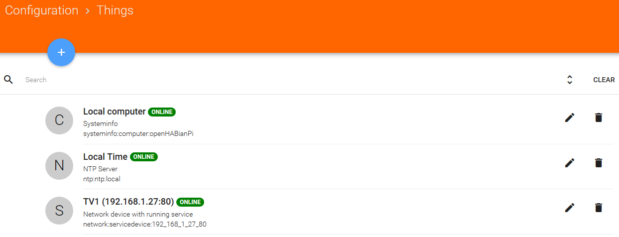

I got it to work finally.
I can read device status ON/OFF, response time and last seen time.
I used the following configs
sitemap
Frame label="Status" {
Text item=MyDevice label="Device [%s]" valuecolor=[ON="green" ,OFF="red"]
Text item=MyDeviceResponseTime label="Device Response Time [%s]"
Text item=MyDeviceLastSeenTime label="Last Seen Time [%1$ta %1$tR]"
items
/* Network Device Status */
Switch MyDevice { channel="network:pingdevice:devicename:online" }
Number MyDeviceResponseTime { channel="network:pingdevice:devicename:latency" }
DateTime MyDeviceLastSeenTime { channel="network:pingdevice:devicename:lastseen" }
