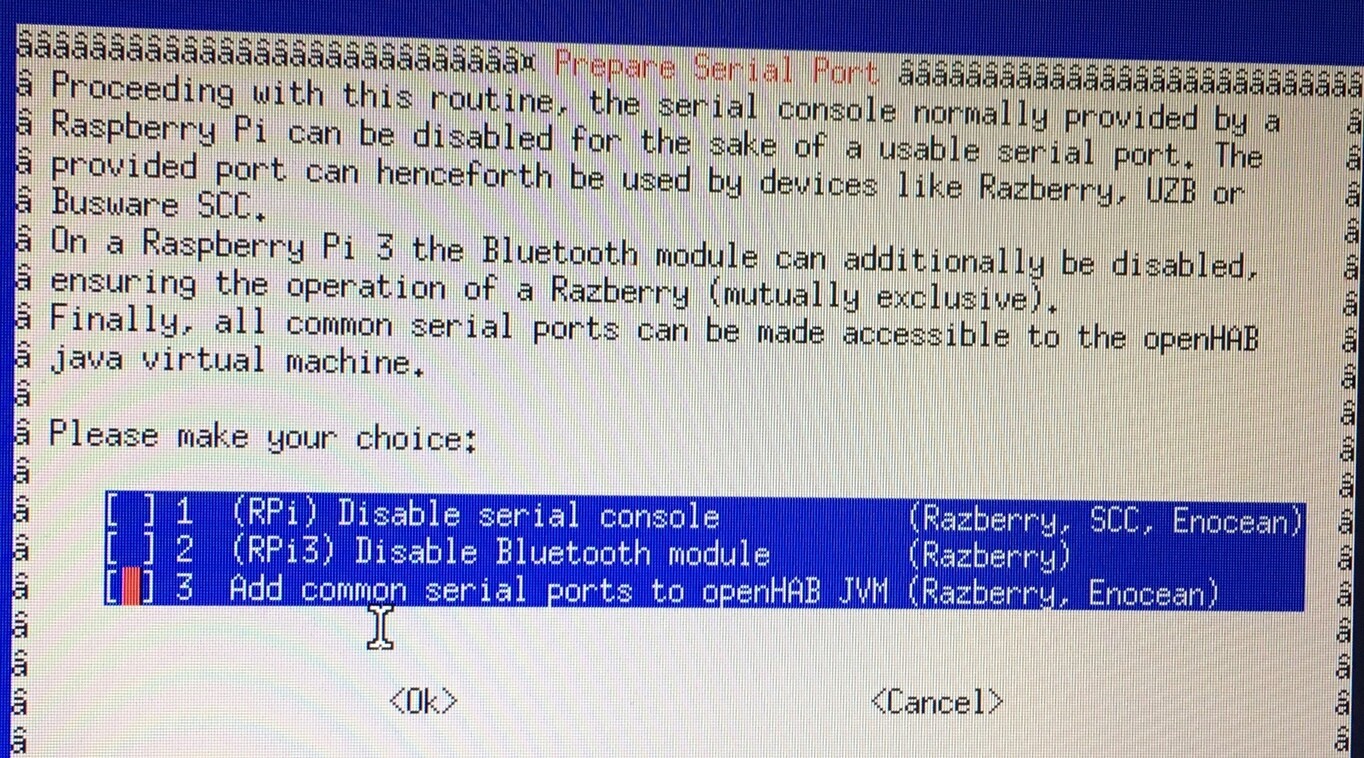

But maybe there is something. The Pi is connecting wireless, not over ethernet. I read that the UART Module should be switched to the UART which is blocked by WLAN
Reading it several times, I might be totally and it would relly be 1.
How are you going to observe it is working? Are you sure the used address and the ON and OFF values are correct?
In order to be sure on that I hab used the screen hypertext console.
