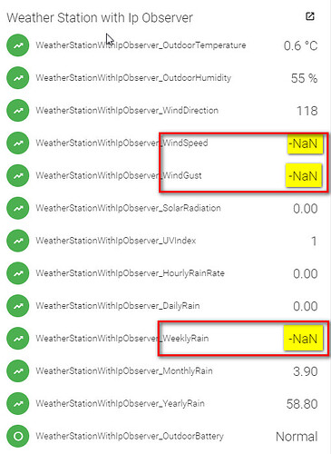

Yesterday I’ve installed your binding for my WS-1400IP and some informations doesn’t work by me. Do you know why ?

NAN means Not a Number, have a look at the livedata page directly and see if the field has text or perhaps is null… Wait and if the value changes the binding should update it.
Also it confuses me why yours has degrees C next to the outdoor temp value, the mods I made should have removed all unit labelling, perhaps you need to do a clean of your tmp and cache folders if you have tried multiple jar files?

I will search the problem. The binding I have downloaded is from this page: http://www.pcmus.com/openhab/WeatherStationBinding/
My mistake about the degrees C, I forgot I had played with the ability for the binding to follow the regional settings of Openhab, this is only done for the temperature and nothing else. I had not done it for the other settings as some of them have 4 different units they can be set to like wind. KM/hr, m/sec, Knotts, miles/hr, fps..
