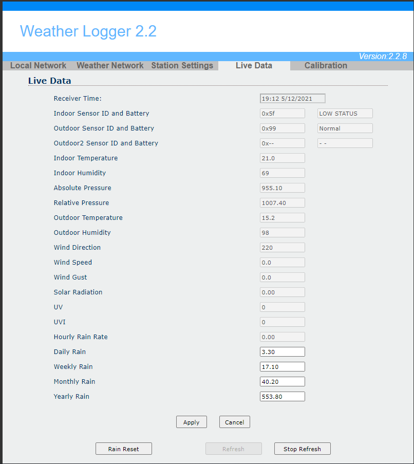

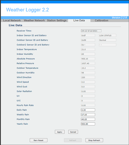

Hey Matt, to keep things clean, I uninstalled my station thing before upgrading and removed the addon from the addon folder. I tried creating the thing via the v3 ui and the channel issue is logged immediately. Can you confirm for me which text file you’re talking about - assume you mean the github readme? I’ve definitely followed that and your info about using the ui to install. I’m wondering if I have an older version of the weather logger with different fields and so the scraper is failing? Attached is a screenshot of the live data page of my weather logger.

Yep read that and definitely installed via UI. Still get the error. Also tried clearing the cache but still get the error when trying to create a new thing.

I looked and it seems to list everything else except the battery status so in your case is not helpful.. Best to inspect the source of the livedata page and paste the lines that refer to the battery status. Your firmware may have another html class which I have seen this for other fields before.
name=inBattSta
name=outBattSta

@matt1
I think the problem is with my firmware, it supports two ID and battery sensors.
Mine is named “OutBattSta1” you got “OutBattSta”
If you got some spare time, can you add support for this?
Im running the AmbientWeather 4.6.1 Firmware on my IPObserver
<td bgcolor="#EDEFEF"><div class="item_1">Outdoor Sensor ID and Battery</div></td>
                        <input name="Outdoor1ID" disabled="disabled" type="text" class="item_2" style="WIDTH: 80px" value="0x00079" maxlength="12" />
                        <input name="outBattSta1" disabled="disabled" type="text" class="item_2" style="WIDTH: 100px" value="Normal" maxlength="12" />
                    </td>
