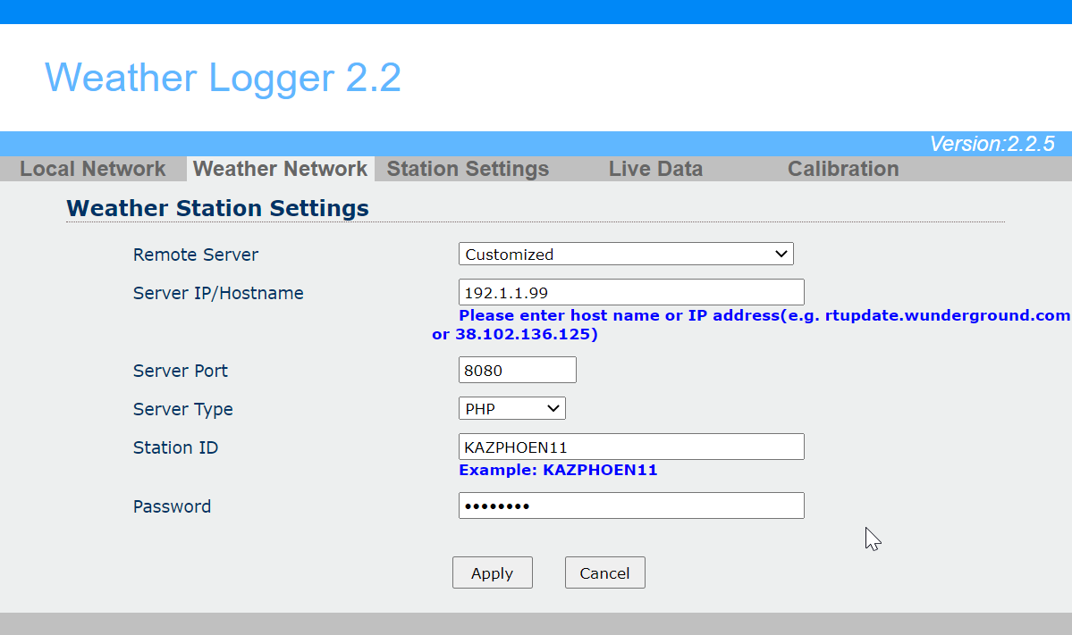

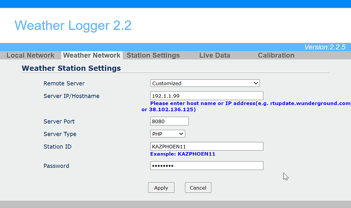

Make your settings look like this and enter in the ID and PASSWORD into the configs for the weatherstation thing. IP is your openHAB’s IP and the port is the number you use to view your openHAB UI which is normally 8080
ID and Password from the wunderground station?
Yes, if you can’t change it in a control panel like the picture shows you may need to use an app to do it or use your router to redirect the data. Instead of it going to the WU IP address it needs to go to the openhab ip and port 8080.

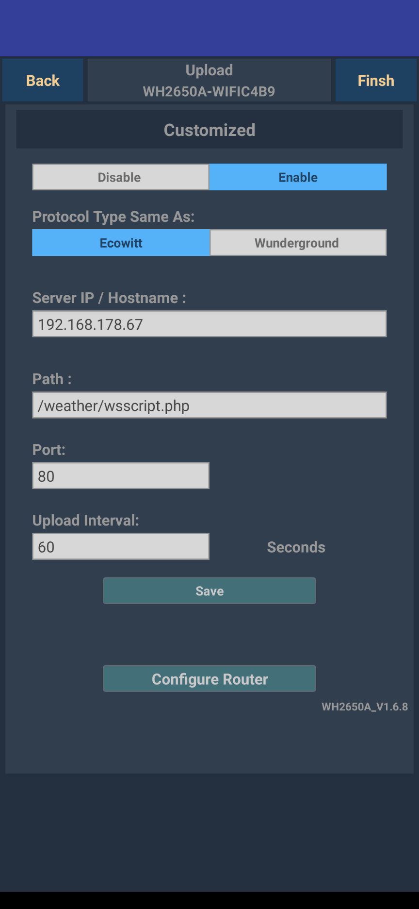

hm, this is all i can configure under customized (via app, can’t connect to station wia webui):
no option for php server.

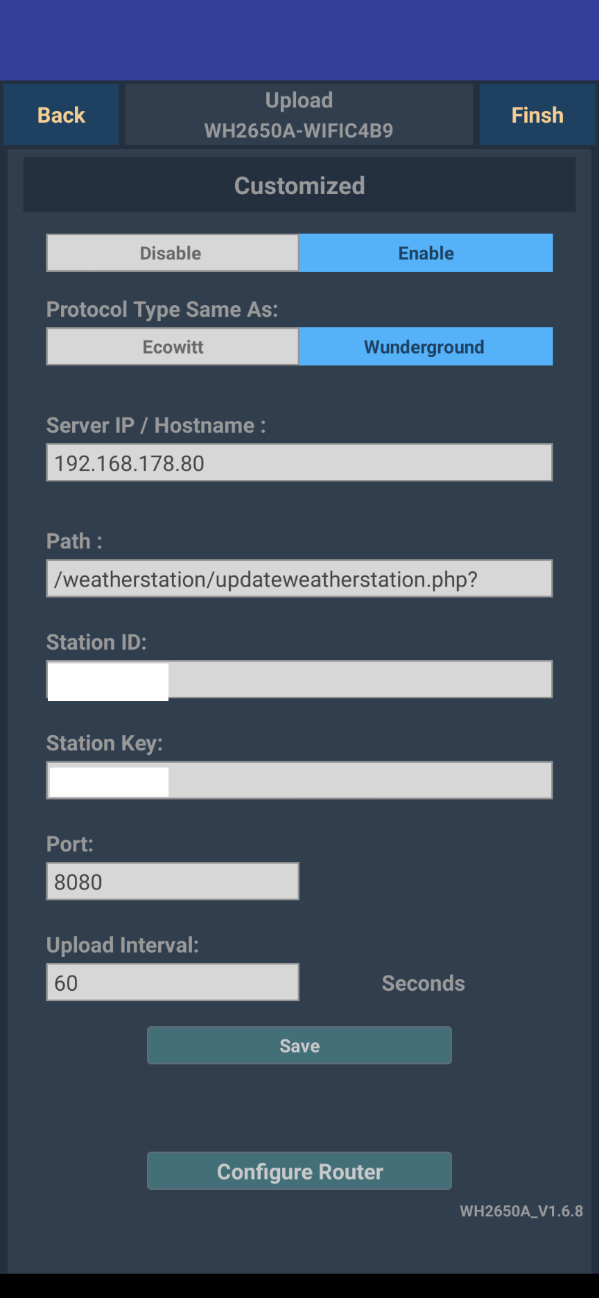

this is the wunderground service page:
That first picture looks to be correct.
Change the path to be
/weatherstation/updateweatherstation.php
Change the port to 8080
Make sure it is the ip of openhab
Try both of the two formats and see if it works

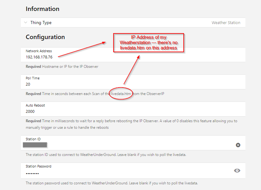

2nd & 3rd try (ip address from my weather station > where there’s no livedata.htm! tried with both data formats, same results):

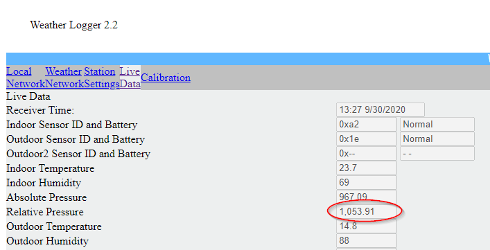

in my first attempt i see the error
2021-08-16 23:10:38.534 [WARN ] [mmon.WrappedScheduledExecutorService] - Scheduled runnable ended with an exception: java.lang.NumberFormatException: For input string: "1,053.91"
which according to livedata.htm is the relative pressure:
Forget about using the script and scraping it for now, as it will be better to move to this newer method then future people will benefit…
Did you download the new jar and include it into the addons folder?

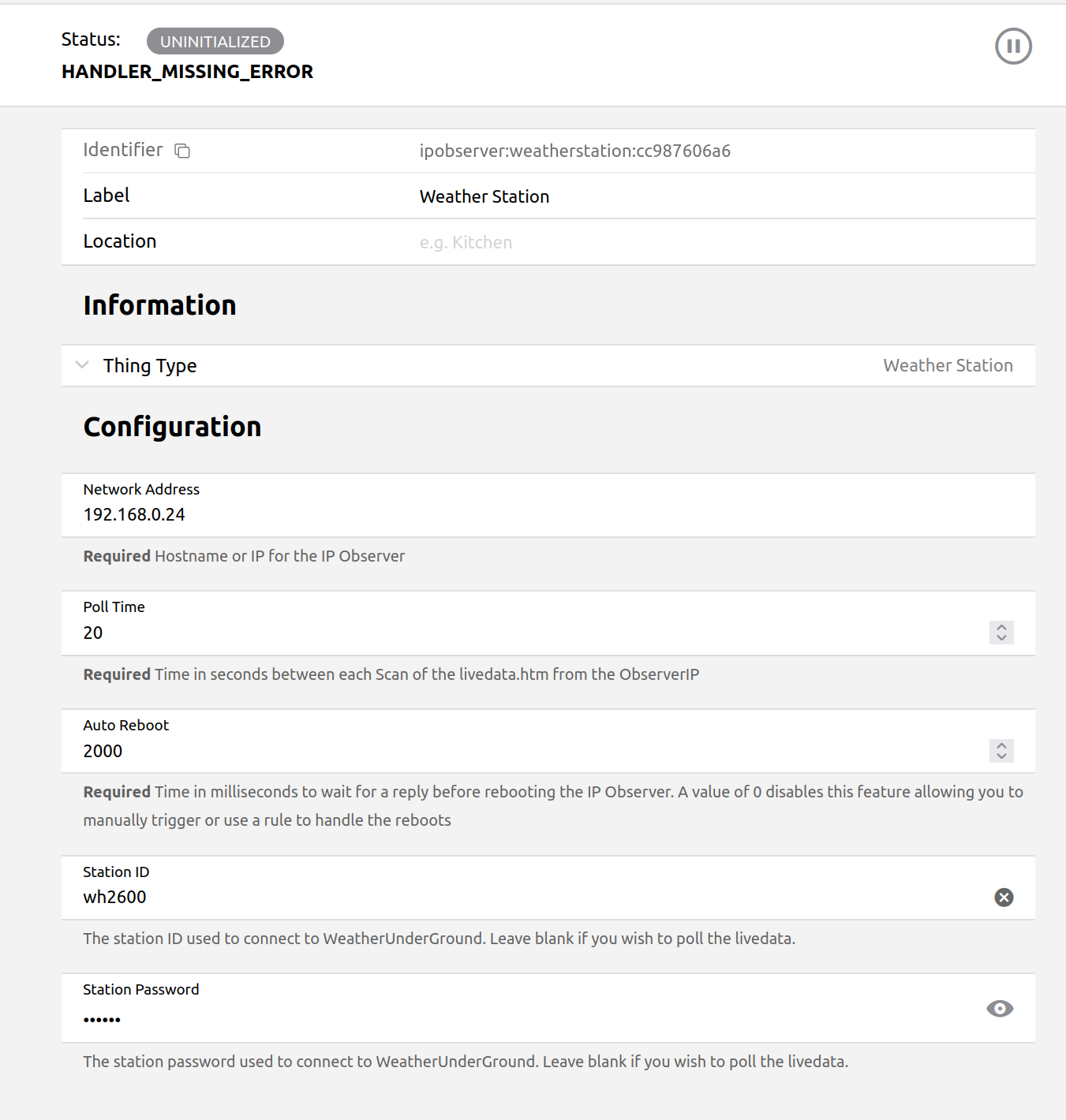

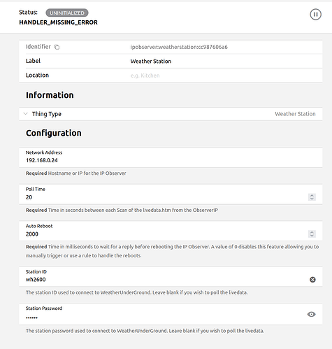

does the station thing have two new configs for the user and password?
When you enter a user and password, does the thing go to ONLINE?
Do you have TRACE level turned on for this binding? I dont see any lines that indicate you have.
in console:
log:set TRACE org.openhab.binding.ipobserver
yes, looks like this in bundles list: 287 │ Active │ 80 │ 3.2.0.202108080839 │ org.openhab.binding.ipobserver
yes, where it says “Leave blank if you wish to poll the livedata” so i left this blank previously.
yes, when i entered my station ID (not user) and password the thing goes online!

i have linkes to channels, but both items are NULL and there’s nothing in the logs.
edit: some channels (like UV Index) are missing now, is that correct?
Here’s my thing:
No channels should be missing, just some may require you to tick the show advanced box to see them.
If the thing is online, then it is listening for updates and any that match the user/pass will get logged provided it reaches the path below.
The packets need to reach..
openhabIP:8080/weatherstation/updateweatherstation.php

I’ve got the Ecowitt Gateway and got this to work after the following:
  1. Upgraded Openhab to 3.1.0
  2. Added the custom jar above
  3. Installed the Jinja Transformation
  4. Created a thing + channels, but be aware you have to provide a stationID and password in order for it to be online (ignore the livedata comment), but these values are nothing to do with the Ecowitt’s Serial number or anything, they appear to just be credentials that must match the values in the Customized panel of the Ecowitt app (I assume this is because the app originally polled the Wunderground servers)
  5. In the Customized (Weather Services) panel of the Ecowitt app, Set the Protocol to Wunderground, Stick in the Server IP of Openhab and the Path of /weatherstation/updateweatherstation.php, Station ID and Station Key must then match the credentials you put in the Thing.
  6. Wait at least the Upload Interval ( 5 min ) and Bingo!

ok, with these settings in the binding
and these settings on the WS
i get updates:

I’m new to OpenHAB (started today) and obviously also new to this binding. I have a WH 2650A not connected to wunderground. I configured the custom Wunderground connection as shown in the screenshots above. I also installed the IpObserver binding provided by @matt1 and gave my station a random Station ID and password which matches my settings on the station but does not exist on wunderground.
Now I get a HANDLER_MISSING_ERROR. How can I find out what’s wrong?
Thanks in advance for any help provided.
