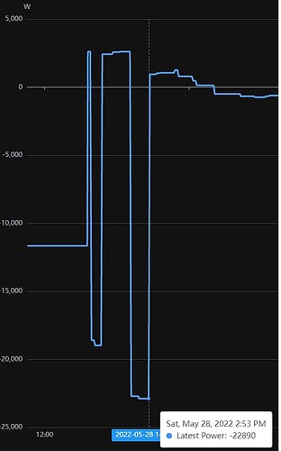

Is anyone else experiencing weird negative values on a system without consumption metering? My Envoy regularly reports a negative value for the latest power, sometimes well in excess (negatively) of my system’s production capability (screenshot attached). I also get similarly weird negative numbers from my inverters. Is this a number conversion/scaling issue or something else (like signed integer vs. unsigned integer)? Is there a way to expose the actual value being read from the Envoy pre-conversion/-scaling? (edit: I managed to decrypt my installer password and the Envoy webpage itself is reporting negative values for some of the inverters. It sems the Envoy can’t do it correctly!)
