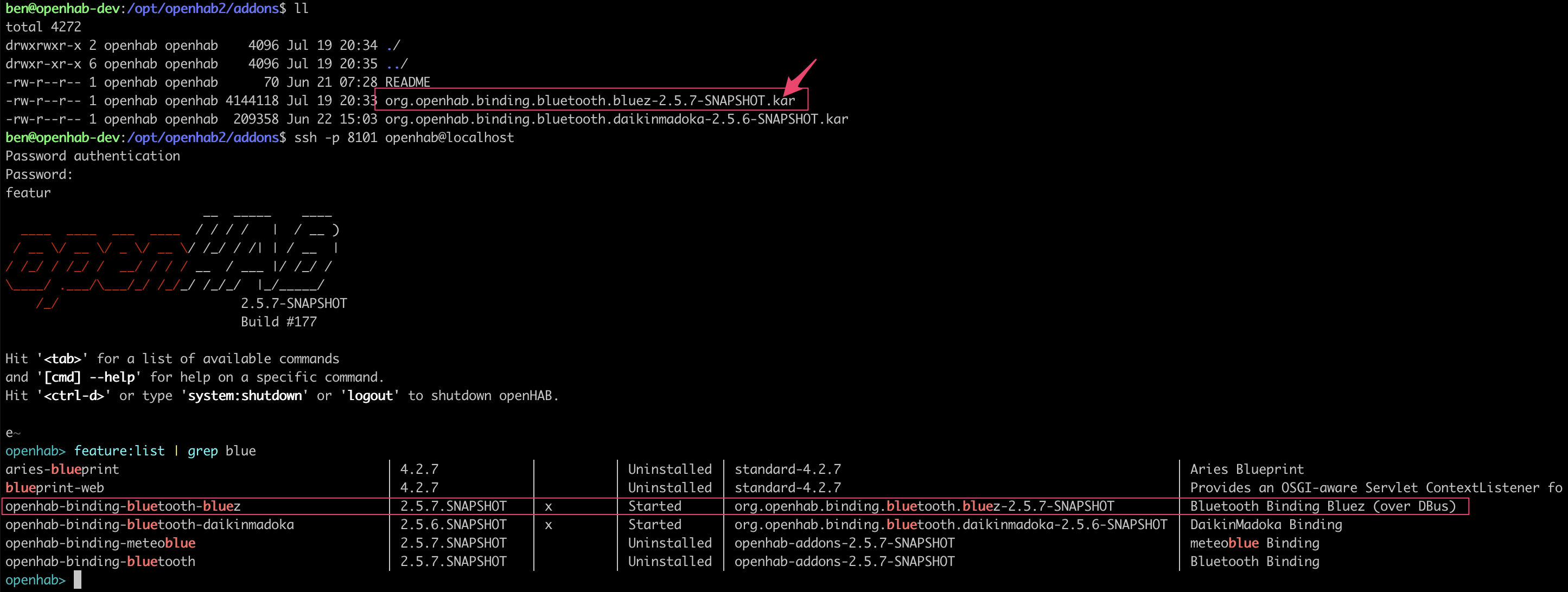

So, I use a custom BlueZ bridge that I coded as well, as the one shipping with OH does not really work. Here is the JAR attached, you can just put it in your “addons”: Unique Download Link | WeTransfer
I am in the process of PR to merge this binding and replace the existing one, but its not effective yet.
Don’t hesitate should you need any help!
Ben
Thanks, what exactly should I put? The downloaded file is KAR and not JAR.
KAR is the JAR packaging for Apache Karaf, the OSGI server powering OpenHAB. Just copy this file in the {OH}/addons folder.
Then, proceed with the configuration like in the doc: DaikinMadoka - Bindings | openHAB

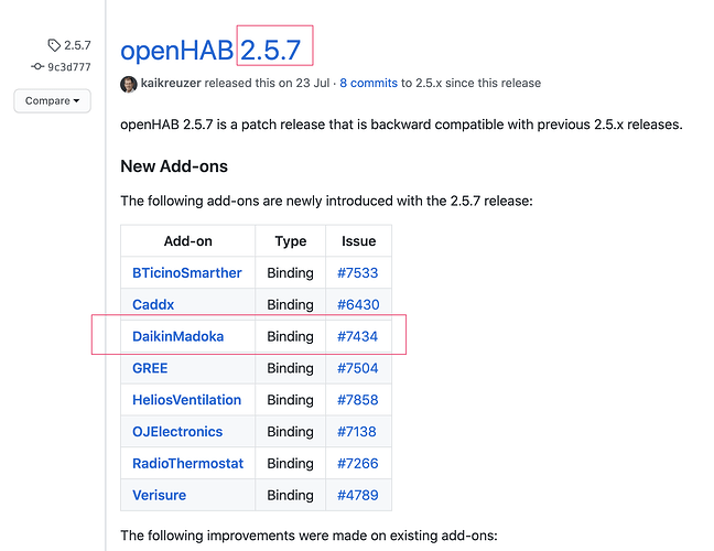

Ah ! I see ! Your OpenHAB version is too old. The Madoka binding was included with 2.5.7 release.
You can do an upgrade, ${OH}/runtime/bin/upgrade 2.5.7
Edit: well you can actually upgrade to 2.5.8 instead of 2.5.7 !

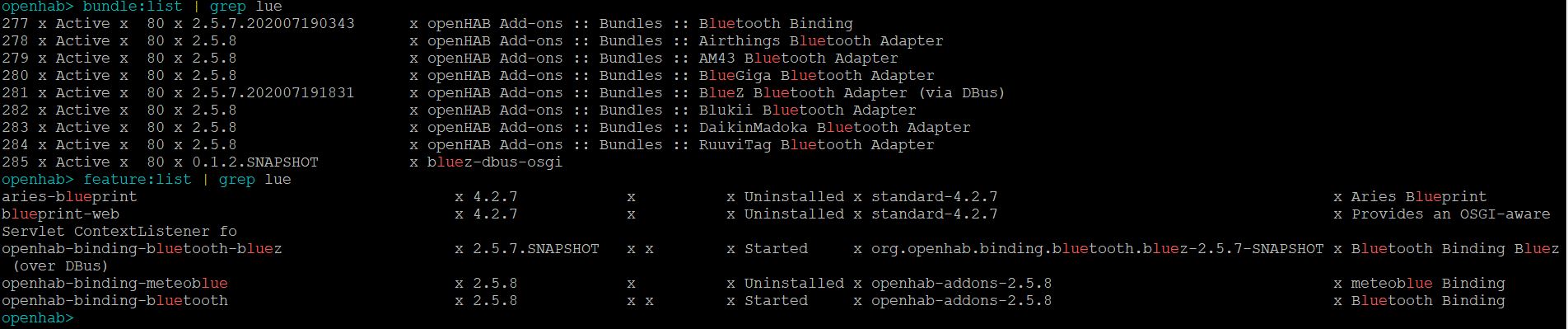

I upgraded the OM to 2.5.8 there is a progress, but still it doesn’t work :frowning:

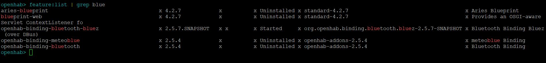

Now I see Madoka in the bundle list, but not in the feature list:
When I modified the addons file I got the following error:
[ERROR] [core.karaf.internal.FeatureInstaller] - Failed installing ‘openhab-binding-bluetooth-daikinmadoka’
binding=“zwave,astro,expire1,network,panasonictv1,darksky,sonyaudio,yamahareceiver,http1,weatherunderground,bluetooth,bluetooth-bluez,bluetooth-daikinmadoka”

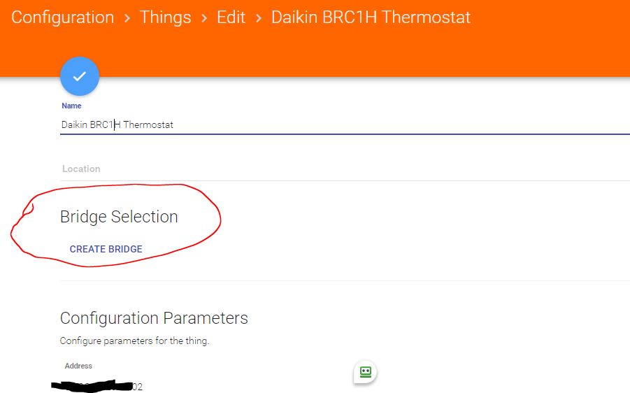

In the papar-ui, I can see the Thermostat Thing, but not the Bridge. When I edit the Thermostat Thing, I can see that the Bridge is not associated to it:
Bridge bluetooth:dbusbluez:hci0 [ address=“00:00:00:00:00:15” ]
Thing bluetooth:brc1h:hci0:Amit4 (bluetooth:dbusbluez:hci0) [ address=“00:00:00:00:00:02” ]
Any ideas (log files are empty)?

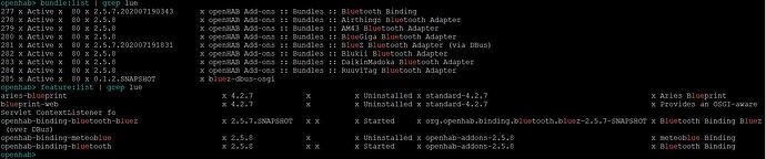

That’s wierd. I have installed a 2.5.9-SNAPSHOT, and the Madoka binding is not in the feature list either.
@Kai @cpmeister , any idea why the Binding which was integrated in 2.5.7 release is not anymore avail in 2.5.8/2.5.9-SNAPSHOT ?
Not really sure, I can’t find any reason that it would no longer be available looking at the code…
If you can see the daikinmadoka thingtype then it must have been installed/running in the OH, presence on the feature list is irrelevant if you can see it in the UI already.

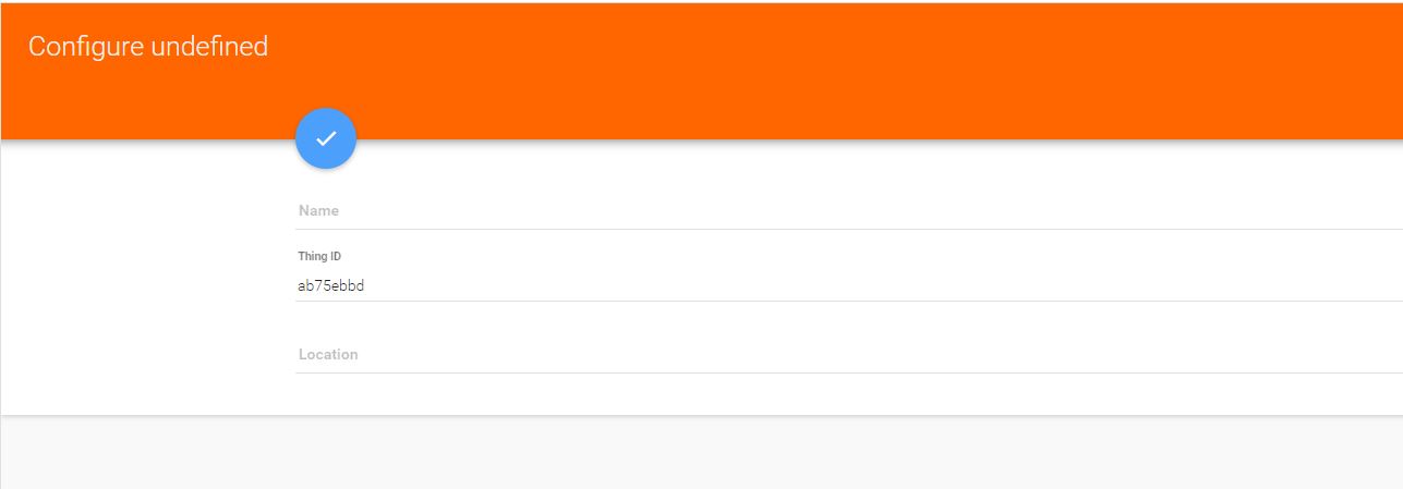

I am not sure if it related but when you try to create the Bridge in the paper-ui:
some of the fields are missing (hci0 and address) :
