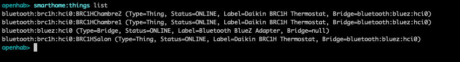

I seem to have all working (bridge online, etc) but the Thermostat things rhas this error:
UNINITIALIZED - HANDLER_INITIALIZING_ERROR Duplicate channels bluetooth:brc1h:hci0:salon:rssi

That’s correct @andresdrb.
I have made the correction, but not yet commit the PR. Will do tonight, and it will be for OH3 now.
Here is the PR done if you want to follow: [daikinmadoka] removed duplicate channel RSSI by blafois · Pull Request #8813 · openhab/openhab-addons · GitHub
Thanks! I´m sorry for the very basic question, but in order to get this change, so I just need to drop the https://ci.openhab.org/job/openHAB3-Distribution/lastSuccessfulBuild/artifact/distributions/openhab-addons/target/openhab-addons-3.0.0-SNAPSHOT.kar file into my addons folder?
Once the PR will get accepted, it will automatically get into the OH official repositories. No need to take the full addons KAR, just the madoka JAR. You can then get it from the CI/CD chain:
Check the “last build date” so that you know if its fixed or not!
