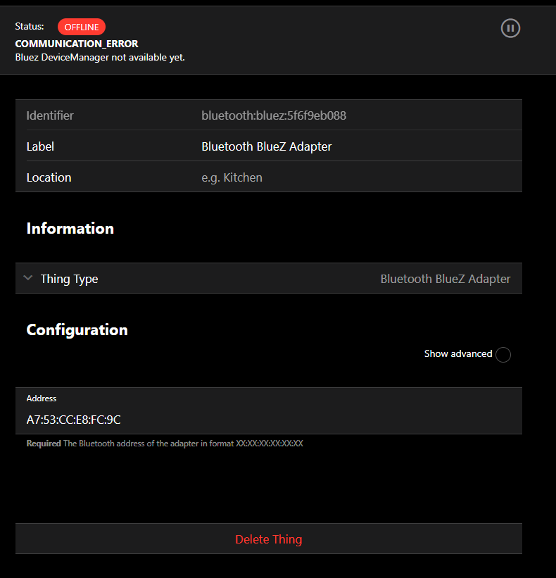

I put the laptop’s Bluetooth MAC and get a COMMUNICATION_ERROR for the BlueZ adapter,
is it a windows issue or am I doing something wrong?
Hi Tamir,
You mentioned “Windows Laptop”: it will not work, as it requires a Linux system. BlueZ is the Linux Bluetooth stack. Unless you manage to configure another Bluetooth adapter (such as TinyB or another one supported by OH), it will not work.
