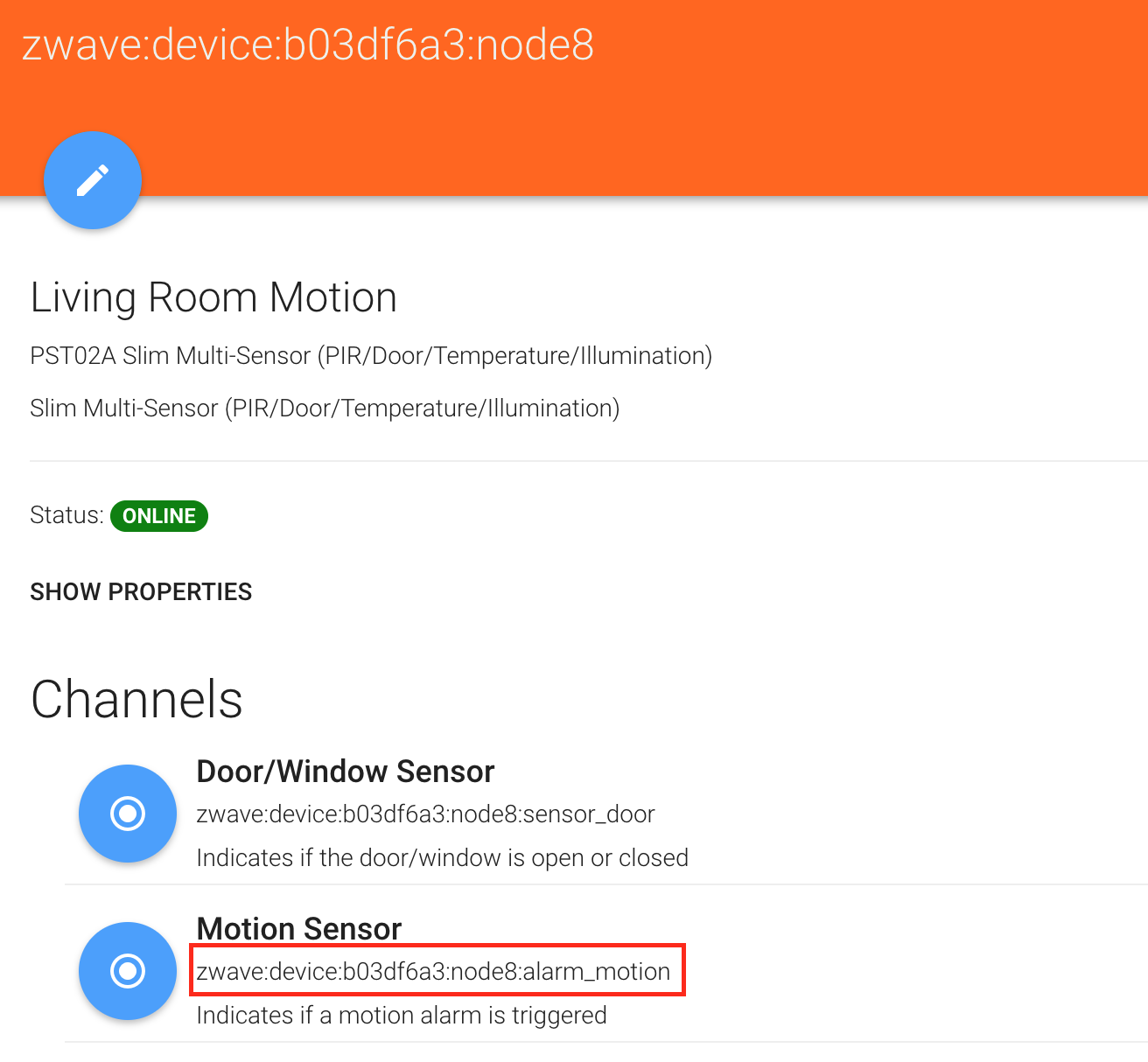

You can use channels:
Item look in PaperUI:
In the text file:
Switch  ZW_Lounge_Motion  "Motion [%s]"  <_motion>  (gPresence, LivingRoom)	 { channel = "zwave:device:b03df6a3:node8:alarm_motion" }
