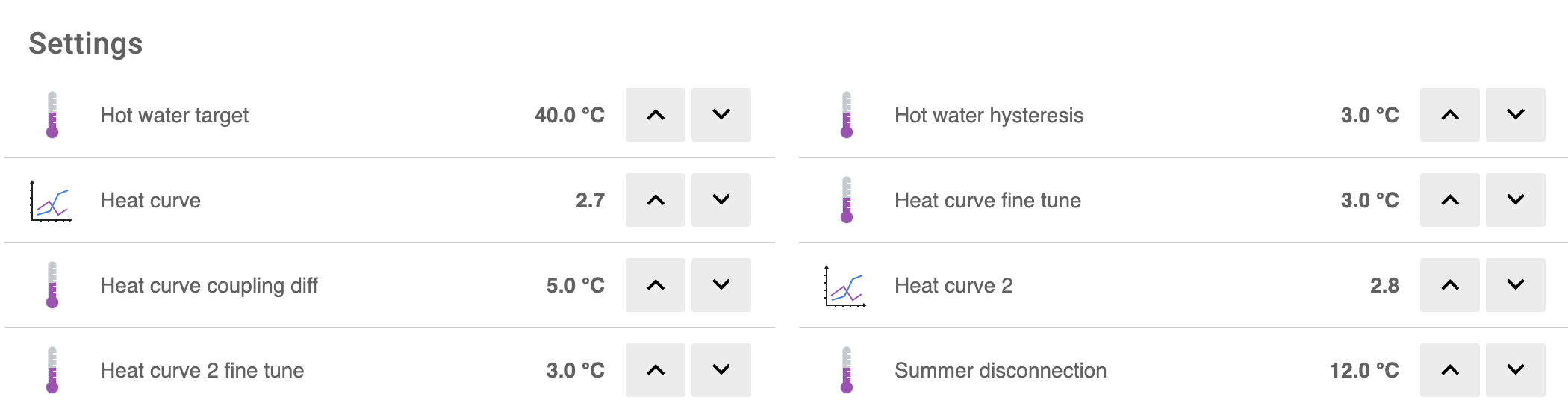

When testing, I used something like:
Setpoint item=regoheatpump_ipRego6xx_ivt_settings_summerDisconnection minValue=10 maxValue=30 step=0.1
within the .sitemap and was able to step between all values, supported by the HP.
Regarding the AdjustHeatCurveAtxxx - I added those based on the mappings available from here but never actually used/tested them - will try to check if they are mapped correctly, but again - it’s error and trial so feedback greatly appreciated :wink:
For the sake of completeness, I use something like below when testing:
Frame label="Settings" {
  Setpoint item=regoheatpump_ipRego6xx_ivt_settings_hotWaterTarget minValue=35 maxValue=54 step=0.1
  Setpoint item=regoheatpump_ipRego6xx_ivt_settings_hotWaterTargetHysteresis minValue=2 maxValue=15 step=0.1
  Setpoint item=regoheatpump_ipRego6xx_ivt_settings_heatCurve minValue=0 maxValue=10 step=0.1
  Setpoint item=regoheatpump_ipRego6xx_ivt_settings_heatCurveFineAdj minValue=-10 maxValue=10 step=0.1
  Setpoint item=regoheatpump_ipRego6xx_ivt_settings_heatCurve2 minValue=0 maxValue=10 step=0.1
  Setpoint item=regoheatpump_ipRego6xx_ivt_settings_heatCurve2FineAdj minValue=-10 maxValue=10 step=0.1
Frame label="Operating times" {
  Text item=regoheatpump_ipRego6xx_ivt_operatingTimes_heatPumpInOperationRAD
  Text item=regoheatpump_ipRego6xx_ivt_operatingTimes_heatPumpInOperationDHW
  Text item=regoheatpump_ipRego6xx_ivt_operatingTimes_addHeatInOperationRAD
  Text item=regoheatpump_ipRego6xx_ivt_operatingTimes_addHeatInOperationDHW

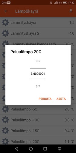

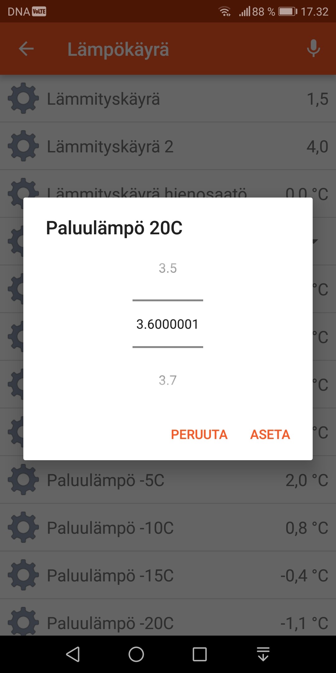

Just updated openHAB to latest snapshot and started testing with my Ivt greenline / Rego 600:
2019-01-15 22:42:44.360 [vent.ItemStateChangedEvent] - ivtAdjustHeatCurve20 changed from NULL to 2.5 °C
2019-01-15 22:42:44.580 [vent.ItemStateChangedEvent] - ivtAdjustHeatCurve15 changed from NULL to 2.3000000000000003 °C
That long row of zeros should not be there. Could this be a problem with UoM?
Here’s corresponding items:
Number:Temperature ivtAdjustHeatCurveMinus15 "Paluulämpö -15C" <settings> { channel="regoheatpump:ipRego6xx:greenline:settings#adjCurveAtMinus15" }
Number:Temperature ivtAdjustHeatCurveMinus20 "Paluulämpö -20C" <settings> { channel="regoheatpump:ipRego6xx:greenline:settings#adjCurveAtMinus20" }
BasicUI and HABDroid displays everything correctly with only one decimal.
Can’t debug it more right now but I’ll continue later. Please tell me what info you need.

I had to remove the “rego thing” from PaperUI and re-add it in order for new channels to take affect, but not sure if this was needed because I did replace the binding quite some times during development … maybe worth a try, but it should be under settings group, I use something like:
Not sure what you mean by “hot water target hysteresis is missing.”? I can read/set it’s value without problems …

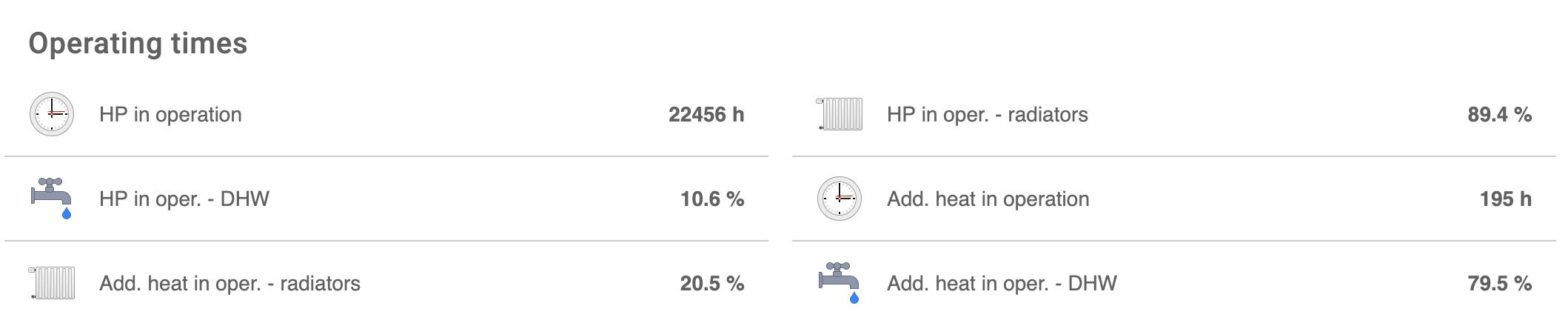

@asken11 - just FYI - in the latest version of the binding, this values (Running time” and “Running time with additional power”) are now available:
  • heatPumpInOperationRAD
  • heatPumpInOperationDHW
  • addHeatInOperationRAD
  • addHeatInOperationDHW

I don’t mind them in the logs but when I create a setpoint for an writable channel and view the sitemap with HABDroid they haunt me there also.
Sorry I wrote in a hurry. I mean the channel “hotWaterTargetHysteresis” is not visible in my system. I’ll try and re-add “rego thing” as you suggested above. Hopefully it’s caching problem.
Hm, I see something like:
How do you define those items that gives you problems?
Number:Temperature ivtAdjustHeatCurve20 "Paluulämpö 20C" <settings> { channel="regoheatpump:ipRego6xx:greenline:settings#adjCurveAt20" }
Setpoint item=ivtAdjustHeatCurve20 minValue=0 maxValue=4 step=0.1
As in your screenshot when viewed with browser everything works just fine. Try with the android app.
