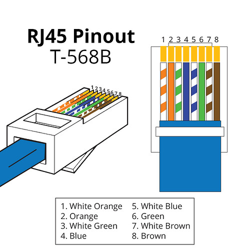

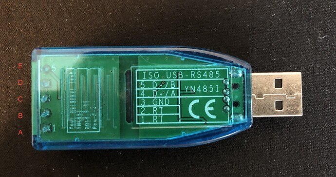

I have now received the RS485 to USB dongle, and now I need some advice to wire the pins.
Please see the following diagrams with network cat pins marked from 1 to 8, and pins on USB dongle from A to E.
As I read from the posts, I should connect pin 3 to E and pin 6 to D, and I also need a short wire to connect pin A and B to enable 120ohms termination resistor, please correct me if I’m not doing the right thing.
Now the question about GND, both pin 1 and 2 from the RJ45 are marked GND, which one should I use?
Thank you in advance!
Hi @somy,
Your understanding is correct:
RJ45 pin 3 goes to RS485 pin 5
RJ45 pin 6 goes to RS485 pin 4
RJ45 pins 1/2 can be shorted together into RS485 pin 3

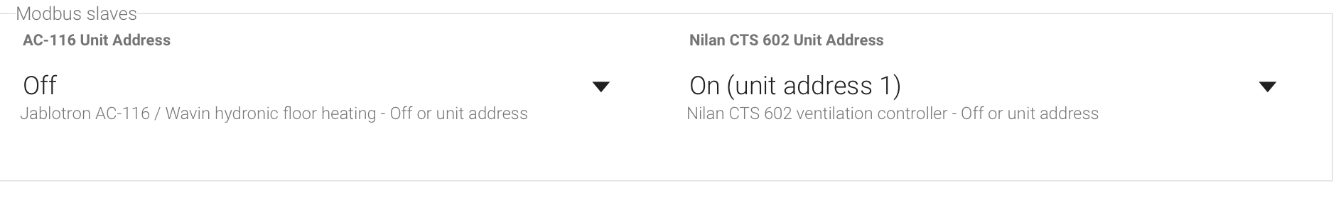

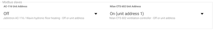

Thanks a lot! Now I have made some progress: I seem to get connection to the device in Docker now. After I installed the binding I noticed the following:
- By default it sets Nilan On and Wavin off (see screenshot below).
- I then change Nilan off and Wavin On (Unit address 1), and it can find a thing called “slave1” but never managed to connect to that. The controller is in a strange state “Online_bridge_offline”
- Did some more experiment by trying different values, I found if I set Wavin On (Unit address 2) it seems to be able to connect to the device, a thing called “slave2” is created
- I didn’t manage to get states of connected thermostats - as I understand from previous posts they should appear as things automatically?

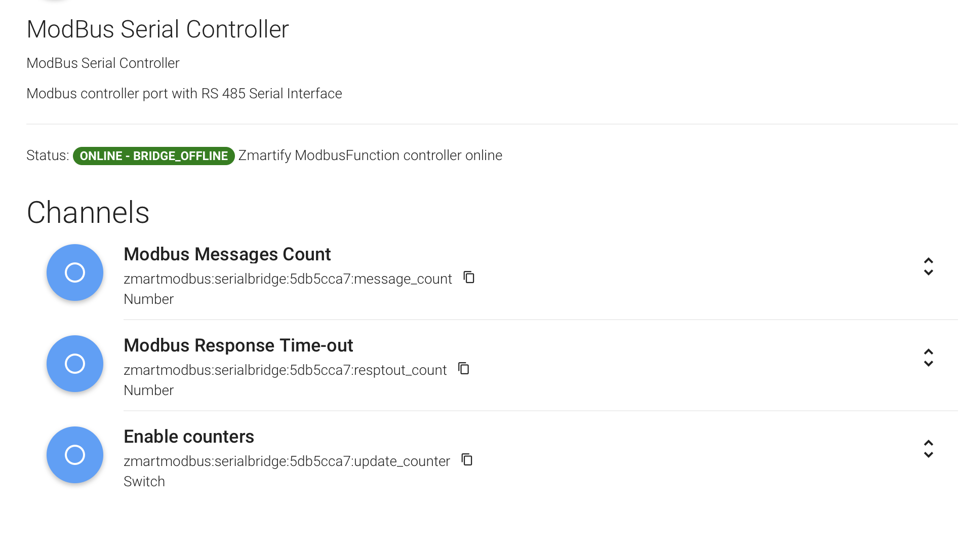

That’s what I’ve got so far. I tried to look into log and can see the it keeps disconnected from the device:
2019-06-19 20:12:43.307 [WARN ] [rtmodbus.handler.ModbusSerialHandler] - Recv timeout : 403 minimumLength=5 respIndex=0
2019-06-19 20:12:43.915 [WARN ] [rtmodbus.handler.ModbusSerialHandler] - Recv timeout : 405 minimumLength=5 respIndex=0
2019-06-19 20:12:44.523 [WARN ] [rtmodbus.handler.ModbusSerialHandler] - Recv timeout : 405 minimumLength=5 respIndex=0
2019-06-19 20:12:45.131 [WARN ] [rtmodbus.handler.ModbusSerialHandler] - Recv timeout : 403 minimumLength=5 respIndex=0
2019-06-19 20:12:45.739 [WARN ] [rtmodbus.handler.ModbusSerialHandler] - Recv timeout : 406 minimumLength=5 respIndex=0
2019-06-19 20:12:46.347 [WARN ] [rtmodbus.handler.ModbusSerialHandler] - Recv timeout : 405 minimumLength=5 respIndex=0
2019-06-19 20:12:46.956 [WARN ] [rtmodbus.handler.ModbusSerialHandler] - Recv timeout : 406 minimumLength=5 respIndex=0
2019-06-19 20:12:47.321 [INFO ] [rtmodbus.handler.ModbusSerialHandler] - Trying to connect to serial port /dev/ttyUSB0
2019-06-19 20:12:47.563 [WARN ] [rtmodbus.handler.ModbusSerialHandler] - Recv timeout : 403 minimumLength=5 respIndex=0
2019-06-19 20:12:48.170 [WARN ] [rtmodbus.handler.ModbusSerialHandler] - Recv timeout : 404 minimumLength=5 respIndex=0
2019-06-19 20:12:48.776 [WARN ] [rtmodbus.handler.ModbusSerialHandler] - Recv timeout : 403 minimumLength=5 respIndex=0
2019-06-19 20:12:49.322 [INFO ] [rtmodbus.handler.ModbusSerialHandler] - Connected to serial port /dev/ttyUSB0
2019-06-19 20:12:49.323 [INFO ] [rtmodbus.handler.ModbusSerialHandler] - Trying to connect to serial port /dev/ttyUSB0
2019-06-19 20:12:49.382 [WARN ] [rtmodbus.handler.ModbusSerialHandler] - Recv timeout : 403 minimumLength=5 respIndex=0
2019-06-19 20:12:49.988 [WARN ] [rtmodbus.handler.ModbusSerialHandler] - Recv timeout : 403 minimumLength=5 respIndex=0
2019-06-19 20:12:51.324 [INFO ] [rtmodbus.handler.ModbusSerialHandler] - Connected to serial port /dev/ttyUSB0
2019-06-19 20:12:51.325 [INFO ] [rtmodbus.handler.ModbusSerialHandler] - Trying to connect to serial port /dev/ttyUSB0
2019-06-19 20:12:53.326 [INFO ] [rtmodbus.handler.ModbusSerialHandler] - Connected to serial port /dev/ttyUSB0
2019-06-19 20:12:53.326 [INFO ] [rtmodbus.handler.ModbusSerialHandler] - Trying to connect to serial port /dev/ttyUSB0
2019-06-19 20:12:55.328 [INFO ] [rtmodbus.handler.ModbusSerialHandler] - Connected to serial port /dev/ttyUSB0
2019-06-19 20:12:55.592 [WARN ] [rtmodbus.handler.ModbusSerialHandler] - Recv timeout : 401 minimumLength=5 respIndex=0
2019-06-19 20:12:56.201 [WARN ] [rtmodbus.handler.ModbusSerialHandler] - Recv timeout : 405 minimumLength=5 respIndex=0
2019-06-19 20:12:56.807 [WARN ] [rtmodbus.handler.ModbusSerialHandler] - Recv timeout : 403 minimumLength=5 respIndex=0
2019-06-19 20:12:57.415 [WARN ] [rtmodbus.handler.ModbusSerialHandler] - Recv timeout : 405 minimumLength=5 respIndex=0
2019-06-19 20:13:00.331 [INFO ] [rtmodbus.handler.ModbusSerialHandler] - Trying to connect to serial port /dev/ttyUSB0
2019-06-19 20:13:02.333 [INFO ] [rtmodbus.handler.ModbusSerialHandler] - Connected to serial port /dev/ttyUSB0
2019-06-19 20:13:02.353 [INFO ] [rtmodbus.handler.ModbusSerialHandler] - Trying to connect to serial port /dev/ttyUSB0
2019-06-19 20:13:03.022 [WARN ] [rtmodbus.handler.ModbusSerialHandler] - Recv timeout : 403 minimumLength=5 respIndex=0
2019-06-19 20:13:03.627 [WARN ] [rtmodbus.handler.ModbusSerialHandler] - Recv timeout : 402 minimumLength=5 respIndex=0
2019-06-19 20:13:04.233 [WARN ] [rtmodbus.handler.ModbusSerialHandler] - Recv timeout : 403 minimumLength=5 respIndex=0
2019-06-19 20:13:04.355 [INFO ] [rtmodbus.handler.ModbusSerialHandler] - Connected to serial port /dev/ttyUSB0
2019-06-19 20:13:04.356 [INFO ] [rtmodbus.handler.ModbusSerialHandler] - Trying to connect to serial port /dev/ttyUSB0
2019-06-19 20:13:04.840 [WARN ] [rtmodbus.handler.ModbusSerialHandler] - Recv timeout : 404 minimumLength=5 respIndex=0
2019-06-19 20:13:06.357 [INFO ] [rtmodbus.handler.ModbusSerialHandler] - Connected to serial port /dev/ttyUSB0
2019-06-19 20:13:06.358 [INFO ] [rtmodbus.handler.ModbusSerialHandler] - Trying to connect to serial port /dev/ttyUSB0
2019-06-19 20:13:08.358 [INFO ] [rtmodbus.handler.ModbusSerialHandler] - Connected to serial port /dev/ttyUSB0
2019-06-19 20:13:10.448 [WARN ] [rtmodbus.handler.ModbusSerialHandler] - Recv timeout : 405 minimumLength=5 respIndex=0
2019-06-19 20:13:11.055 [WARN ] [rtmodbus.handler.ModbusSerialHandler] - Recv timeout : 403 minimumLength=5 respIndex=0
2019-06-19 20:13:11.661 [WARN ] [rtmodbus.handler.ModbusSerialHandler] - Recv timeout : 403 minimumLength=5 respIndex=0
2019-06-19 20:13:12.269 [WARN ] [rtmodbus.handler.ModbusSerialHandler] - Recv timeout : 404 minimumLength=5 respIndex=0
2019-06-19 20:13:13.360 [INFO ] [rtmodbus.handler.ModbusSerialHandler] - Trying to connect to serial port /dev/ttyUSB0
2019-06-19 20:13:15.361 [INFO ] [rtmodbus.handler.ModbusSerialHandler] - Connected to serial port /dev/ttyUSB0
2019-06-19 20:13:15.362 [INFO ] [rtmodbus.handler.ModbusSerialHandler] - Trying to connect to serial port /dev/ttyUSB0
2019-06-19 20:13:17.363 [INFO ] [rtmodbus.handler.ModbusSerialHandler] - Connected to serial port /dev/ttyUSB0
2019-06-19 20:13:17.364 [INFO ] [rtmodbus.handler.ModbusSerialHandler] - Trying to connect to serial port /dev/ttyUSB0
2019-06-19 20:13:17.875 [WARN ] [rtmodbus.handler.ModbusSerialHandler] - Recv timeout : 403 minimumLength=5 respIndex=0
2019-06-19 20:13:18.536 [WARN ] [rtmodbus.handler.ModbusSerialHandler] - Recv timeout : 401 minimumLength=5 respIndex=0
2019-06-19 20:13:19.142 [WARN ] [rtmodbus.handler.ModbusSerialHandler] - Recv timeout : 402 minimumLength=5 respIndex=0
2019-06-19 20:13:19.365 [INFO ] [rtmodbus.handler.ModbusSerialHandler] - Connected to serial port /dev/ttyUSB0
2019-06-19 20:13:19.366 [INFO ] [rtmodbus.handler.ModbusSerialHandler] - Trying to connect to serial port /dev/ttyUSB0
2019-06-19 20:13:19.748 [WARN ] [rtmodbus.handler.ModbusSerialHandler] - Recv timeout : 404 minimumLength=5 respIndex=0
2019-06-19 20:13:21.367 [INFO ] [rtmodbus.handler.ModbusSerialHandler] - Connected to serial port /dev/ttyUSB0
2019-06-19 20:13:25.357 [WARN ] [rtmodbus.handler.ModbusSerialHandler] - Recv timeout : 406 minimumLength=5 respIndex=0
2019-06-19 20:13:25.964 [WARN ] [rtmodbus.handler.ModbusSerialHandler] - Recv timeout : 404 minimumLength=5 respIndex=0
2019-06-19 20:13:26.369 [INFO ] [rtmodbus.handler.ModbusSerialHandler] - Trying to connect to serial port /dev/ttyUSB0
2019-06-19 20:13:26.569 [WARN ] [rtmodbus.handler.ModbusSerialHandler] - Recv timeout : 402 minimumLength=5 respIndex=0
2019-06-19 20:13:27.175 [WARN ] [rtmodbus.handler.ModbusSerialHandler] - Recv timeout : 403 minimumLength=5 respIndex=0
2019-06-19 20:13:28.370 [INFO ] [rtmodbus.handler.ModbusSerialHandler] - Connected to serial port /dev/ttyUSB0
2019-06-19 20:13:28.371 [INFO ] [rtmodbus.handler.ModbusSerialHandler] - Trying to connect to serial port /dev/ttyUSB0
2019-06-19 20:13:30.372 [INFO ] [rtmodbus.handler.ModbusSerialHandler] - Connected to serial port /dev/ttyUSB0
2019-06-19 20:13:30.373 [INFO ] [rtmodbus.handler.ModbusSerialHandler] - Trying to connect to serial port /dev/ttyUSB0
2019-06-19 20:13:32.375 [INFO ] [rtmodbus.handler.ModbusSerialHandler] - Connected to serial port /dev/ttyUSB0
2019-06-19 20:13:32.377 [INFO ] [rtmodbus.handler.ModbusSerialHandler] - Trying to connect to serial port /dev/ttyUSB0
2019-06-19 20:13:32.779 [WARN ] [rtmodbus.handler.ModbusSerialHandler] - Recv timeout : 401 minimumLength=5 respIndex=0
2019-06-19 20:13:33.386 [WARN ] [rtmodbus.handler.ModbusSerialHandler] - Recv timeout : 403 minimumLength=5 respIndex=0
2019-06-19 20:13:34.003 [WARN ] [rtmodbus.handler.ModbusSerialHandler] - Recv timeout : 405 minimumLength=5 respIndex=0
2019-06-19 20:13:34.379 [INFO ] [rtmodbus.handler.ModbusSerialHandler] - Connected to serial port /dev/ttyUSB0
2019-06-19 20:13:34.379 [INFO ] [rtmodbus.handler.ModbusSerialHandler] - Trying to connect to serial port /dev/ttyUSB0
2019-06-19 20:13:34.610 [WARN ] [rtmodbus.handler.ModbusSerialHandler] - Recv timeout : 404 minimumLength=5 respIndex=0
2019-06-19 20:13:36.382 [INFO ] [rtmodbus.handler.ModbusSerialHandler] - Connected to serial port /dev/ttyUSB0
2019-06-19 20:13:36.383 [INFO ] [rtmodbus.handler.ModbusSerialHandler] - Trying to connect to serial port /dev/ttyUSB0
2019-06-19 20:13:38.384 [INFO ] [rtmodbus.handler.ModbusSerialHandler] - Connected to serial port /dev/ttyUSB0
2019-06-19 20:13:38.385 [INFO ] [rtmodbus.handler.ModbusSerialHandler] - Trying to connect to serial port /dev/ttyUSB0
2019-06-19 20:13:40.214 [WARN ] [rtmodbus.handler.ModbusSerialHandler] - Recv timeout : 401 minimumLength=5 respIndex=0
2019-06-19 20:13:40.386 [INFO ] [rtmodbus.handler.ModbusSerialHandler] - Connected to serial port /dev/ttyUSB0
2019-06-19 20:13:40.388 [INFO ] [rtmodbus.handler.ModbusSerialHandler] - Trying to connect to serial port /dev/ttyUSB0
2019-06-19 20:13:40.822 [WARN ] [rtmodbus.handler.ModbusSerialHandler] - Recv timeout : 404 minimumLength=5 respIndex=0
2019-06-19 20:13:41.427 [WARN ] [rtmodbus.handler.ModbusSerialHandler] - Recv timeout : 402 minimumLength=5 respIndex=0
2019-06-19 20:13:42.033 [WARN ] [rtmodbus.handler.ModbusSerialHandler] - Recv timeout : 403 minimumLength=5 respIndex=0
2019-06-19 20:13:42.390 [INFO ] [rtmodbus.handler.ModbusSerialHandler] - Connected to serial port /dev/ttyUSB0
Could it be because I only wire the pin 0 (instead of pin 0+1) to GND? And I don’t quite understand why I can connect to slave2 but not slave1, and why it doesn’t detect the thermostats in the rooms ![]()
Any suggestion?
Hi @somy,
The binding defaults to Nilan for all - @spiff42 I think discussed this a bit earlier in the thread but basically just switch over to wavin as you have done and it should work. The slave 1 or 2 is I think a bit dependent on the config of the wavin but most cases it would be 1. From the log I don’t think you are connected in a stable mode - I see a lot of re-connects.

Hi, I now switch to another rj45 port and looked a little further into it.
@katerica, I think you’re right, once the controller is configured slave1/slave2 will show online even though it’s not connected.
When I configure Wavin On with address 1, the modbus controller state is online_bridge-offline, and I see a lot of reconnects in the log file:

Screenshot of the modbus controller:
Edit: Looks like now slave1 can also obtain a connection - I didn’t do anything except for restart the docker container a few times, strange.

Hi @spiff42,
We have the same RS485 adapter, when you say connect pin 4 and 5, I assume you meant pin 1 and 2? I have done so.
Can you confirm how to wire GND? Should I wire both pin 1 and 2 from rj45 cable or one of the pins is good enough? This is the only thing I’m doing differently from @katerica.

Yes, looking at your picture, the pins are 1 and 2. I will edit my post, so others don’t misunderstand.
I can understand why you put the red labels A-E on the picture, to make it more explicit, but it can get a little confusing because because the RS485 signals on pins 4 and 5 are also called A and B. Since I had not originally noticed your red labels on the picture, I thought you suggested short-circuiting those ![]()
My best guess is that they are both connected at the AHC9000 end. Probably on the display one is used for RS485 signal ground and the other one is used for the 24V supply. However, in this case (where we are not using the 24V supply), connecting both orange and orange/white wires to GND terminal 3 on the RS485 adapter seems the easiest (and I think that is what I have done).
Remember to check that your RJ45 connector uses T-568B coloring scheme, and not T-568A, otherwise the orange and green pairs are swapped. But I guess in that case you would not get any connection at all.
